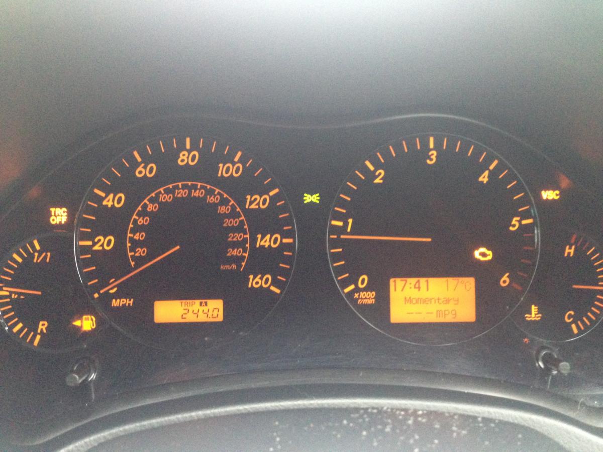

Hi Guys,
A while back I had an issue with my car - I was driving along and I suddenly lost power - the engine management light came on, the TRC OFF light came on and the VSC came on. I managed to limp it to the garage and they checked and told me the EGR valve was "coked up". They cleaned it and replaced it in the car - reset the computer and all was ok.
That was last february - around 11,500 miles ago - I'm now due my next service (plus discs/pads, air con service and a couple of rubber bushes need replacing on the steering) but tonight I noticed the lights were all on again - however the car is not in limp mode, its fine except the lights being on.... Could it be that the EGR was coked up again or is this a sign of something else?

Hi Drew,
I've never heard of a CV having to be cut off, but that doesn't mean it would never need to be done. There is a lot to be said for replacing the whole shaft, especially if you are paying someone else the labour to swap out the CV joint. 5 hours is unreasonable for that job though,if they are professionally qualified technicians.
Really the only way to tell what's triggering the lights is to do a scan, you can get hold of a reasonably priced scanner albeit specific to the vehicle type from Amazon, Fleabay or similar. If you have an Android phone, the Torque Pro app with a suitable bluetooth ELM327 adaptor available for about £10 will read the engine codes only. I found the EGR on the later Toyota diesel is prone to coking and needs to be cleaned regularly. I do mine about every 5k but that's probably overkill, every time it's serviced I'd expect it to be needed though.
I looked into blanking plates, and yes they are available for about £3, but you also need some electrickery to fool the ECU or it will go into limp home. The trickery is also available but is more expensive. The valves themselves seem to be very reliable on the 1AD/2AD engines so for me the best solution was just to keep it clean.

Thanks for that - I'm waiting for this to arrive however yesterday all the warning lights have disappeared - so possibly the EGR wasn't fully blocked and its now cleaned itself or it is an intermittent fault. Once the reader arrives I'll check it :)
