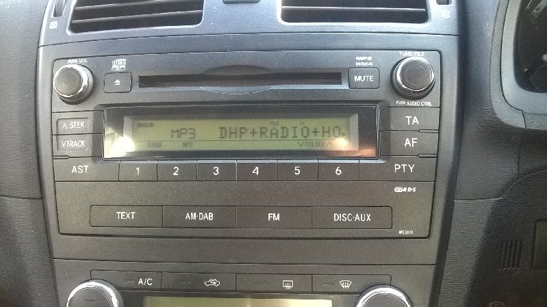

Might be a help if you say which audio unit you have.
Not much info available, have posted it in original description.
photo of the unit may also help, even trim level of your car may narrow it down.

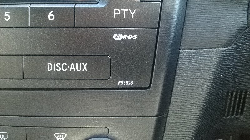

Derek, it would be more helpful if you could add photos and model details, to help description.
post-76861-0-75000900-1441782581_thumb.jpost-76861-0-85531300-1441782561_thumb.j
This is the model (W53828) fitted to my '09 Tourer - model number by the DISC-AUX button . I am using Samsung Galaxy S3 and Nokia Lumia 625.
You did the correct thing by trying other phones, so it is not the radio/cd player.
