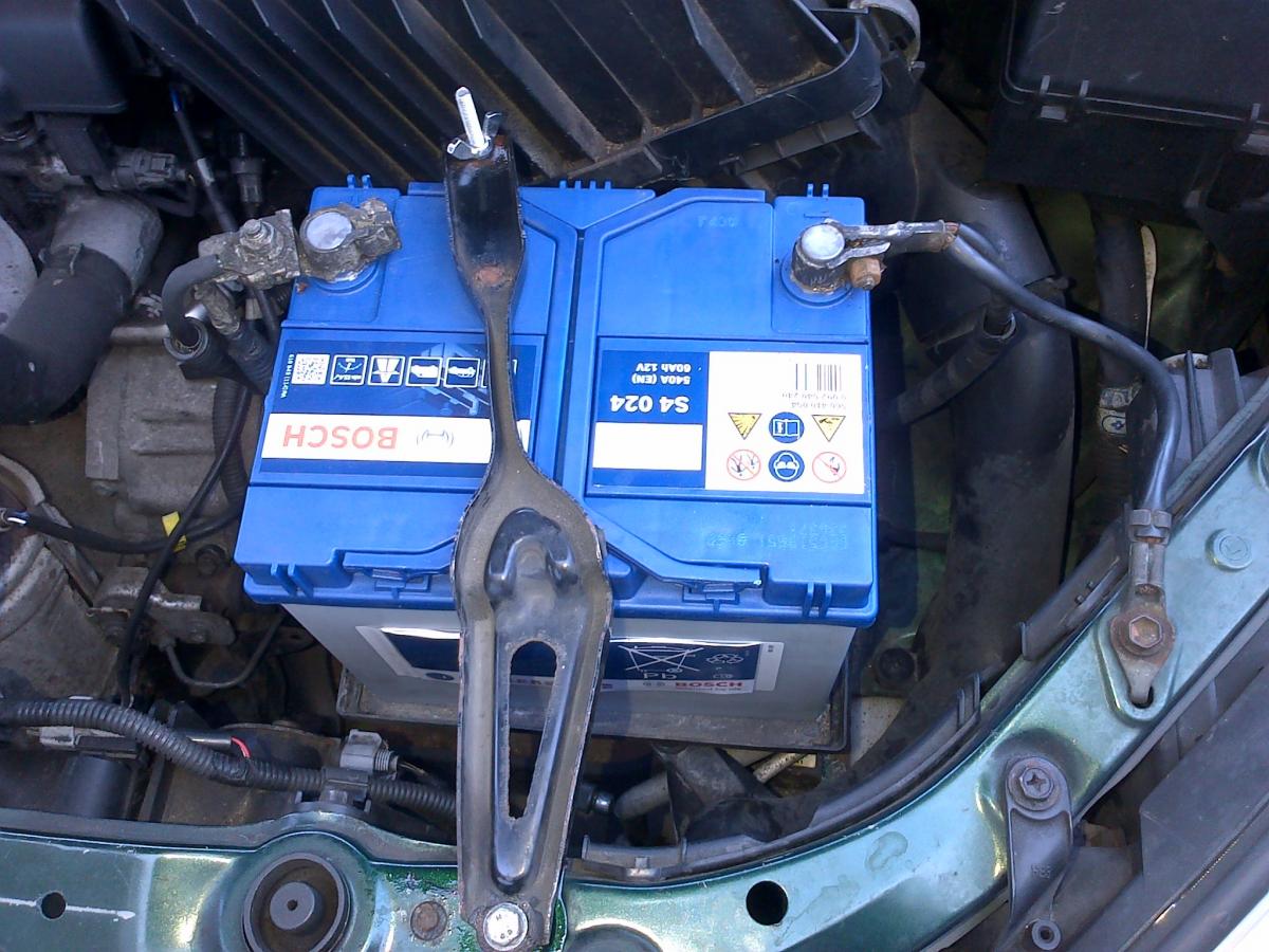

Got a new Battery...I started to remove the old Battery...disconnected the terminals. Then when I tried to undo the nut on the Battery retaining rod (circled below), the nut sheared off!!! Now the rod is too short and it's useless for securing the battery.
Any suggestions on how to secure/hold the new battery in place?
Hi, just go to a Toyota dealer and order a new rod and nut from the spares/parts dep't.

Very sensible idea. Will do. Thanks
In the end I bought a universal fitting rod from a local shop. Had to cut and bend it to size. Yes, I need to put that bracket more towards the middle.
Thanks for your help and advice.
In the meantime make sure it CAN'T touch the poz terminal or it will short the Battery and could cause a fire.

Thanks for pointing this out. That's exactly why sharing opinions on here is important.

This has happened to me a few times :( So I have started to put anti seize compound around threads.
Toyota seemed to have them in stock and where only a couple of quid.
