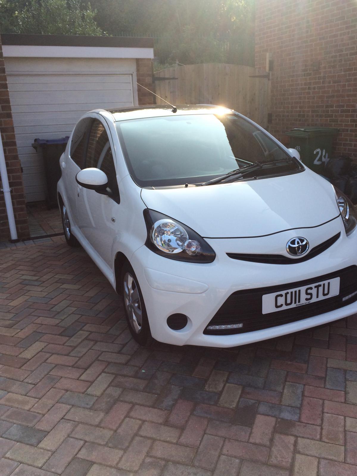

2 weeks ago I bought a 2014 4 door Aygo Move with Style, it is white with a black roof, has built in tom tom, Aircon, alloys, tinted windows,DRL's free road tax & 972 miles on the clock. The salesman informed me it was referred to as the final edition before the new shape came out in 2014.
so far I am really happy with the car, and I like the extra bits it has over my old Aygo, it feels a lot newer than the 2009 car, it even has a nicer gear knob :)
