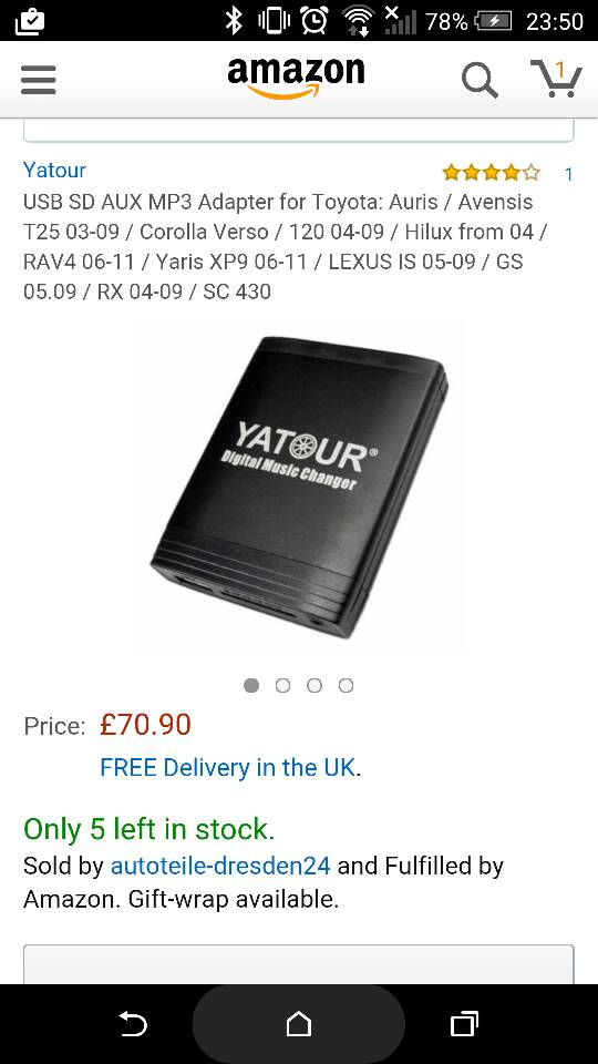

Don't get parrot I bought this system off of Amazon it's better than parrot can be completely stealth and takes about 5 mins to fit
USB SD AUX MP3 Adapter for Toyota: Auris / Avensis T25 03-09 / Corolla Verso / 120 04-09 / Hilux from 04 / RAV4 06-11 / Yaris XP9 06-11 / LEXUS IS 05-09 / GS 05.09 / RX 04-09 / SC 43
This is the item on Amazon has bluetooth, has aux, has USB, has memory card I get what connections I wanted into the top glove box as already a cut out for iPod connection it's really easy to fit

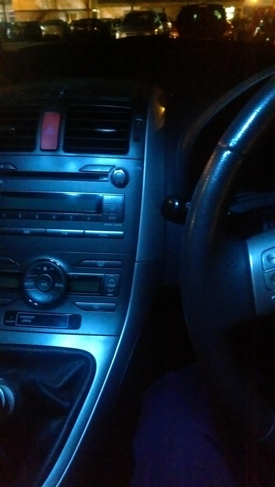

the first pic shows where my microphone is
post-130759-0-83727400-1444850695_thumb.

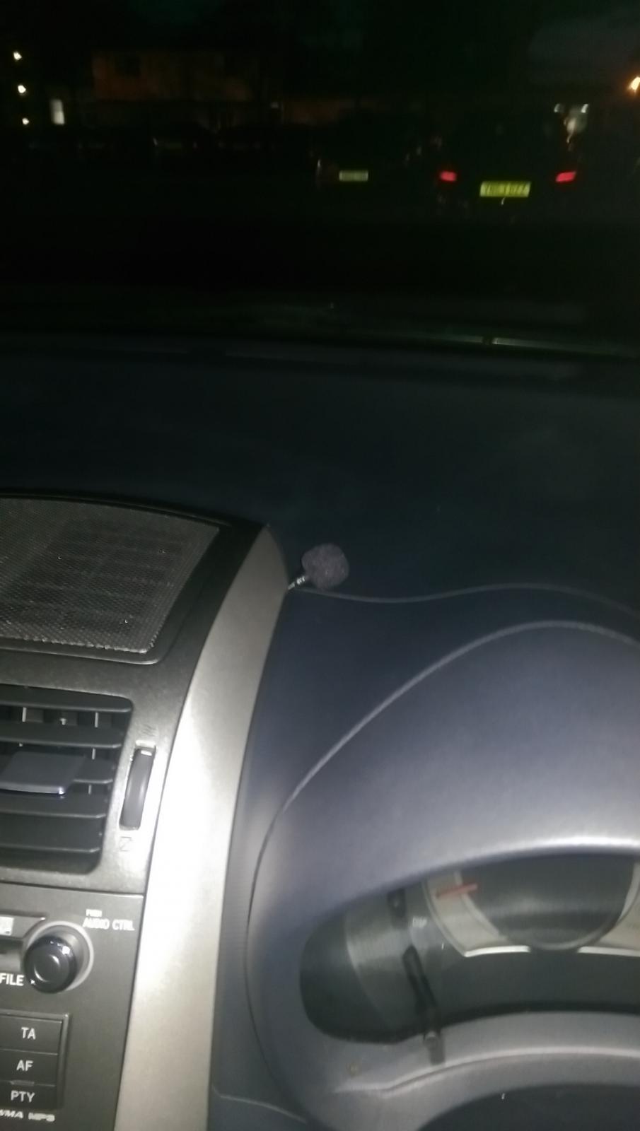

the second photo shows where im considering moving it too
post-130759-0-24781200-1444850723_thumb.
