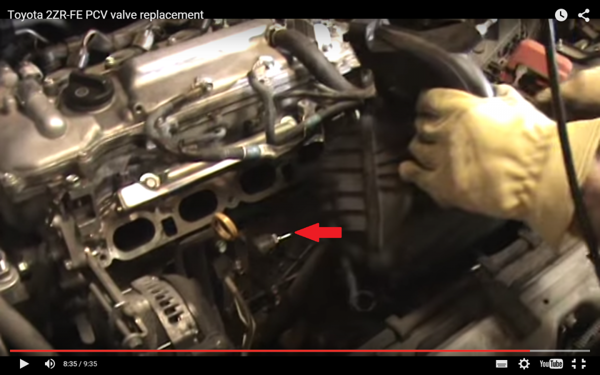

Anybody notice that, in the second video at 8.35, the guy forgot to reconnect the hose before he replaced the inlet manifold?

Well, I ordered what I though were the right clips from Toyota by using the link to the official Toyota parts site (parts 90467-23002 and 90467-15120 for the ventilation hose. Turns out the hose and clips I'm trying to replace aren't the ventilation hose as the slips are totally different (wire as opposed to spring band clamps). Unfortunately, the parts diagrams don't work for all the other images for the part that this hose connects to.
So, the question's out there again - what is the hose for and, will it cause any problems if I pull it off to replace the clamps?
I've taken a picture, but haven't a clue how to load it onto here - the best thing I can say is that the hose and clamps I'm talking about are the ones that the guy's finger in the yellow glove is pointing straight to in the image for the second YouTube video in Konrad C's post, above.
the guy in the video tells you, it's the coolant hose for fhe throttle body along with the other one to the r ight of it. If you disconnect these hoses then coolant will run out
Cheers - in that case, I'll be leaving well alone! I'll probably have the clips changes in about 2 years when the coolant change will be due when it's serviced.
