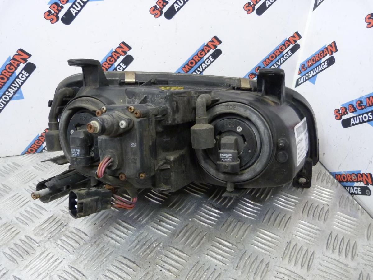

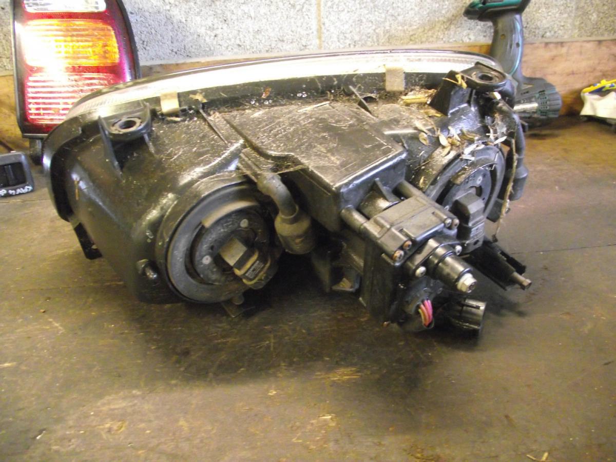

I know the type of fitting you mean and usually you squeeze the two prongs together to unclip the plug.
Does your headlight look like either of these?

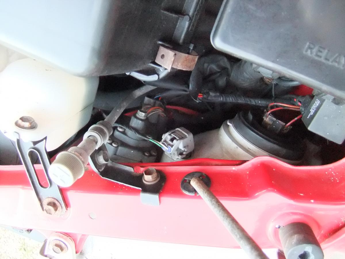

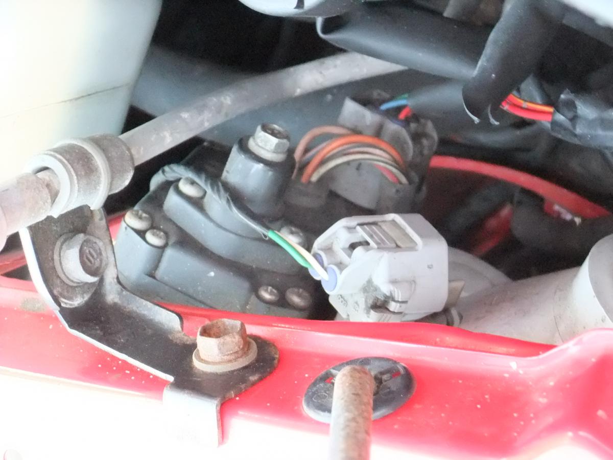

Hi Tom,
My Headlight unit doesn"t really match either of those. I have attached a photo taken from above and the Parking light is the Grey plug next to the Mainbeam plug.

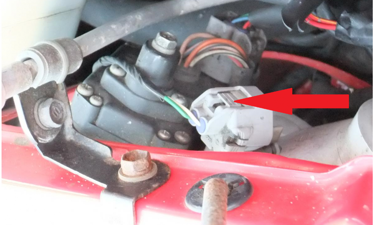

Looks to me like the type of plug where you push in the plastic tab (marked by red arrow) and disconnect the plug. You probably don't have much room there and you must make sure the tab is held in while you disconnect. Re-assembly is much easier but then again it usually is!

Hi again,
Thanks for all the advice but in the end I had to remove the Front Headlight unit and then it was simply a matter of pressing together the 2 plastic prongs at the bottom of the Parking light plug as I turned it anticlockwise and hey presto it was done.
