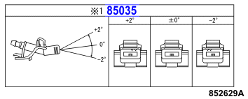

There is no adjustment on the fan spray type washers jets, the spray height is set at the factory by choosing a jet from a set with varying angles from -2, -1 to +1, +2 starting with a 0 type and using a - to drop the height and + to raise the height. To identify which jets you have see picture attached.
Also worth a check is the 3 way non return valve under the bonnet if this partially blocks it can affect the spray pattern on the washer jets, to check swap the jets side to side if the issue remains on the RHS its the valve
