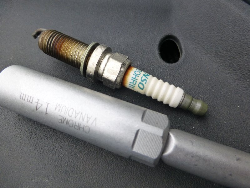

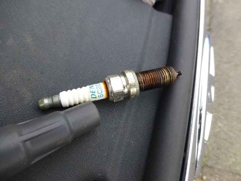

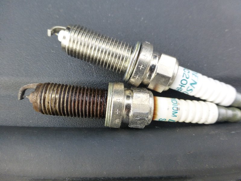

Update. I checked the spark plugs and they look original. Here are pictures of two I checked:
post-76861-0-69597500-1447079641_thumb.jpost-76861-0-02338700-1447079658_thumb.j
As you can see they are well used.

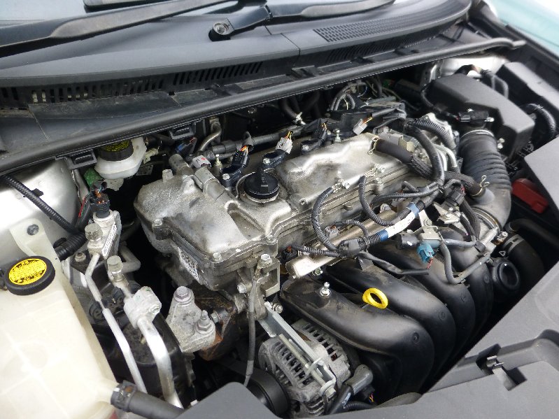

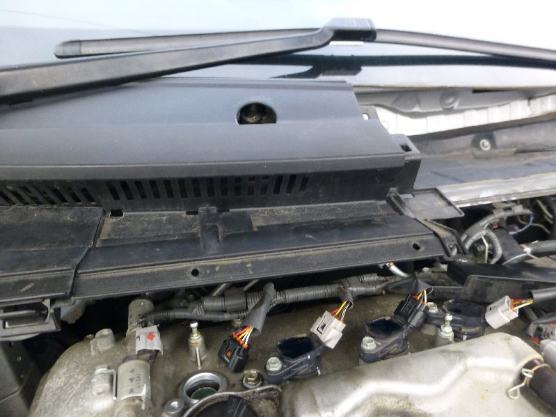

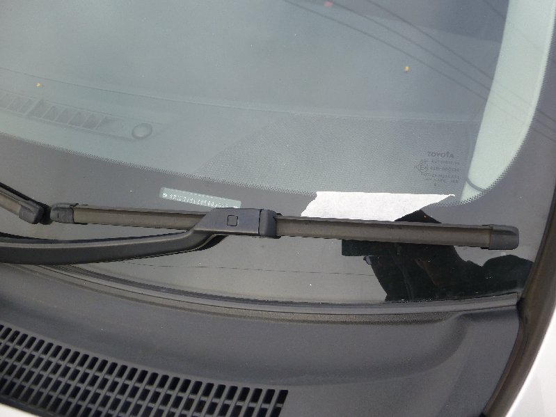

What I did was remove the left hand wiper, the rubber weather strip and half the cowling covering
post-76861-0-40516800-1447079800_thumb.jpost-76861-0-62615000-1447079890_thumb.jpost-76861-0-58424000-1447079915_thumb.j

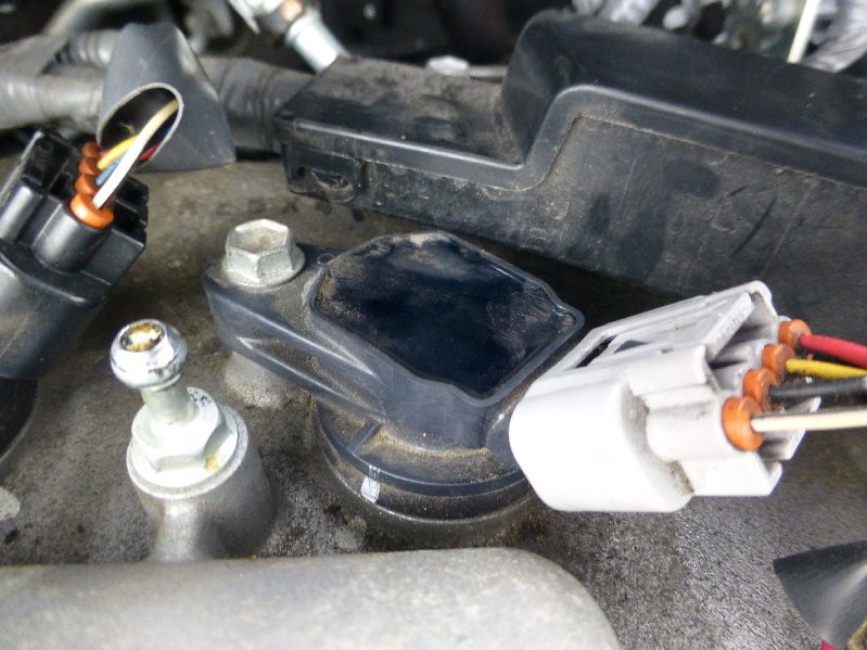

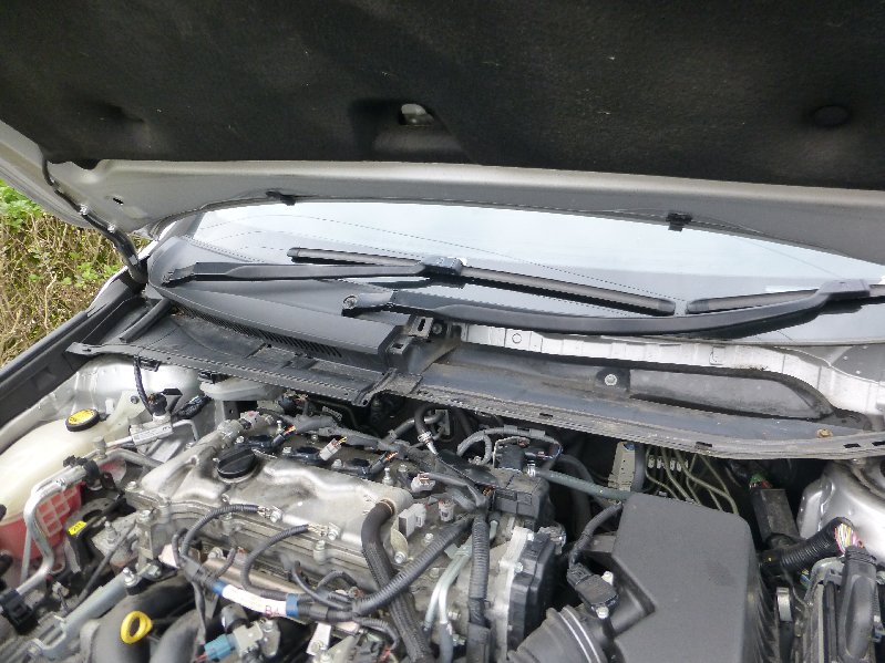

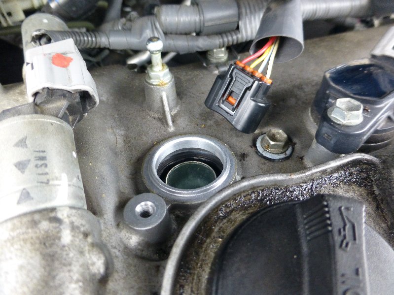

This gives enough room to unbolt, disconnect the coils and remove the coils.
post-76861-0-18233700-1447079968_thumb.jpost-76861-0-96300000-1447080002_thumb.jpost-76861-0-57292700-1447080037_thumb.j

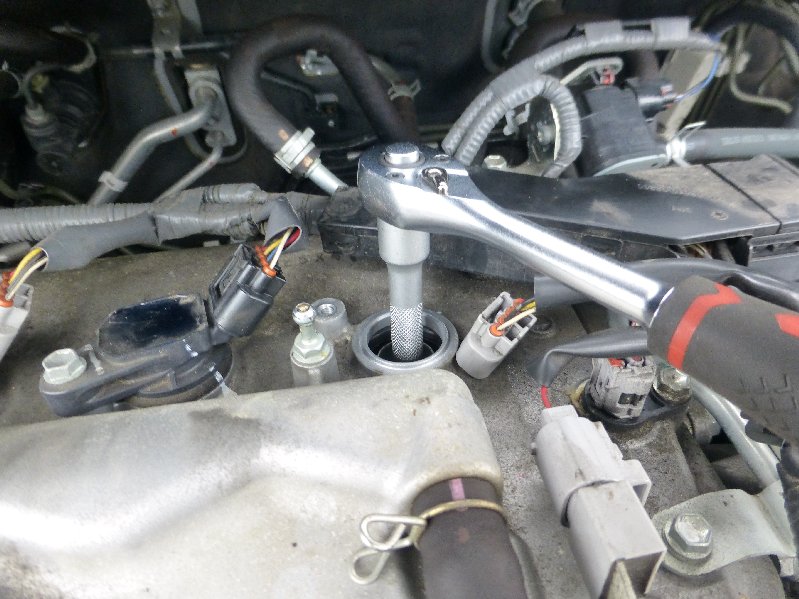

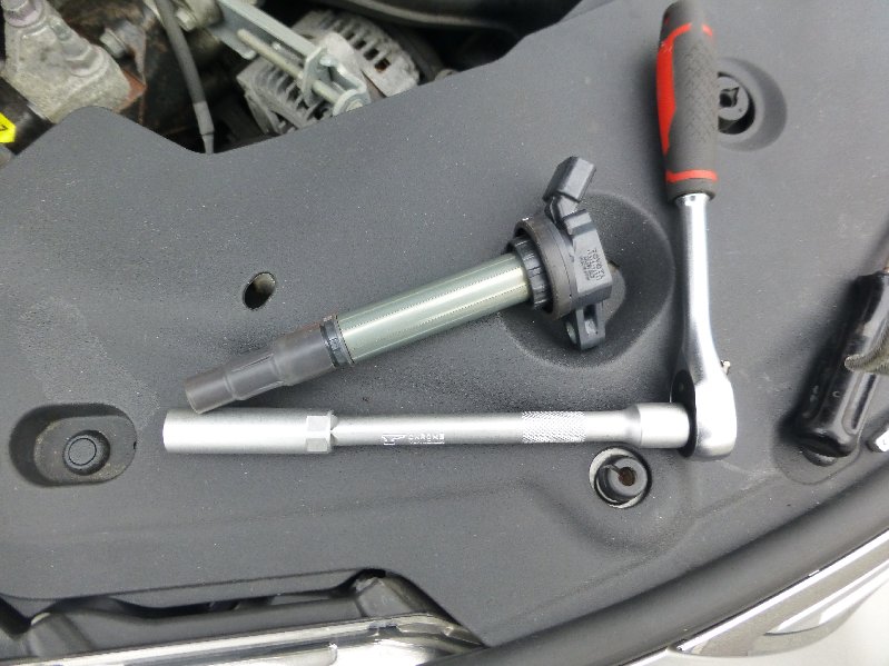

The access is fine if the tools used are the correct size.
post-76861-0-21678800-1447080484_thumb.jpost-76861-0-11682500-1447080535_thumb.j

I received my plugs today and fitted them.

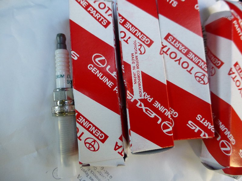

post-76861-0-57145700-1447357643_thumb.j
New and old plugs.
post-76861-0-30274600-1447358109_thumb.j
The car drives better with a better throttle response. The test will be the fuel economy.
