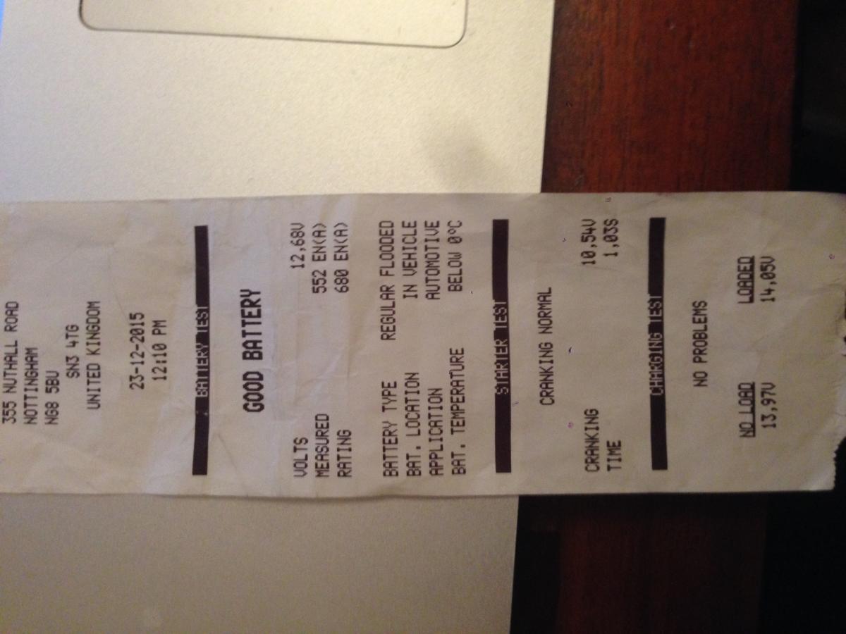

So it got me thinking what could possibly cause this Battery or alternator car has a Halfords 680 Battery in,
So first thing this morning drove over to Halfords to get the Battery checked out car started no problems this morning.
results were as follows according to there YUASA testing kit.
post-151827-0-78488500-1450900040_thumb.
Halford's informed me the battery is fine and no issues with the alternator also.
So then a trip to the garage who did the service so they can run a diagnostic on the car - no issues detected according to them either.
I have applied copper grease to battery terminals been driving around all day and started the car again from pretty much cold start no issues as of yet.
Any ideas or has anyone ever had this happen to them before just don't want to be stranded during a long journey.

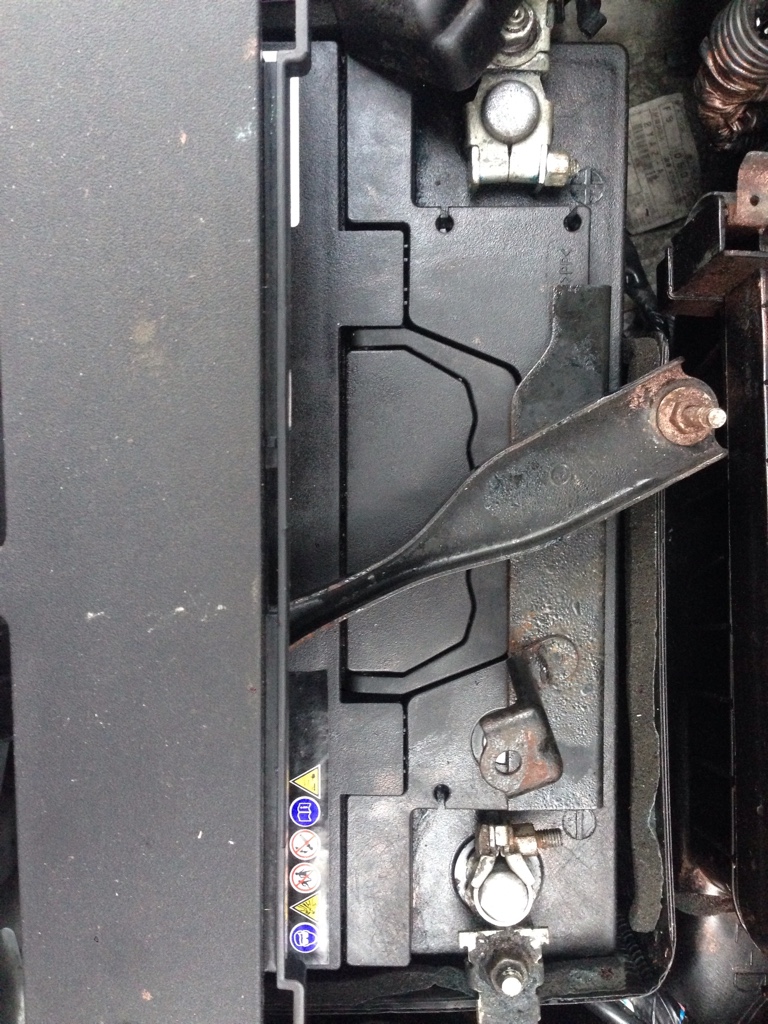

Hi, I have the exact same Auris as you, no problems (touching wood) so far.
If I were having the same probs as you, I would go to the Battery, the condition you explain is typical of the Battery terminals not making contact. How else would the car be dead, its the same as taking the Battery out.
I have seen this a few times over the years, with Toyotas, and is easily remedied by taking the terminals off and wire brushing the surfaces that connect.

Thanks for the reply do you know if the stereo in these cars has a code if not I'll be disconnecting the Battery cleaning the connectors then trying again.
I tried to start the car last night with the fans on etc it struggled turned the fans off no problem starting so seems either the starter is struggling to draw power or Battery connections.

Hi, I've had mine disconnected from the Battery a few times and haven't had to code the radio yet. If your Battery terminals are erratically connecting/disconnecting that is the same as taking the leads off, so if you haven't had to recode the radio yet then probably you'll not need to.
Like I said before, I check the simple things first. If the starter drags when you have the fans on, then keep the fans off till the car starts, this would be normal behaviour if the Battery was run down a bit, if the terminals were making/breaking then the battery would not be getting the full charge and this would explain what's happening.
If you get the battery terminals cleaned and fitted you should be able to turn the ignition on without starting the engine, and do it a few times over a period of an hour or so. Do it again only start the engine as well, if it shows the lights and starts every time you might have just sorted it.
If this doesn't work then your problem could be a bit deeper like the battery itself.
HTH, Dee

Battery removed and all terminals cleaned and re attached will try a cold start later and see what happens.

After cleaning the Battery car has started fine with no issues spoke to Toyota there is apparently a call back on the window switch or something and they will also carry out a visual inspection and according to there records this model is not due any ecu updates
