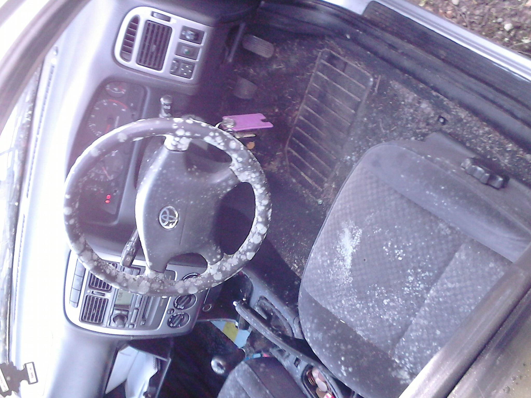

Honestly just use any generic interior cleaner and a nail brush and scrub it all off, wipe the gunk off with a cloth and go at it again until it's clear. Once you've got it clean run the engine, if you can, with the heaters on to dry it out. post-125565-1450950396_thumb.jpg

Sorry, that's a photo of my car, my present one, taken about a year ago after sitting through the winter. It took a couple of hours to get clean and drying out the air inside with the heaters keeps it from coming back.
Take it from an ex valeter a good solid nailbrush,one of those wooden ones is your best friend for all kinds of interior cleaning, more so than special cleaning fluids.A good nailbrush plenty of effort and drying it out is the best way. PS mine looks immaculate inside now.lol

Holy carp bob lol that's wild mines isn't that bad after seeing yours!😂.though if I hadn't of got in to start it I wouldn't of noticed it and probably end up that way!thanks for the advice I will give that a go too.

No problem frankie I can't say I'm particularly proud of either the photo or the state I allowed it to get into. Had to trawl through a heap of folders on Dropbox, Drive and eventually OneDrive cloud storage sites to find that photo but I thought it might demonatrate how bad a car can get if left outside for ages hopefully it would show that mould is easy to kill and cure, if mine can be cleaned without any real difficulty and brought back to excellent nick pretty quickly then so can anyones.lol.
Am not sure what part of the country you live but this is what a wet Highland winter does to a car. All that condensation building up on the windows then making everything damp and ideal for mould to breed.
What you can't get from the photo though was the smell of it but even that is easy to get rid of. Any cleaner will do really,even window cleaner at a push because it looks bad but it comes off easy enough.
