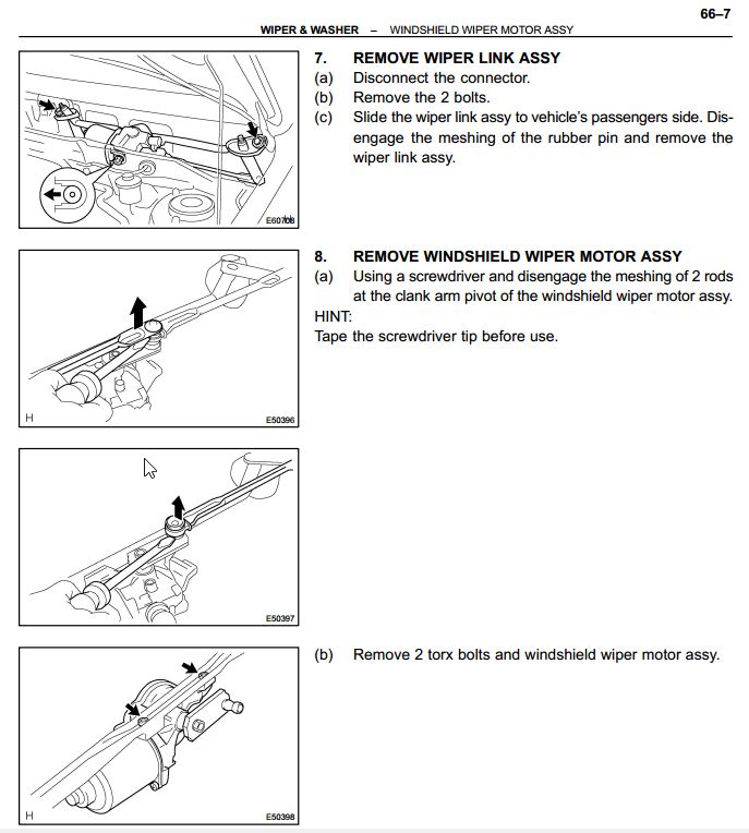

The Haynes manual simply says "disconnect" without any detail how ?
This 2004 sevice diagram again seems to imply there is nothing other that its hooked on without any additional nuts or pins.
However if the rod is still coming off, it kind of implies the connection are badly worn or, if not, one or both arms are jamming/seizing at the other ends and its jumping off at the motor end becuase of that ....?
