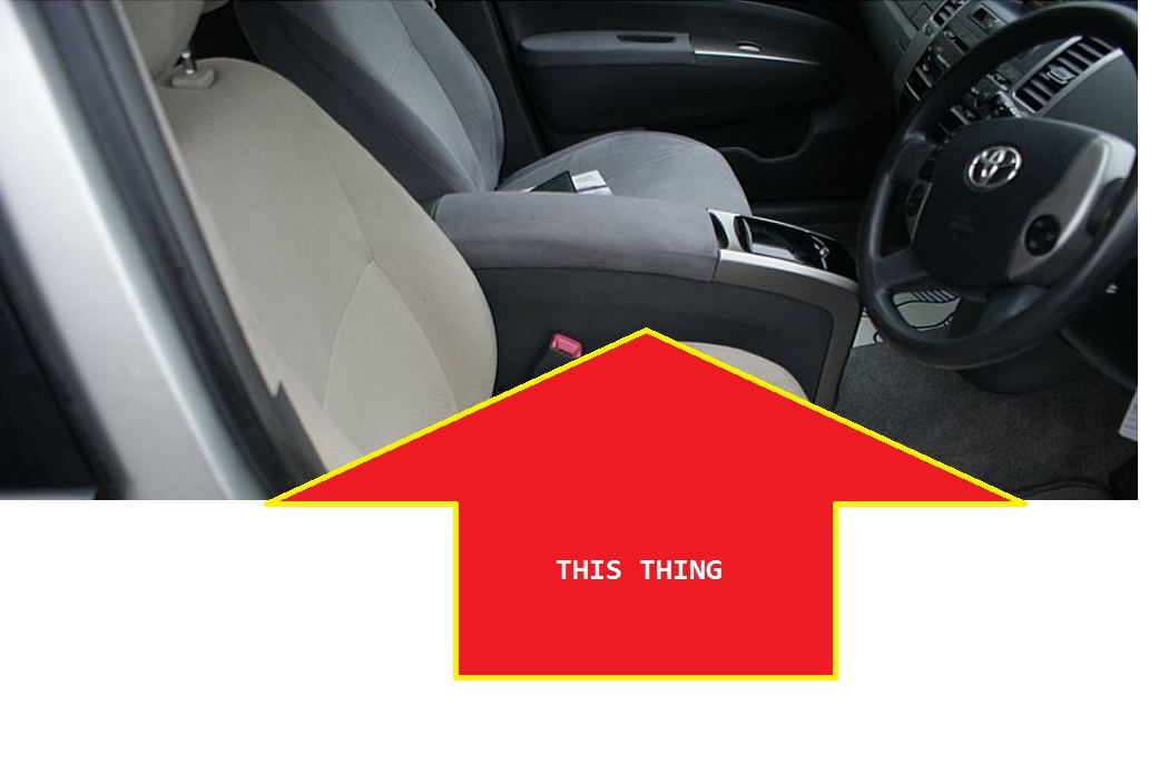

Question: Is it possible to safely remove the central 'armrest' console in a 2004 Pruis without impacting any operations - this would be reinstalled at a later date/resale point
Please see attached image for reference post-152021-0-17516000-1451913545_thumb.
Well, from memory, its only 4 screws to remove it, but the Aux connection point and a 12v charging socket are also in the centre console so if you remove it, there will be wires to be hidden. Also, as I recall, the carpet doesnt extend to under the console, so you will have bare metal in view. If I may ask, why would to want to remove it?

Its an easy enough thing to remove, the 12v charger and Aux socked are under the armrest, which flips up, which is probably why you didn't notice them. It's a case or raising the arm, lifting the lining at the bottom, and removing 4 screws, the electrics unplug as I recall. possibly a bit fiddly but the dealer could probably do it in about 10 minutes.
