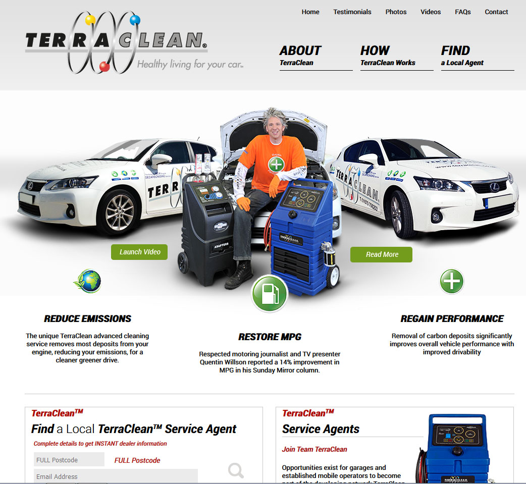

TERRA CLEAN- (Go here to see where they are near you http://terraclean.co.uk/ ) Paid a visit this morning and it took just over an hour to run the treatment through the engine. My initial impression of the car after the treatment is that it feels lighter on the throttle, easier progression, smoother and ever so slightly quieter. As noted above the mpg has improved already, as we barely got the computer to show anything much above 53mpg. Yes, we all know it's winter and there are a myriad of things that can affect the mpg. However, that is rather a low figure for us, even in winter. Having averaged around the 60mpg during the summer, a potential drop of 7mpg is a lot.
Okay, the treatment was done by ACE Car Care Ltd at Unit 7 D&E Vanguard Way on Battlefield Enterprise Park in Shrewsbury. At this point, even with the high -for me- price of £108, I think it will be worth it. They recommend it be done once a year but unless it gets cheaper, it will be every couple or three years for us. You can find out more about Terra Clean on the Internet or visit the ACE Car web site. It's too much to put on her and I don't want to steal any more of Daniels thread than I have already. It reduces emissions, restores mpg and regains performance.
Almost missed that out, performance is far better. No sluggishness, very linear acceleration and no hesitation at junctions and lights from the engine. Reminds me, must tyre pressures checked again.

Recently I had our car Terra Cleaned, and I got this e-mail from Ace Car Care today, which helps explain the process a little better-
A Colonic Irrigation For Your Engine - WHAT?!
Hi, It might sound a bit strange, but bear with me a little and I'll explain.
As your engine burns fuel (petrol or diesel), carbon is created as a by-product of the burn, and this carbon gets deposited on the internal parts of the engine, like the injectors, cylinders, piston tops, valves, exhaust system, sensors, etc.
Over time, this build up of carbon gradually results in the engine and its components operating less efficiently, which reduces the power, uses more fuel, and increases the emissions/CO2 output of the vehicle.
Now not so many years ago, engines were stripped and 'de-coked', but now with the advances made in technology, there is a quicker and less costly way of removing carbon build up from your engine and exhaust.....it's called TerraClean.
The process works by disconnecting the fuel lines and connecting the TerraClean equipment to the vehicle, and running the engine on the TerraClean fluid instead of the regular fuel. There are several cycles to the process, but after an hour or so, the work is done and TerraClean cleans everything from the injectors through to the tip of the exhaust, including the cat!
