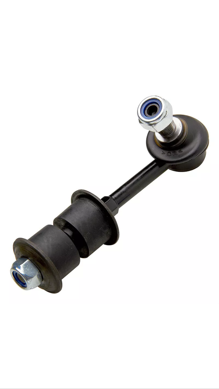

We had the same thing. A loud bang like a spring not sitting right, every so often. I looked underneath and it was a snapped drop link. This connects the rear anti roll bar to the wishbone. Easy job but expensive for a genuine Toyota part.
