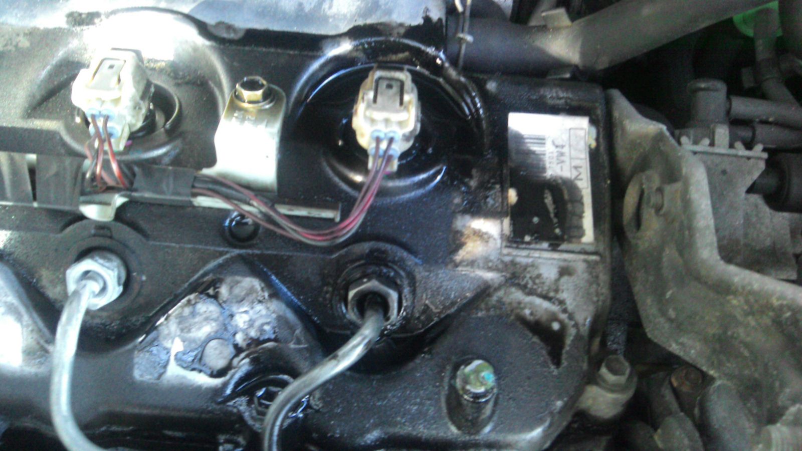

injector loose
ffej
Most likely a loose or broken injector clamp allowing the injector to move and seals to fail. Best to replace the clamp, injector seals and rocker cover gasket.
Afraid so, you will also need 4 x seals between rocker cover and injector pipe the one in your picture already looks to be leaking
Hi well the garage spent all day doing nothing ,so its back. Home ,and I have got it apart and seals on order ,now the bottom seal on the injector didn't come out with. It ,and I can't get it out .it feels that carbon as built up under it and when I put the injector in its stands higher that the others.. Thanks for any help and info .....(all this because it came loose)

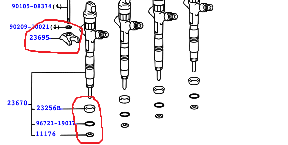

Will be putting it all back together tomorrow .manage to get the seal out today using wd40 petrol and welding rod just got to work out how the white and rubber seal fits   any idea ?????
My picture above should suffice
11176 - is the metal washer you had difficulty removing
96721- is a rubber "o" ring that seats in a groove 1/3 way up the injector
23256 - is a lager rubber seal that seats in a larger groove about 1/2 way on the injector
there are also large "top hat" seals that push into the rocker cover where the fuel pipes join the injector
