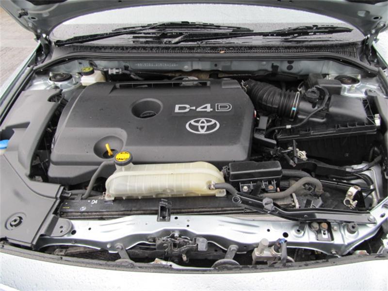

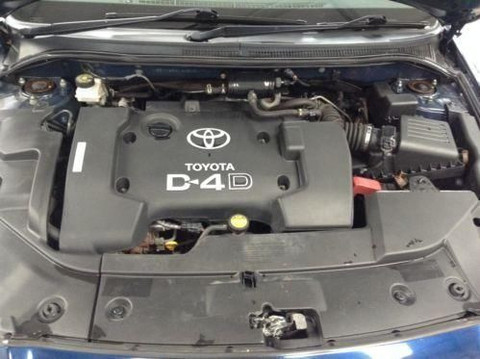

Ok peeps, im getting confusing info on whether my car has a timing belt or chain. 2007 Avensis D4D TR. Anyone any idea ? Ta.
If its a 2.2 then its a chain, if its a 2.0 then the car is right on a model change, if your side indicator repeaters are in the wing then is a 1CD engine with timing belt if the repeaters are on the side mirrors then its a 1AD engine with timing chain or see pictures attached
Thanks for that, its a chain then as its a 2.0 with repeaters on the mirrors.
