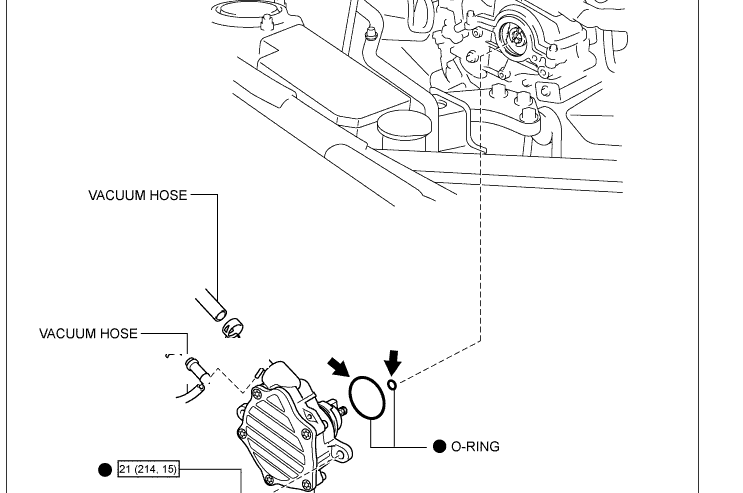

The part is in the left end of the cylinder head ( looking into engine bay ) its sealed, non serviceable and needs changing every 120,000 miles.
