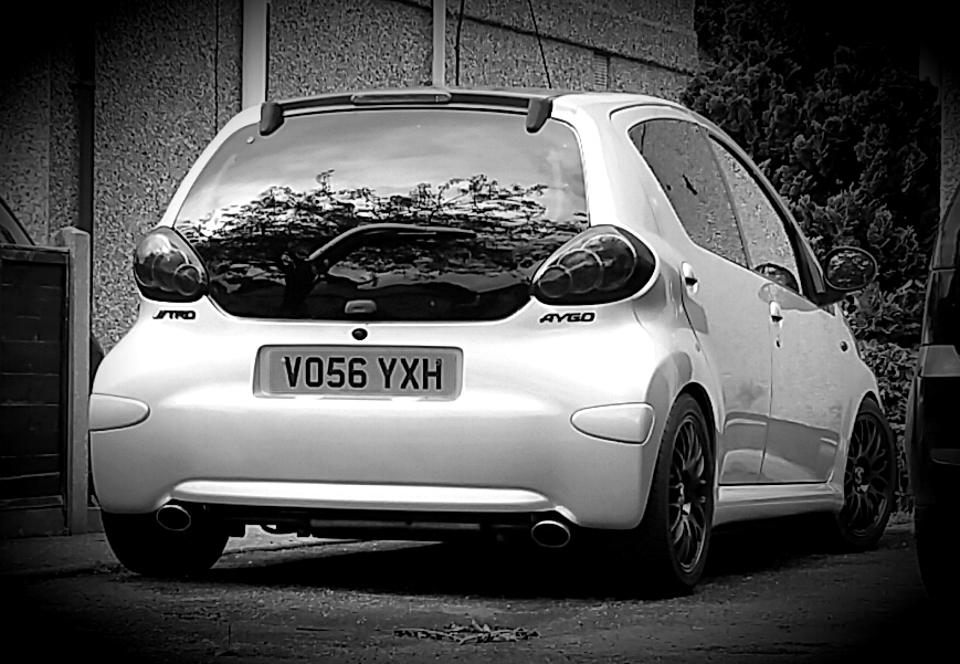

Black wheels look good on Aygos but then I am biased :)
The pic is shown on coilovers, it was previously on Eibachs which I still have and you may be able to twist my arm if you are interested ;)
