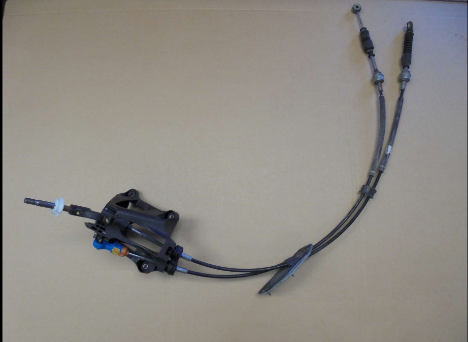

+1 to what Konrad says. Also you say the gear lever goes fully into the gate but sometimes doesn't engage gear. The connection between the gear lever and the gearbox selector is by cables and they may need adjustment.

Mr.T has adjusted the cables, but seems to make no difference :(
