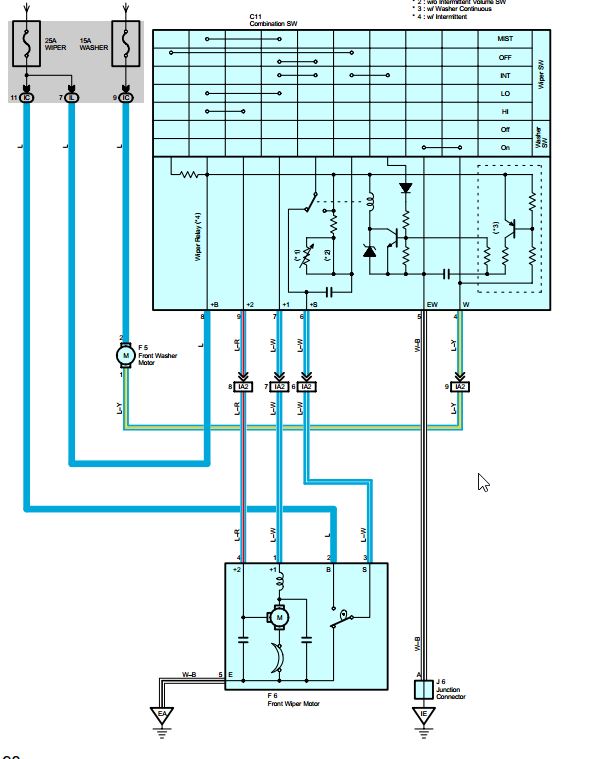

From the 2002 model onward , seems the wiper fuse is 25A and feeds into the combination SW before going to the motor.- see picture
The Sw assembly diagram also shows the intermittent timer and wiper relay are in or around there, so could be anything in and around there ..
If the fuse is out then the side connected to the Battery will show a voltage when connected to earth (not really earth but negative through the bodywork) and should be 0volts on the other side of the fuse holder.
As to the voltage difference when you move the heater fan that, I suspect, is because the fan speed is changed via a rheostat. A device which lowers and increases the voltage to the fan motor. Test both sides of the fuse holder through earth. Should be 0 on one side. 12v on the other. There may be a short in either circuit. If the heater fan and wiper is on the same circuit on fuse box which is likely as both are high amp items. If not then there should be no effect on the wiper circuit when turning fan switch
