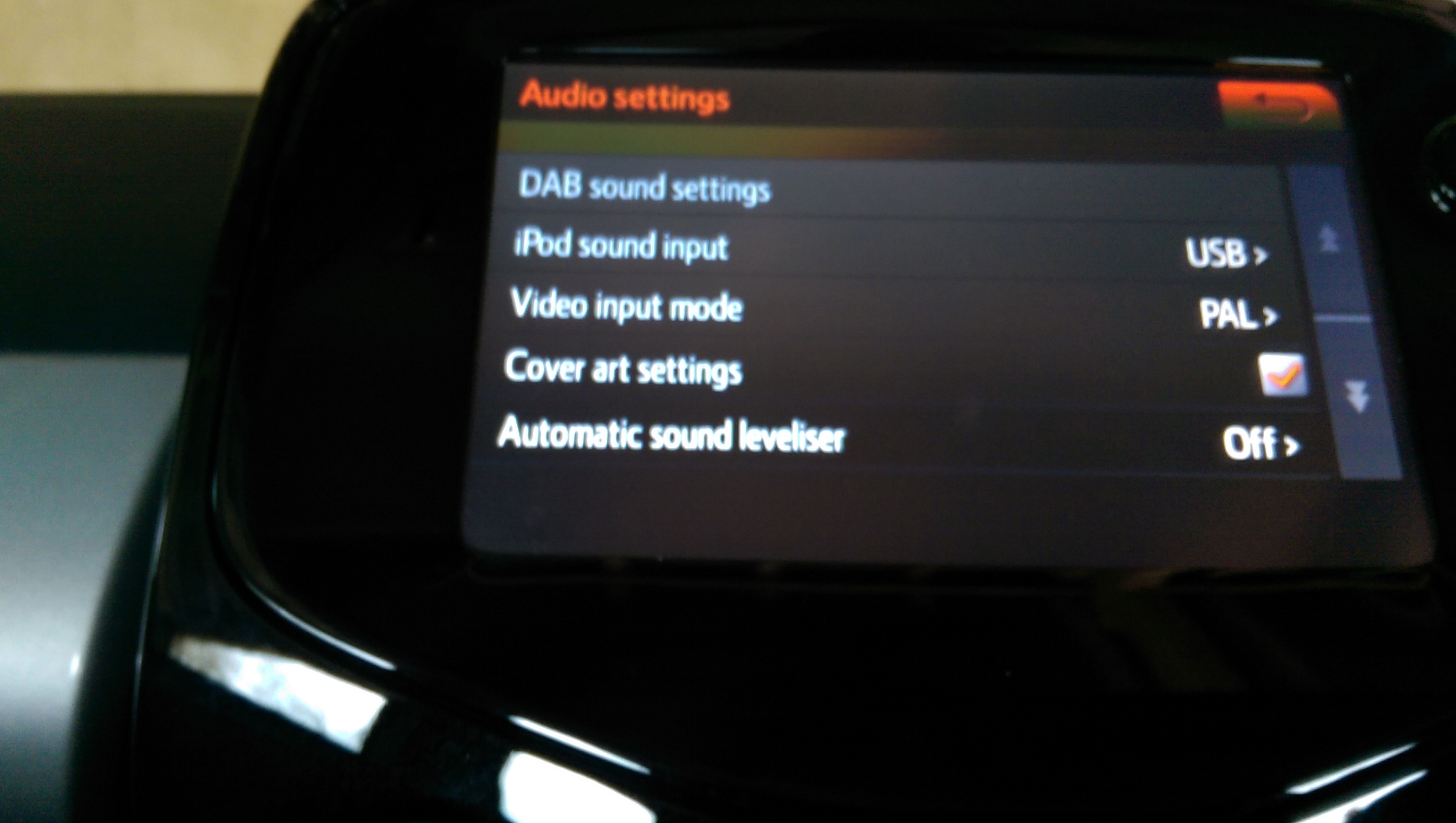

Enable  cover art in settings
Hey presto
Looks really good, just checked mine & the Cover Art is selected.

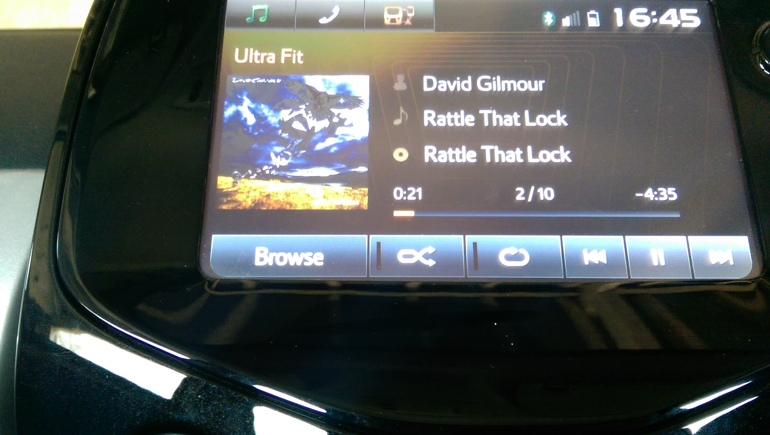

Thats working fine now, many thanks for the information.
I resized the image from 500x500 to 300x300 & the file size is now showing as 57KB
