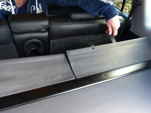

Hi, Just bought a 4-3 later type 2006 Rav 4,  It didn't come with a parcel shelf so I've bought  one of eBay that's supposed to fit . I thought that the front part would roll out and fit to the back of the rear seats but it doesn't roll out and looking in an on line handbook it looks like it fits to some kind of net which of course I don't have . Can somebody throw some light on this net with photo if poss, or have I bought the wrong shelf. I think my best bet would be to get the mrs to try to make something to fill the gap. Any ideas please ?

Thanks for the replies, my parcel shelf is similar but not the same, the rear part falls short of the rear seats by about 6". See photo. The rear of the shelf is not a roller blind it's fixed. As I mentioned earlier I've read of it fixing to a net that I don't have.

Slide your seats back and those straps will clip on to the head restraints (you may also need to adjust the recline). There is no net arrangement.

That's it ! Why didn't I think of that. I was convinced there was something missing. Thanks
