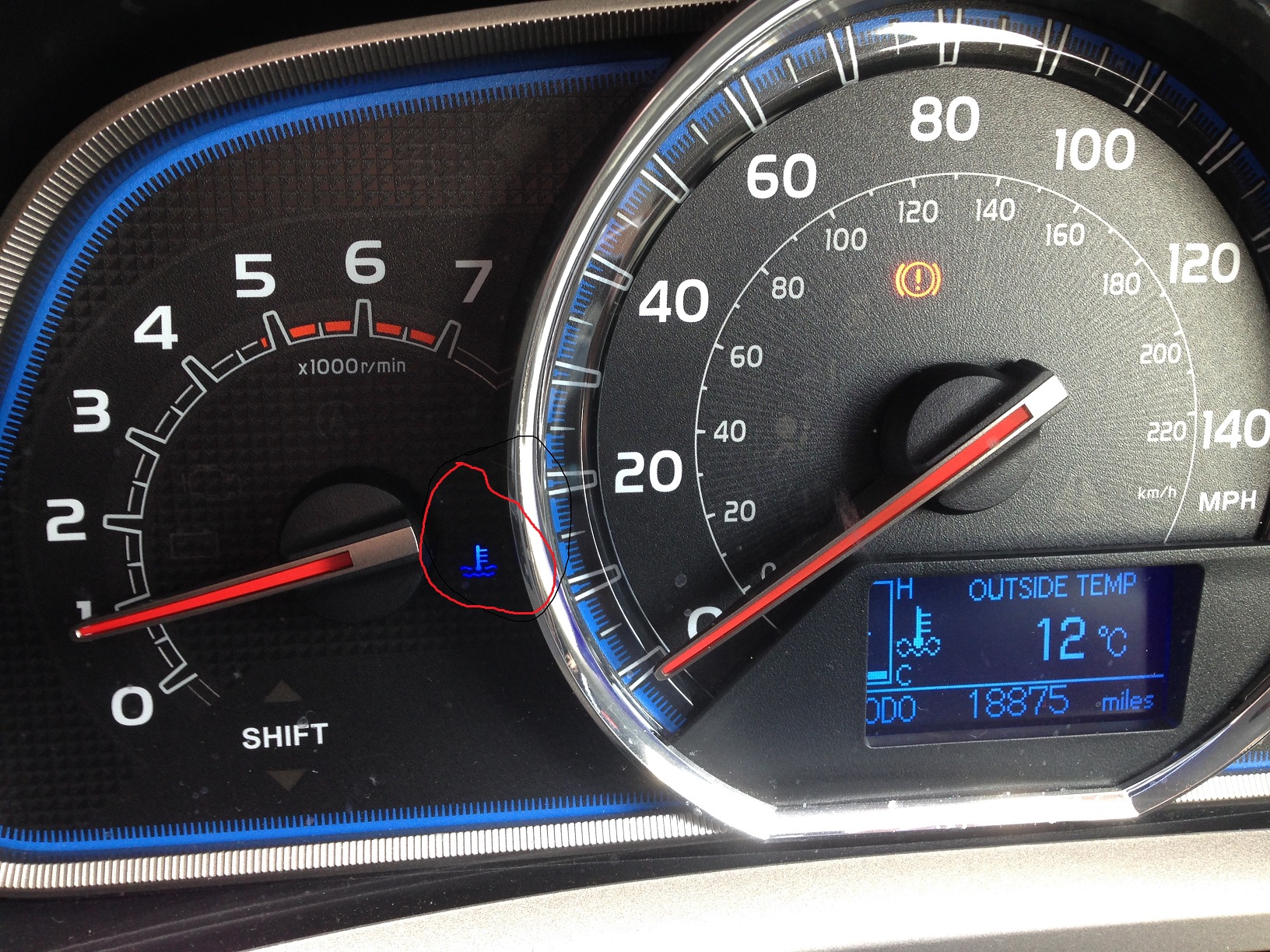

Hi this symbol has been coming on from start up to about 4 miles for last few days  never use to  any ideas  Thanks
You'll find it goes out when your engine warms up. My 2015 RAV 4 does it too. It's not a fault so don't worry.
Thank's Dave its just never had it for first 3 weeks of owning and then it appeared every morning for last few days .I'll try to ignore it now
Mines done it from new, I think it's to suggest you don't thrash the motor till it's warm. The one that foxed me was a warning light when the tyre pressure dropped due to -4 degrees. Easy to reset though when you know where the reset button is ( I didn't! ). It's above your shins under the dashboard.:smile:
Nice one didn't know that either :biggrin:
If you've got the keyless ignition you have turn it on but don't actually start the car then hold the reset button in till the warning light goes out. Sensitive little beggar, it only dropped a couple of pounds. Are you enjoying the RAV ? We're on our third ! This is the first new one we've had and its great, tows the caravan a treat.
