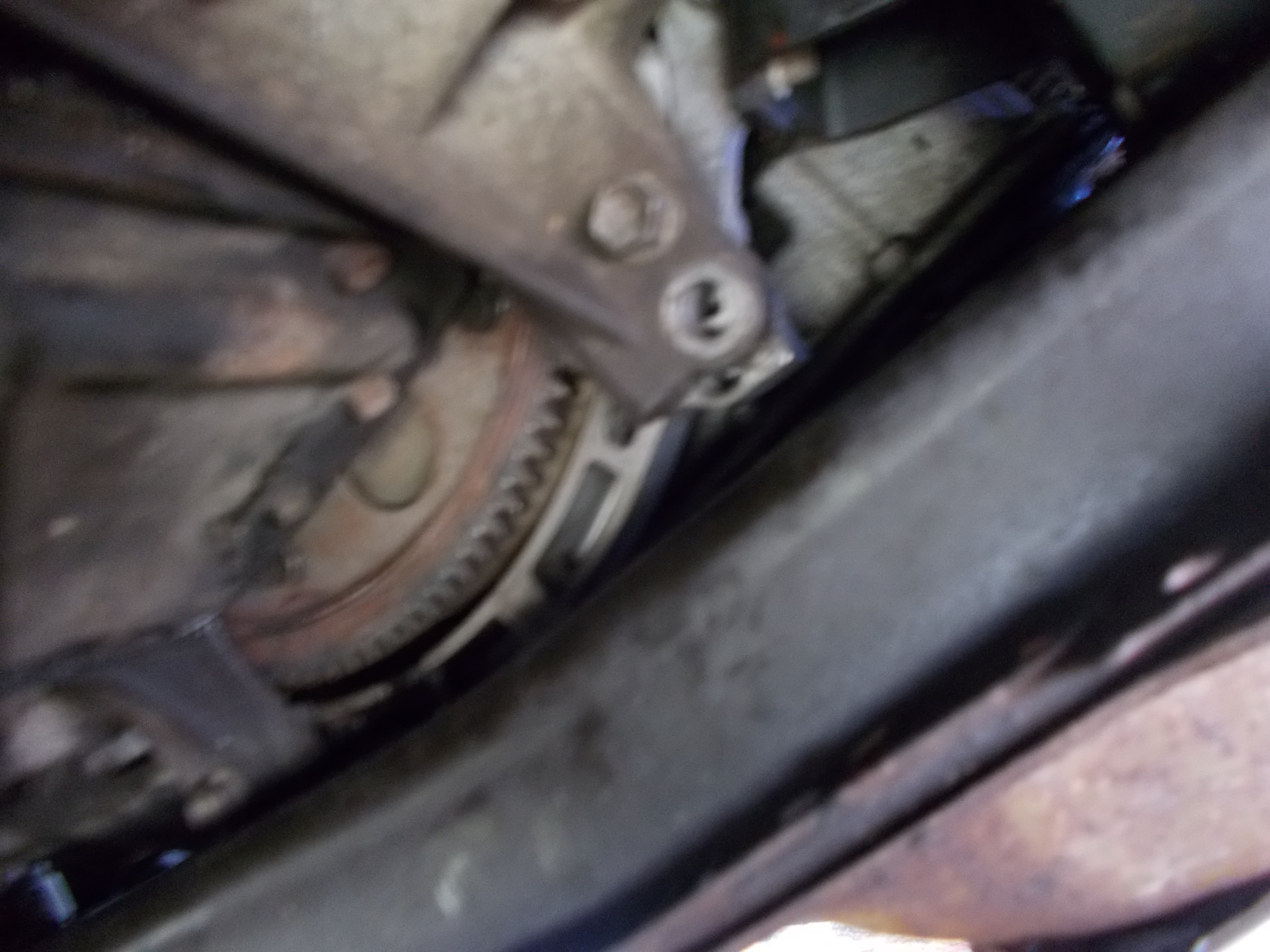

No it's bigger than a bung, its like the whole lower half of the fly wheel is exposed. looks like a big blanking plate is missing, I meant to photograph it but as usual the camera was dead.

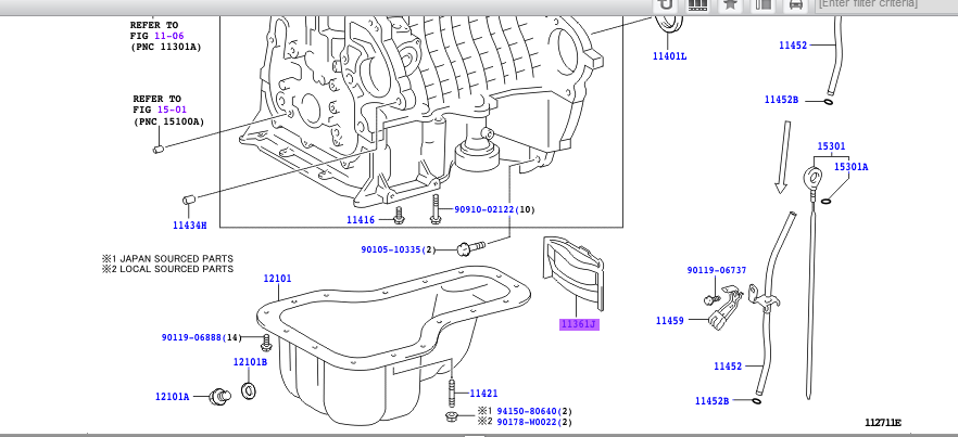

There is a cover part number 11361-22021
Devon Aygo, I think that is it, its just not there at all. Thanks for that, Now I have to try and get one.
Here is a photo under the engine, you can see the flywheel with starter ring teeth.
That is where I thought something should be covering it.
