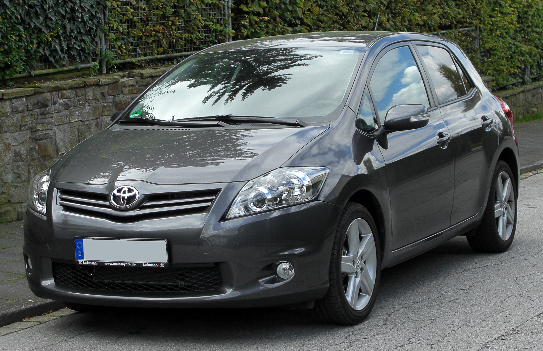

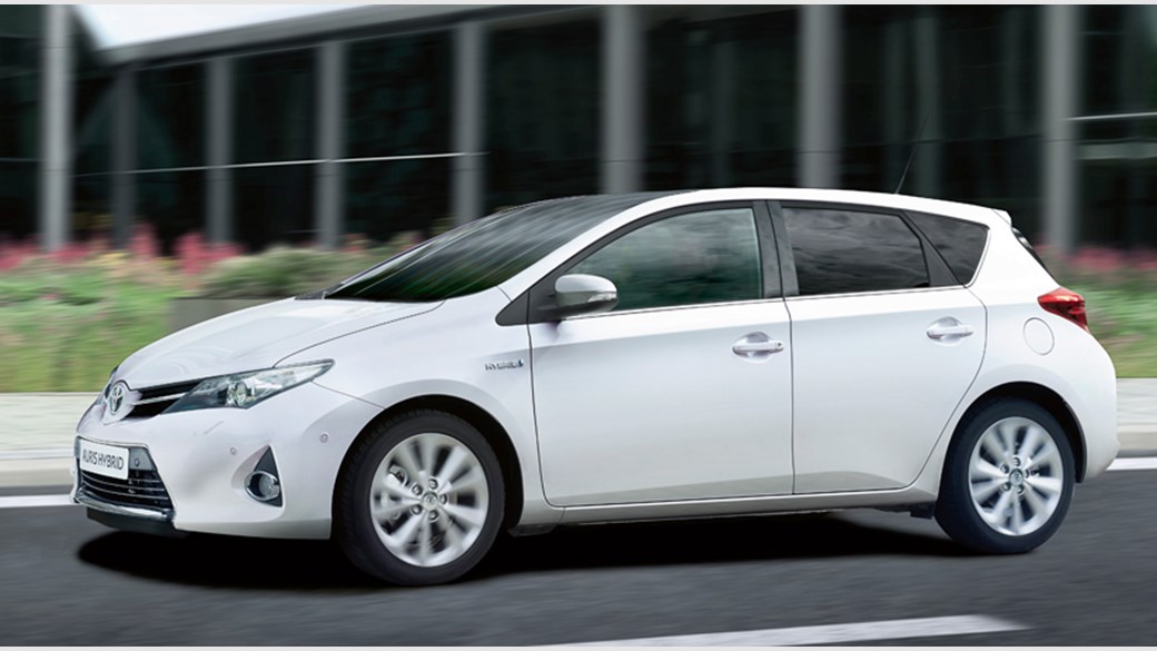

Make sure you get the new shape (like the white one), not the old shape (like the grey one).
Thanks chaps- So from 2013 I can get the 1.6 petrol CVT auto, conventional handbrake, ordinary (fat) tyres and no stop/start system. What is not to like so I will go for that.
