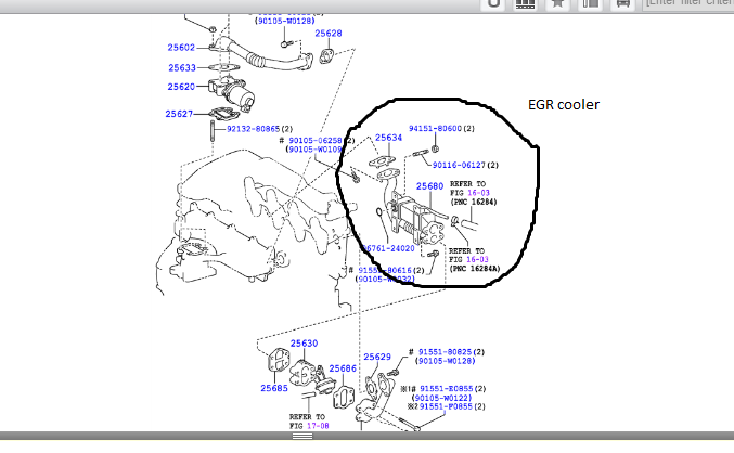

Firstly on a T/SR180 engined car you cannot block the EGR flow as it is monitored by the ECU and if there is no flow the car will go into "limp mode" this is to protect the DPNR filter.
Secondly the little chucks of carbon are most likely not coming directly from the exhaust manifold but forming in the EGR cooler, a coolant to gas heat exchanger bolted to the back of the cylinder head the is an absolute PITA ( takes between 8-10 hours to remove & refit ) to remove but can be cleaned by removing, blocking one end and filling with a strong ammonia solution and repeating until the flushed solution runs free and clear.
There is a fix and a technical service bulletin EG-0041T-0412 which includes changing a whole host of bits updating the EGR system to a type introduced on the T27 Avensis but it is expensive +£2000 at Toyota's own reduced warranty rates.
