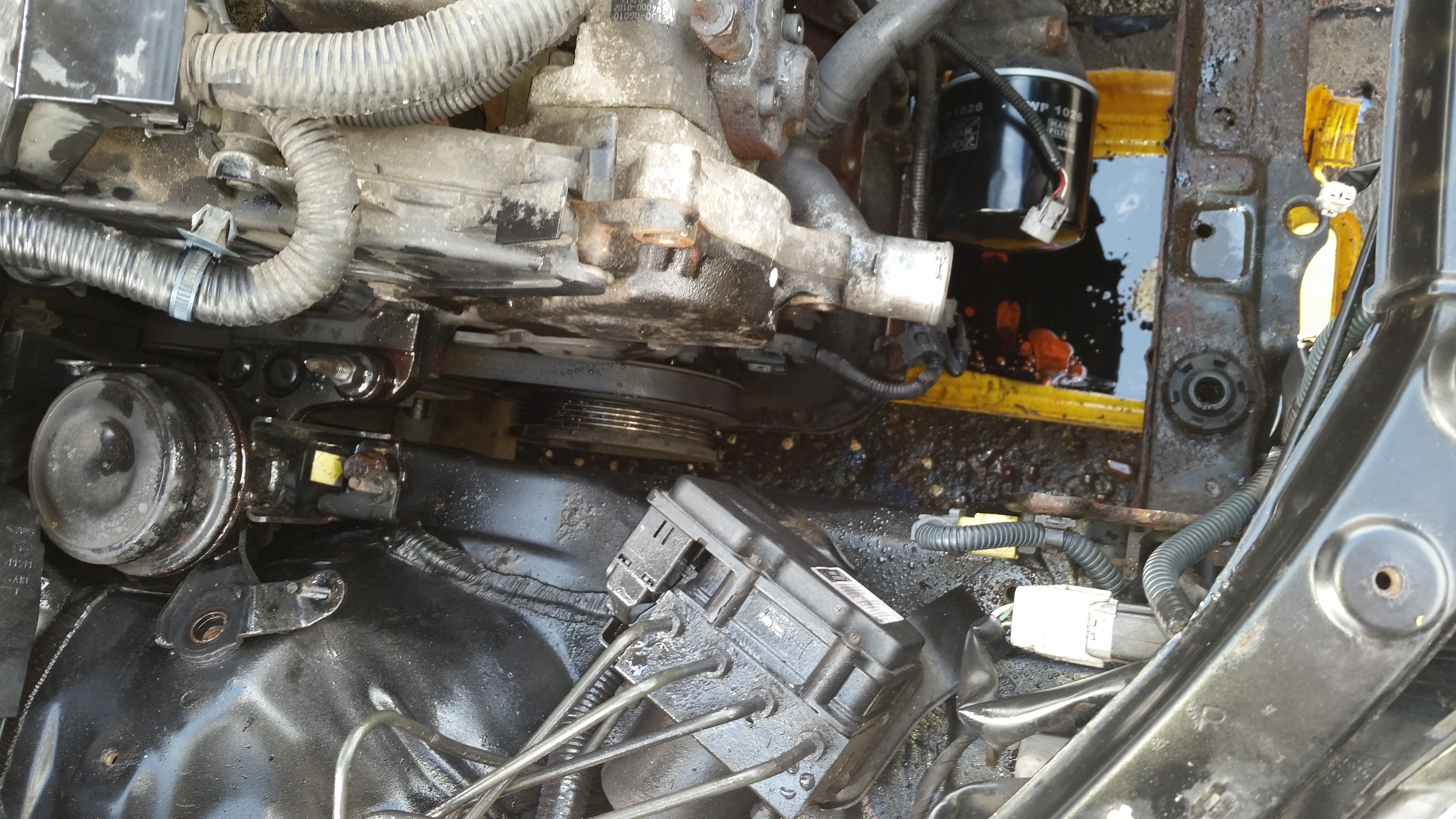

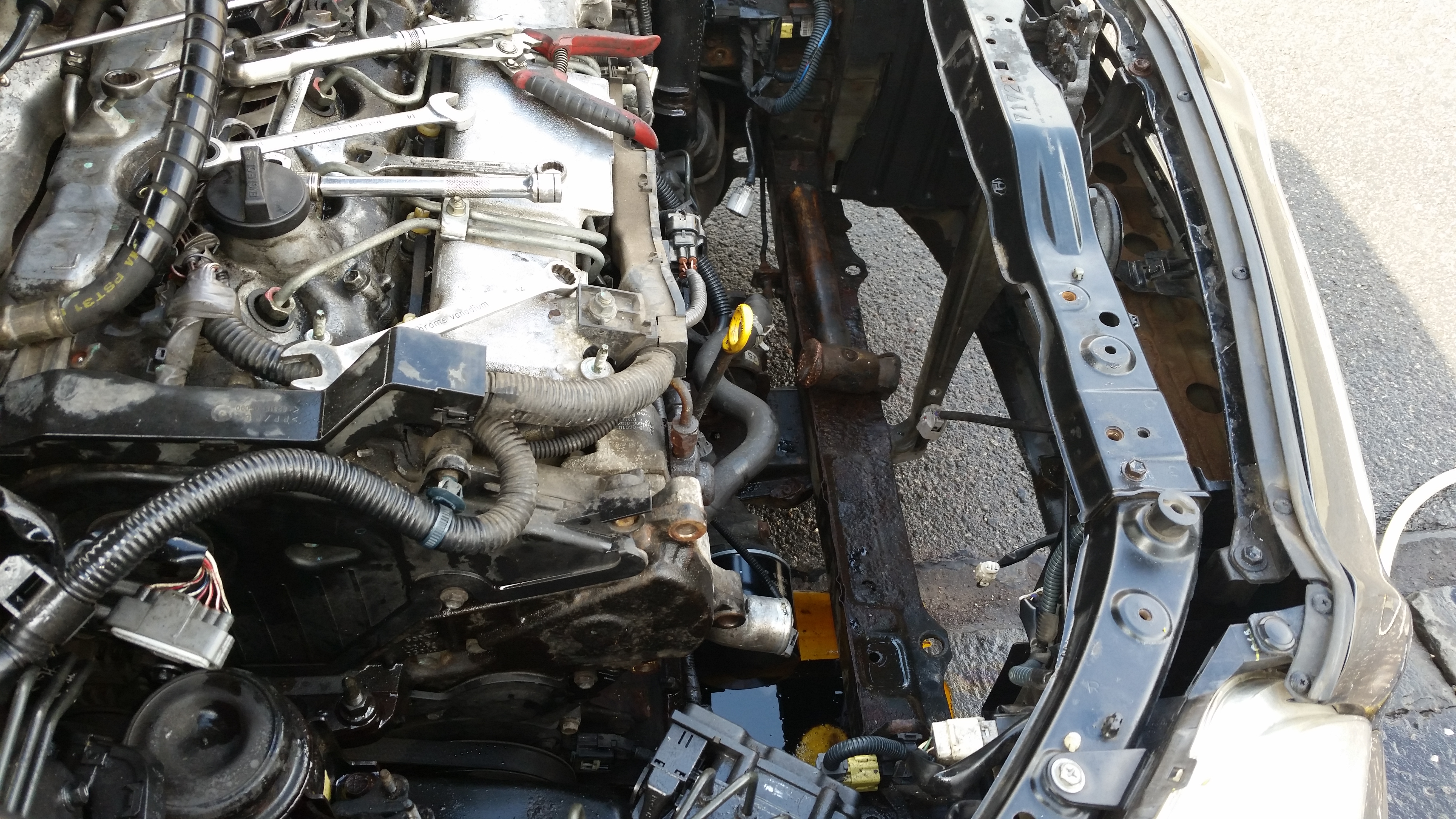

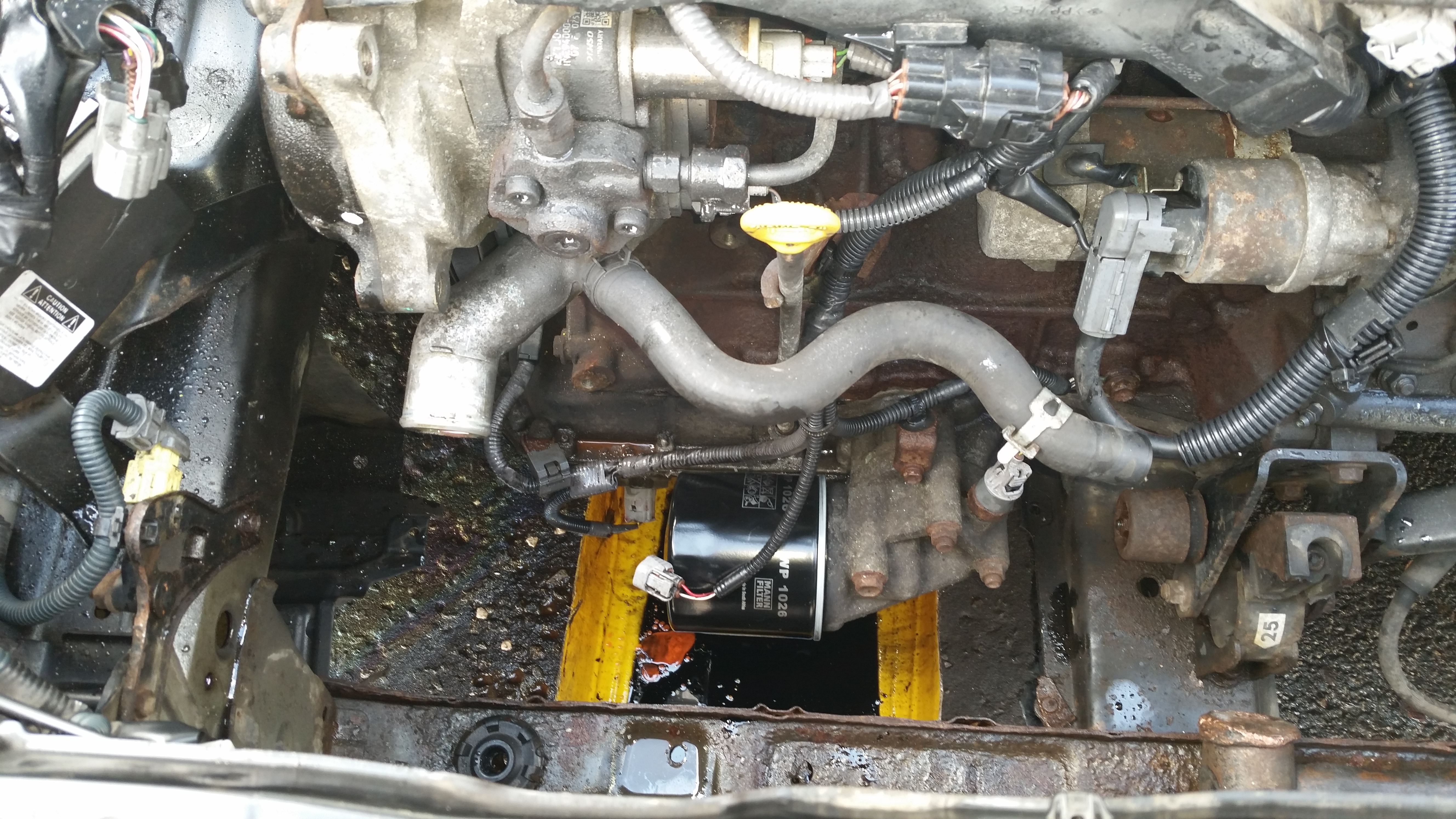

some pictures for anyone going to tackle one in future

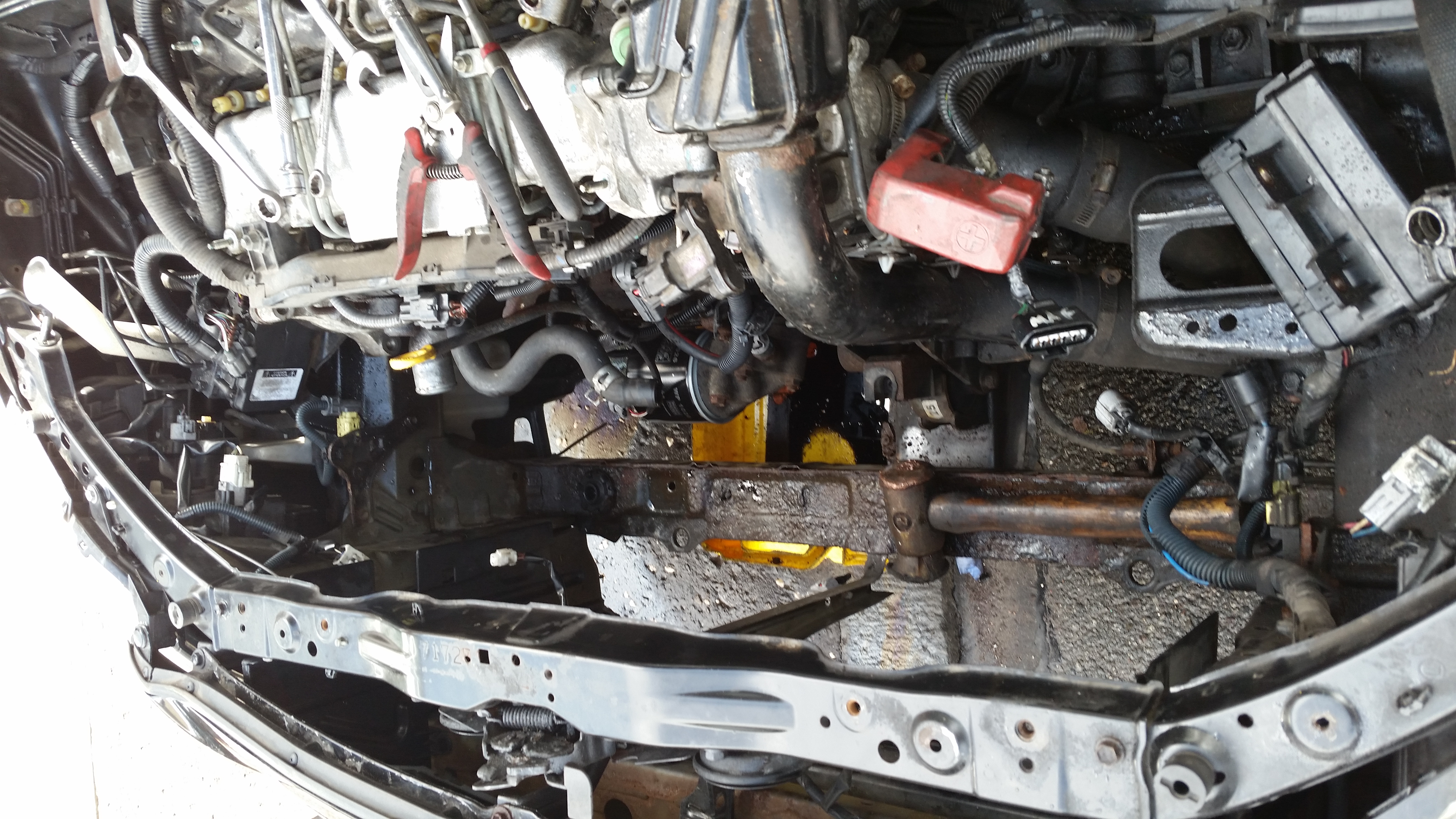

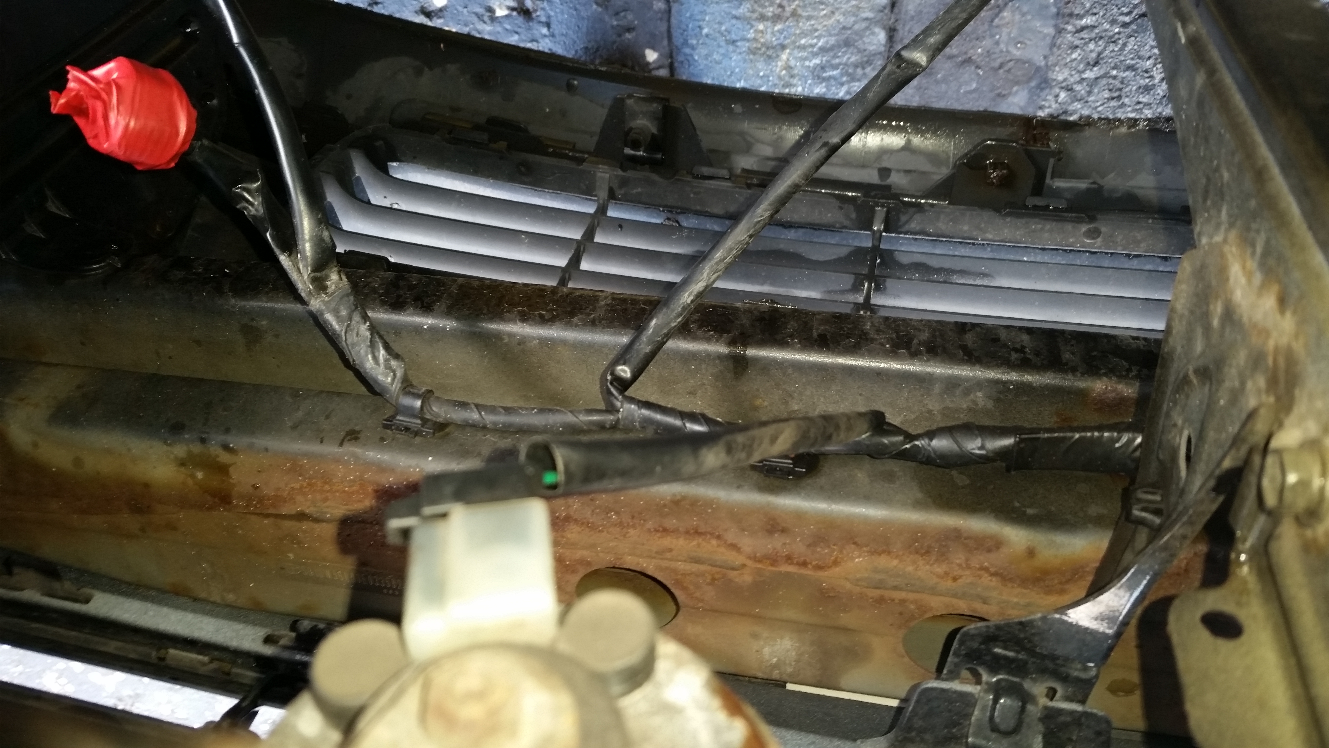

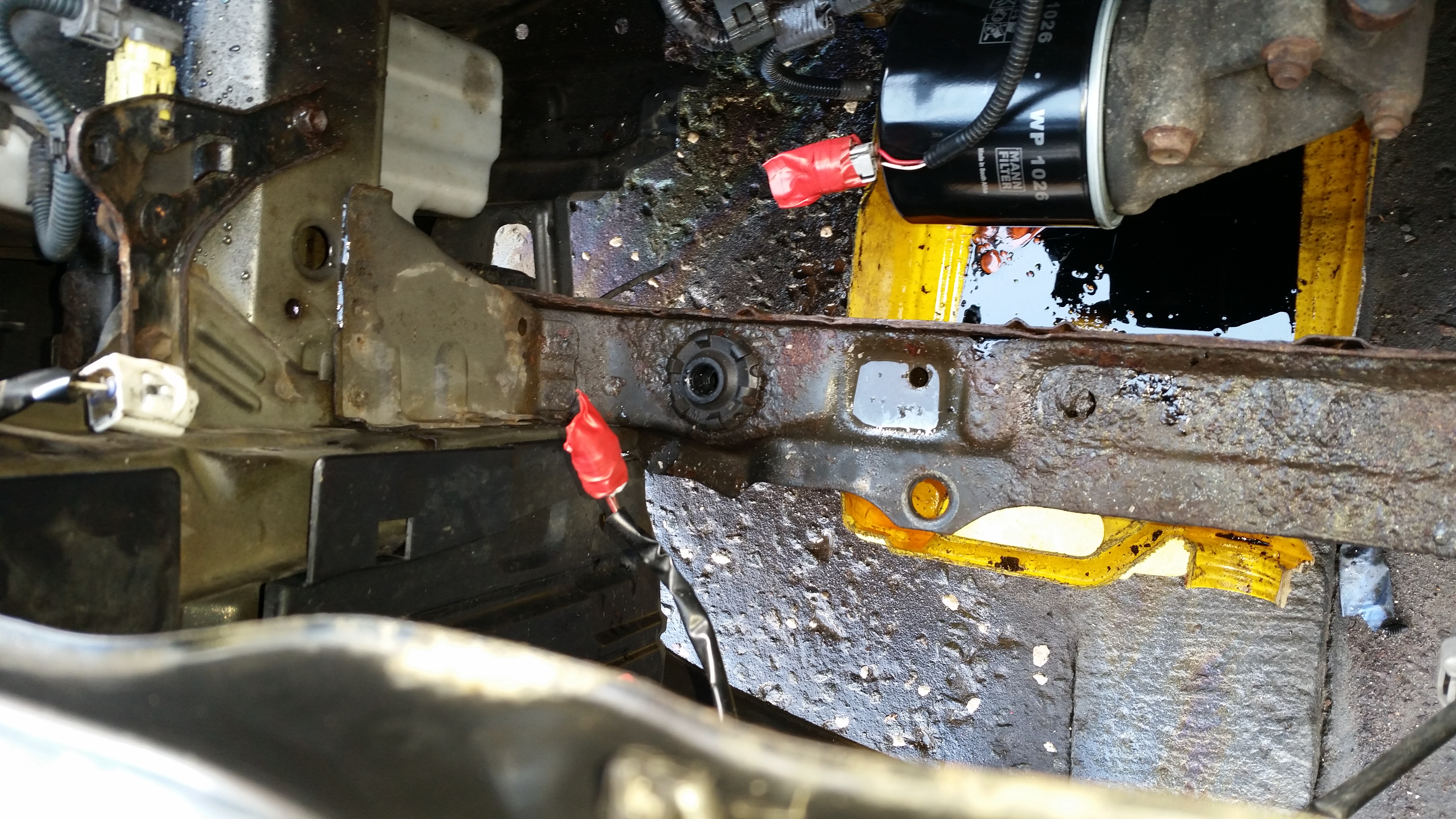

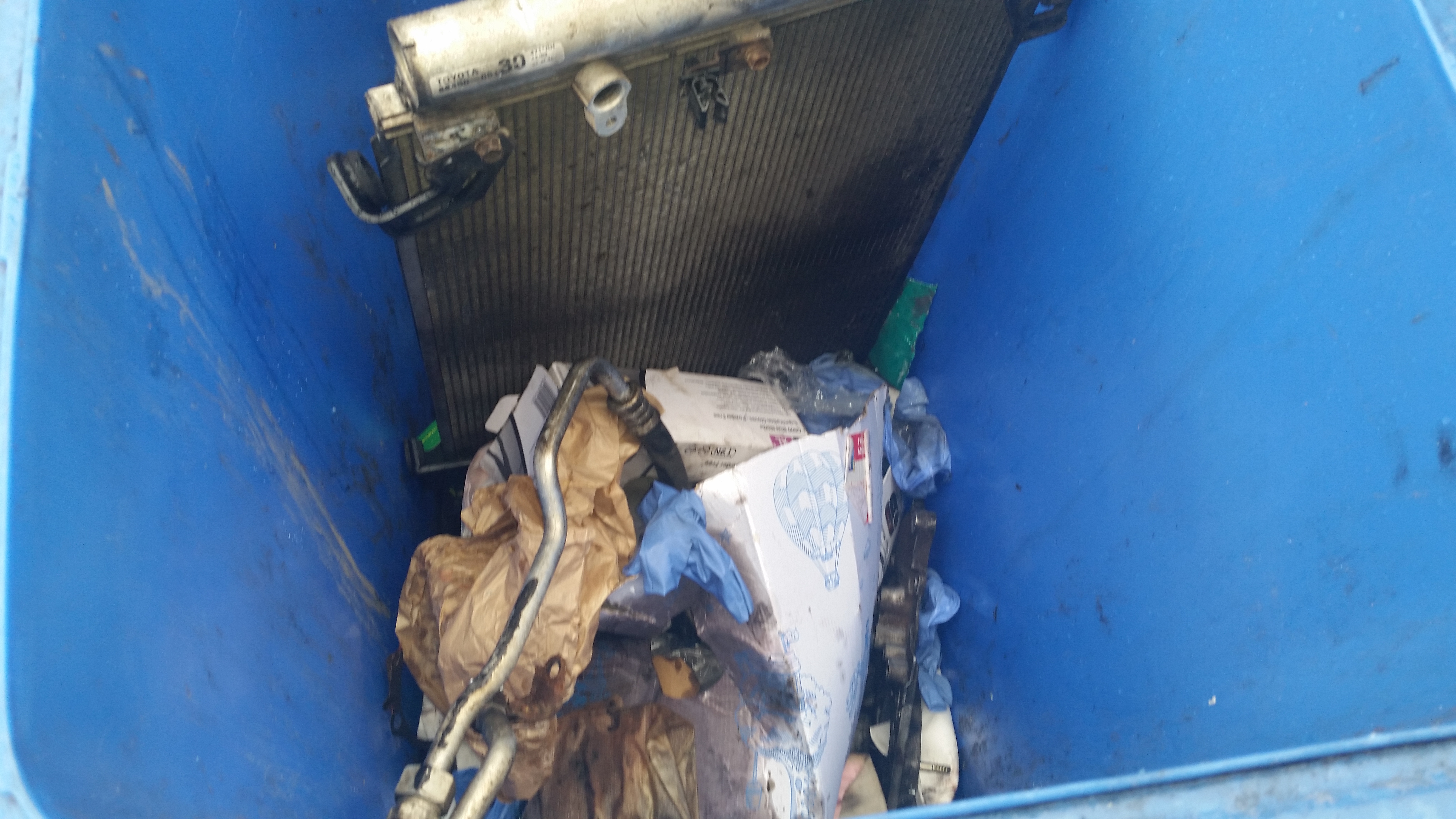

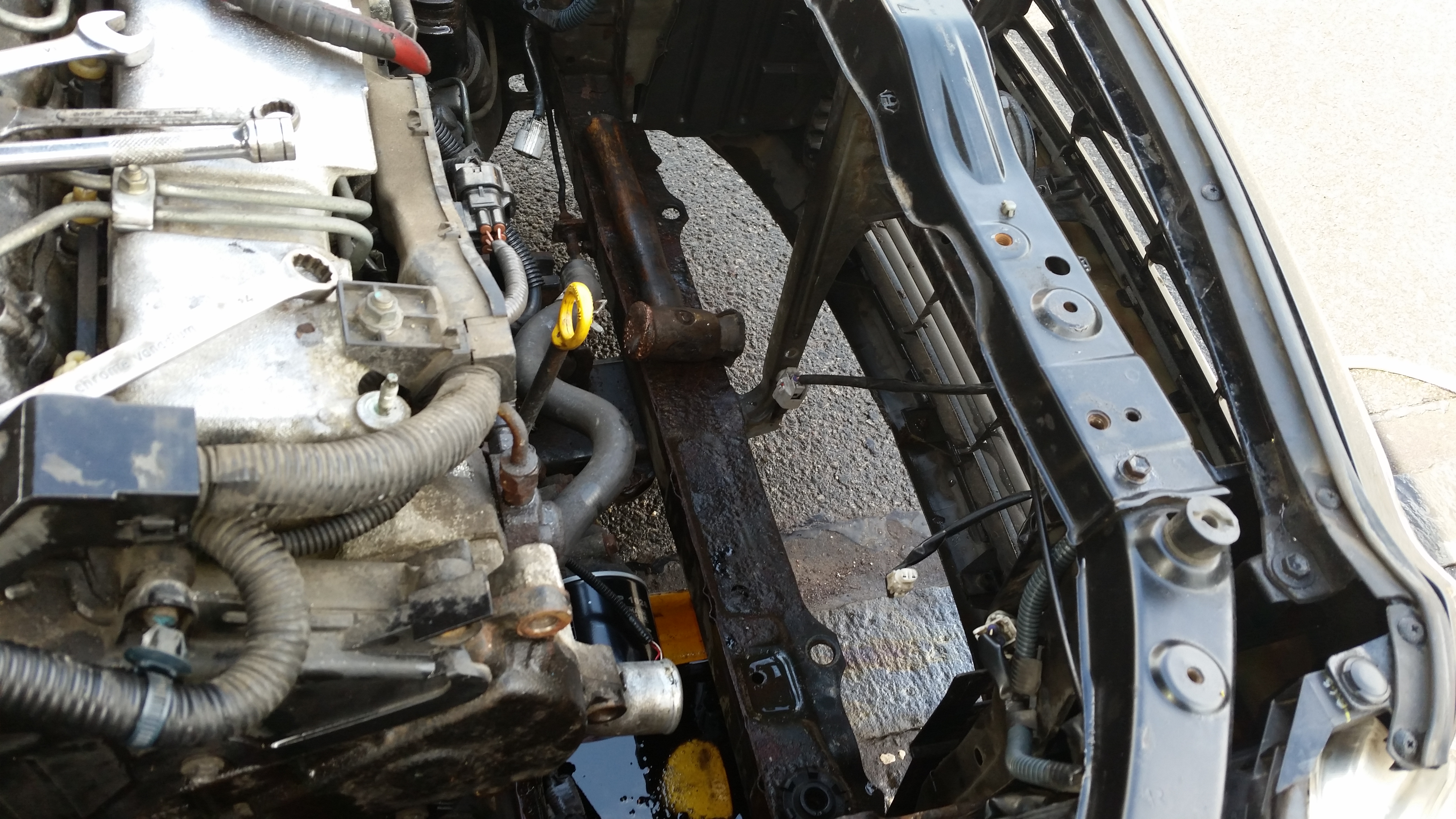

ripped out aircon as it was losing gas and had slight noise appearing at pump so never gonna spend the money involved to fix it.
has much better access for the job in hand.
less weight and belt drag = 0.001 better power to weight ratio lol
done the filters and oil when in about it

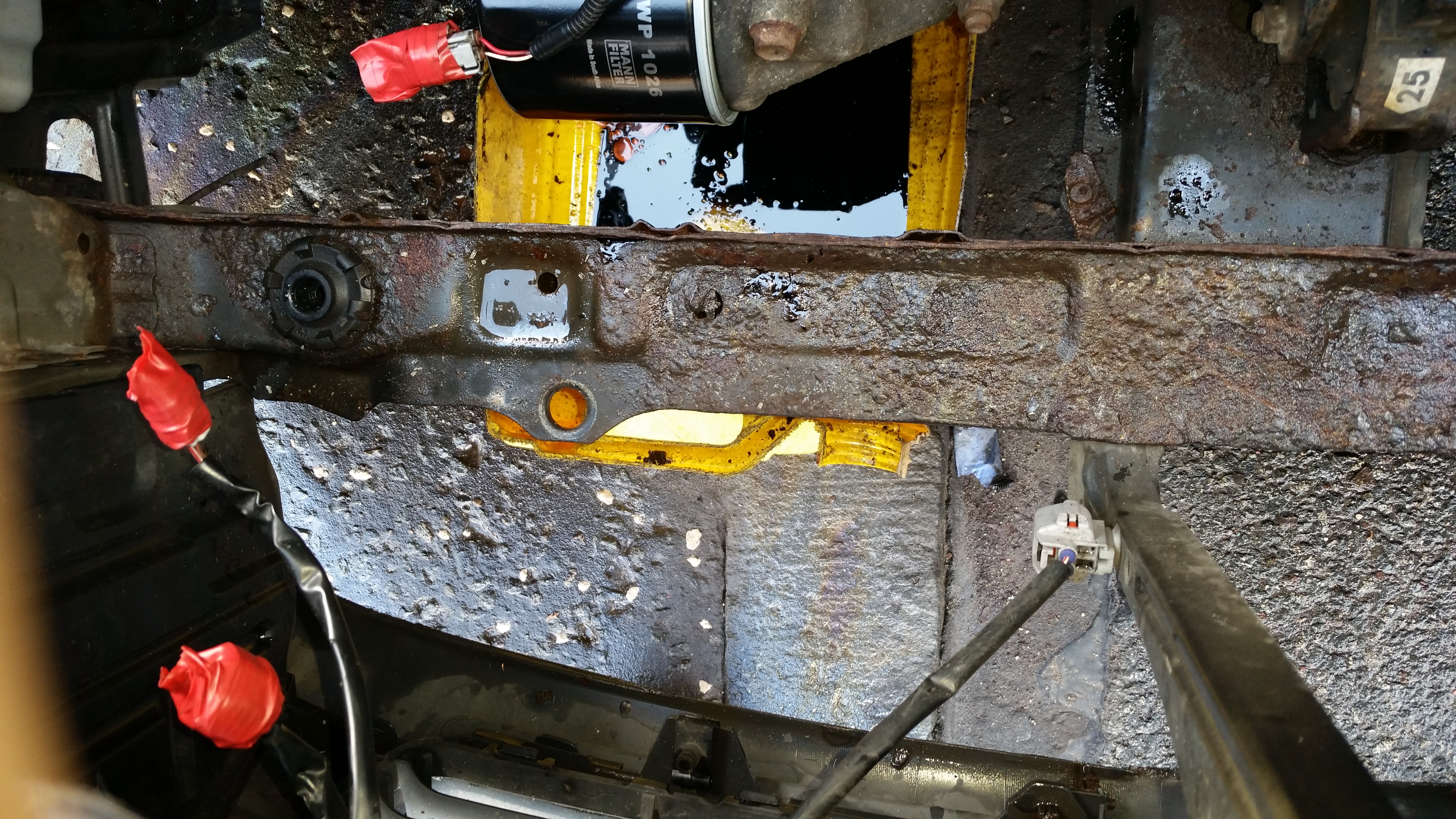

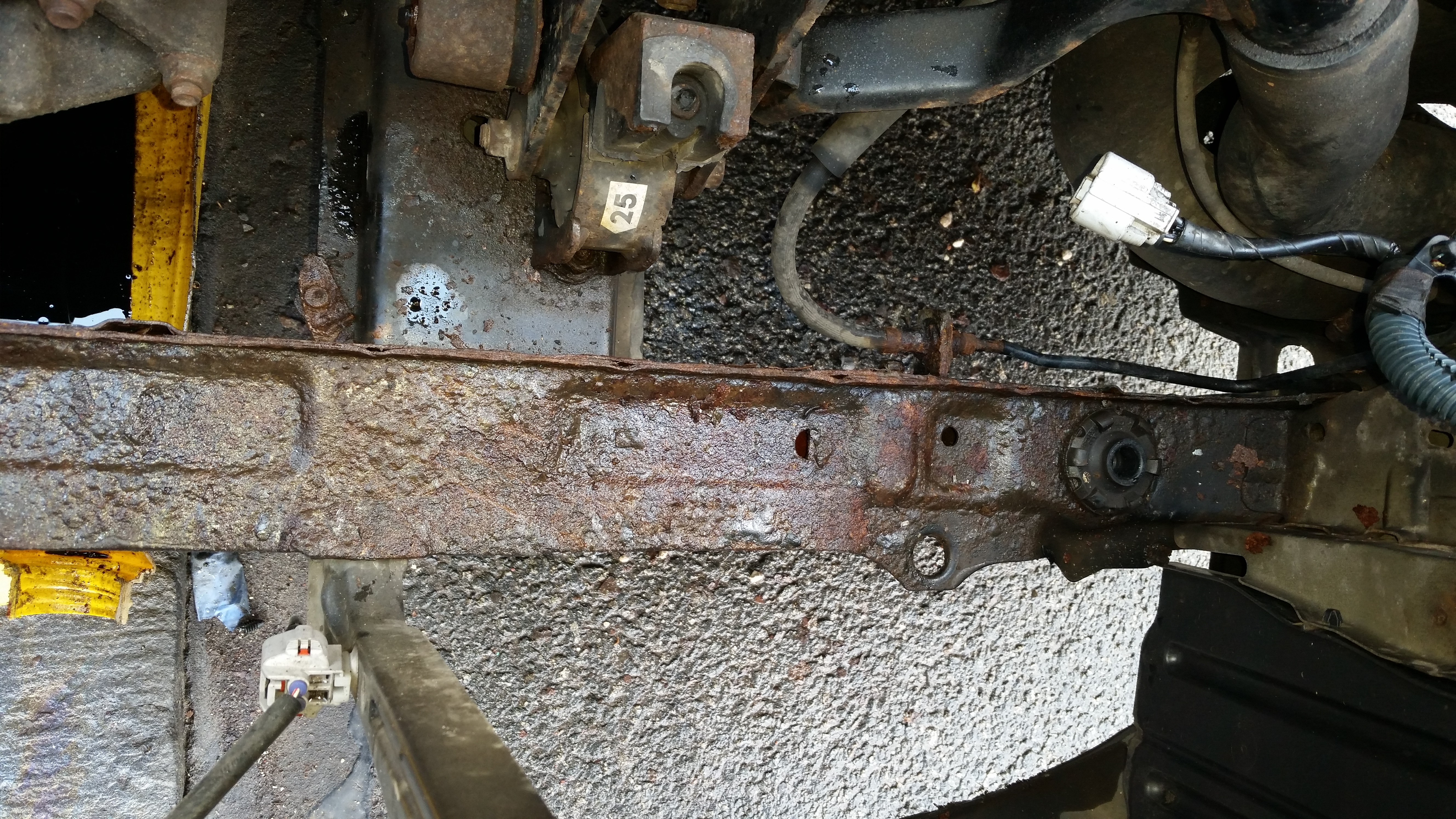

since photo have pressure washed and painted black hammerite to cross member as surface rust visible ( looks worse in photo ) my car is one of first of this model (53 plate)

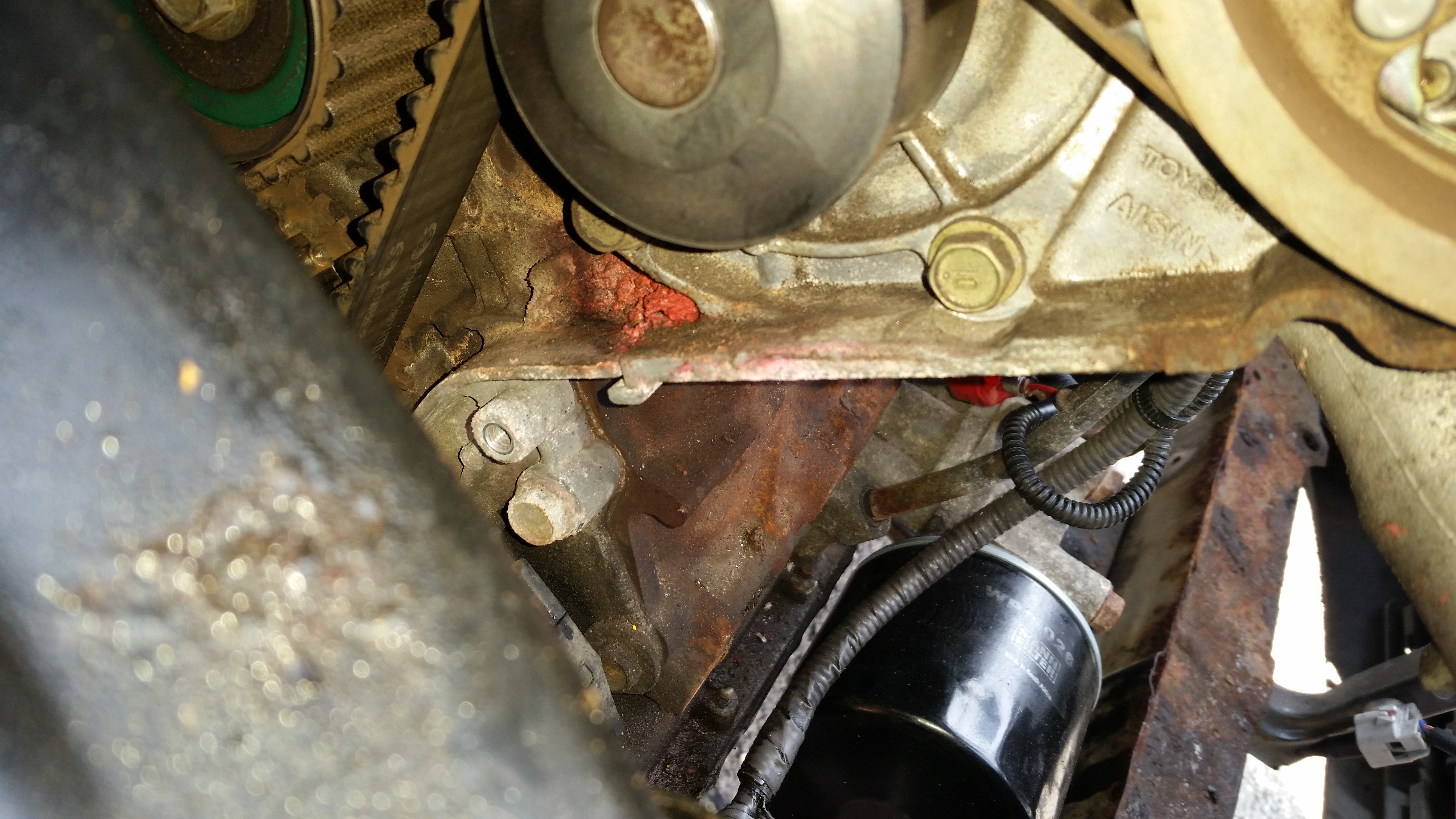

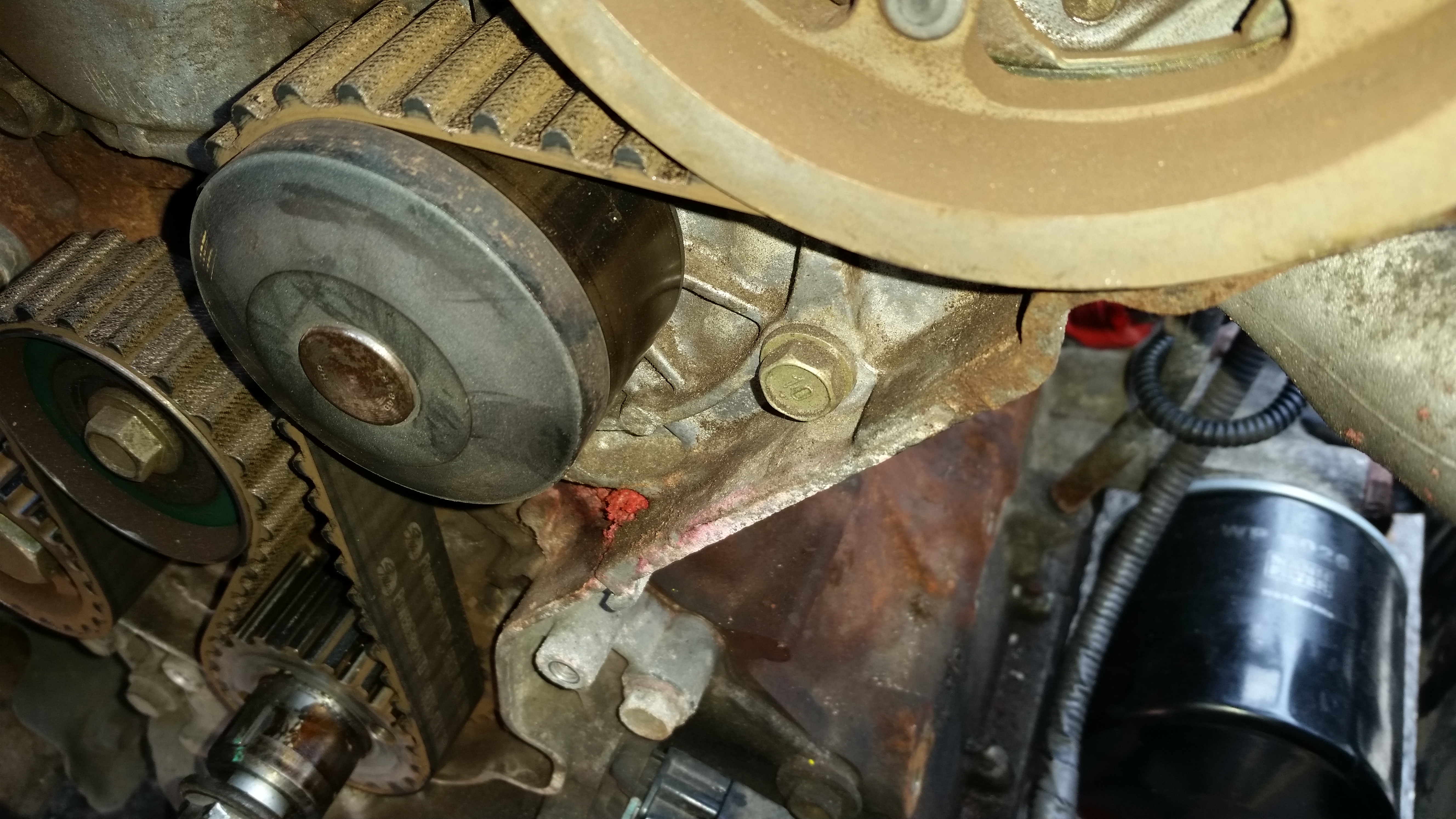

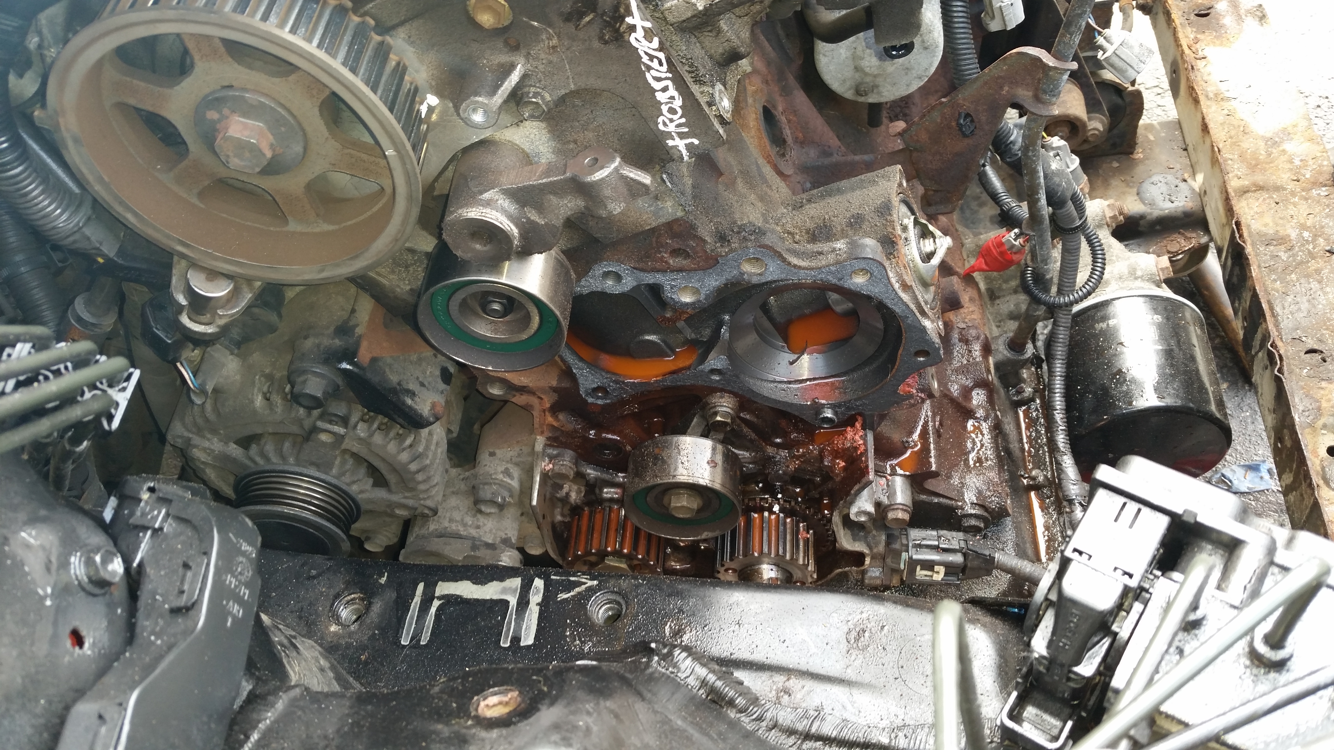

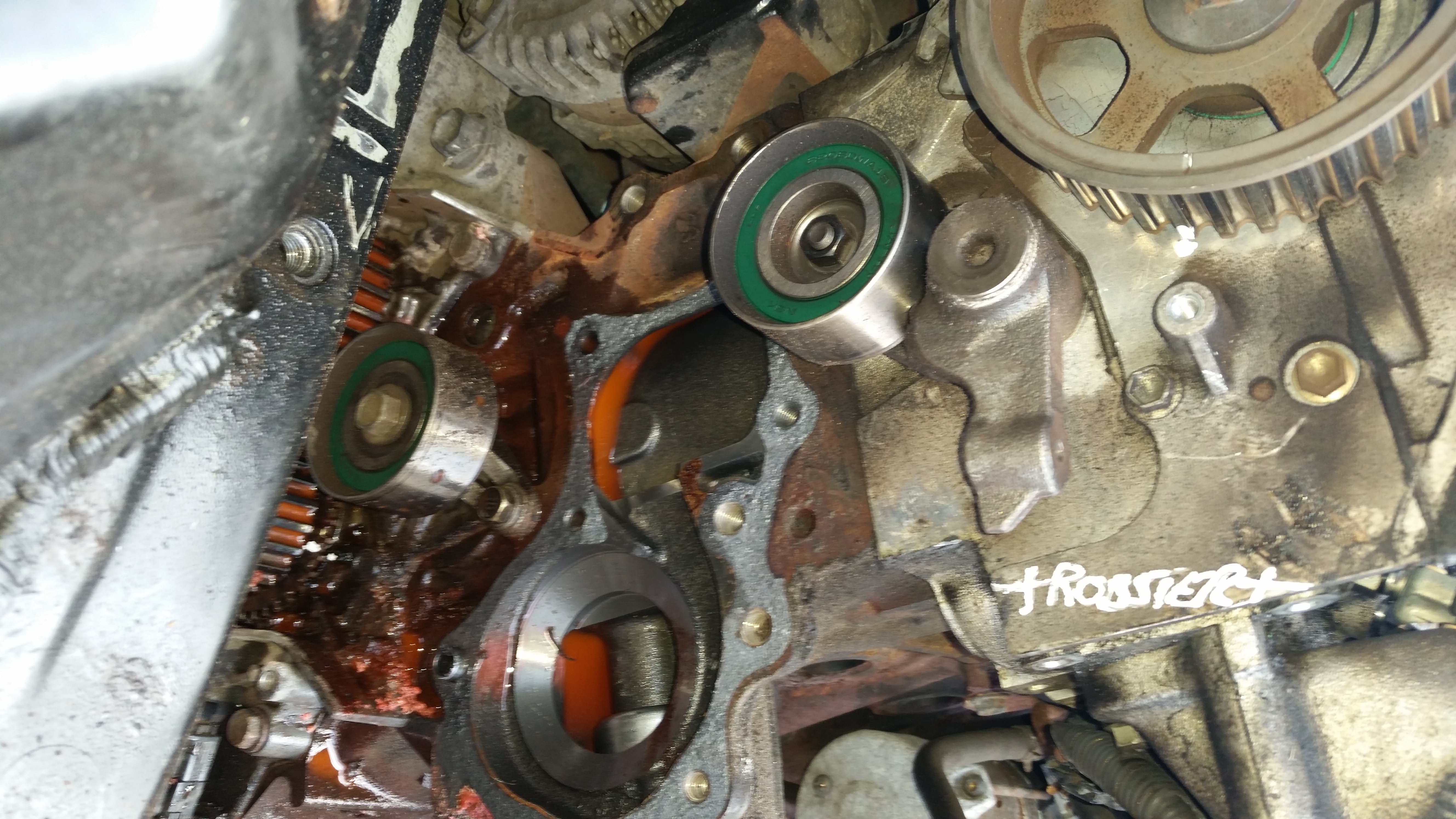

just some pics of the tear down
where pump is at and whats attached

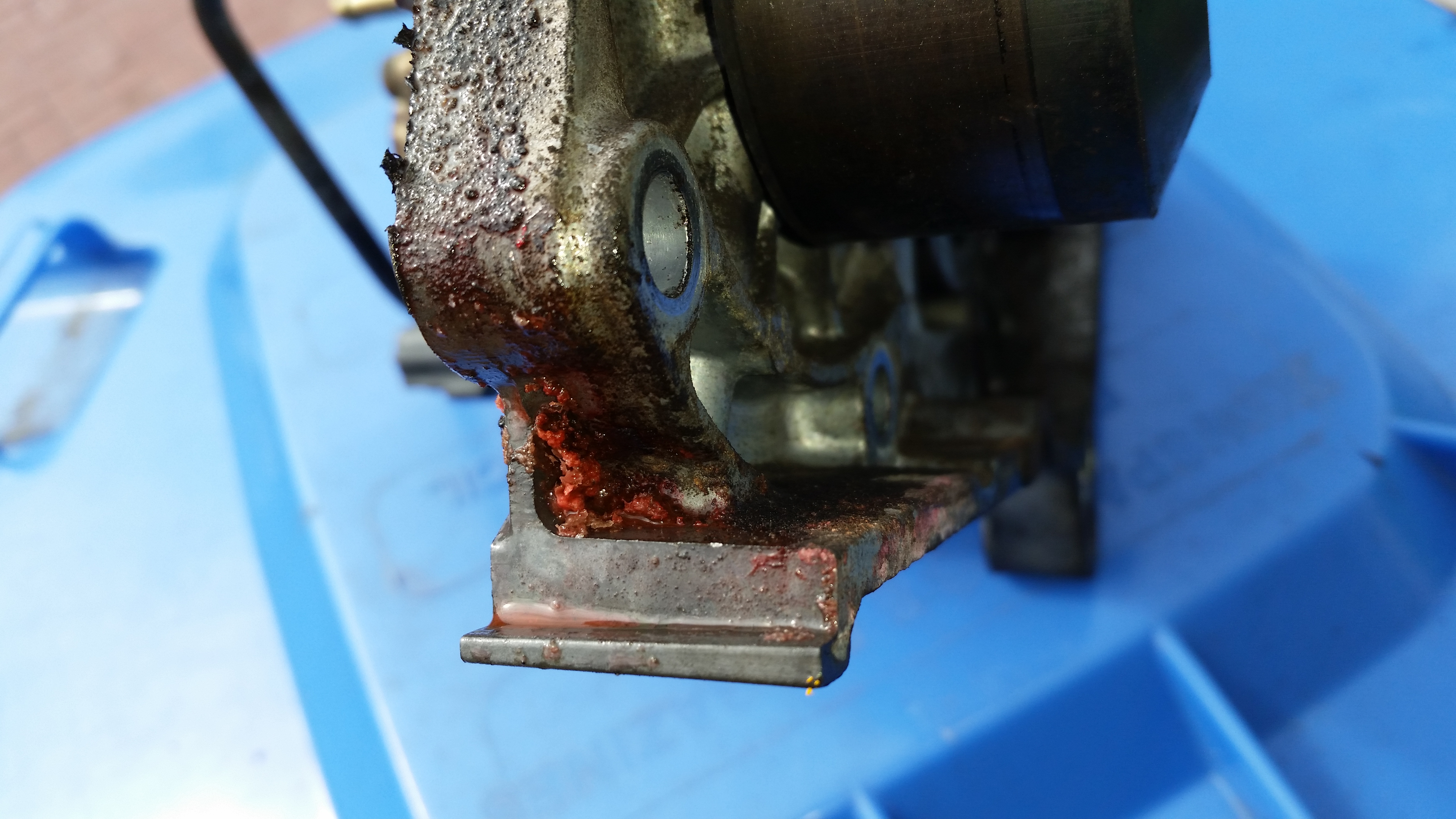

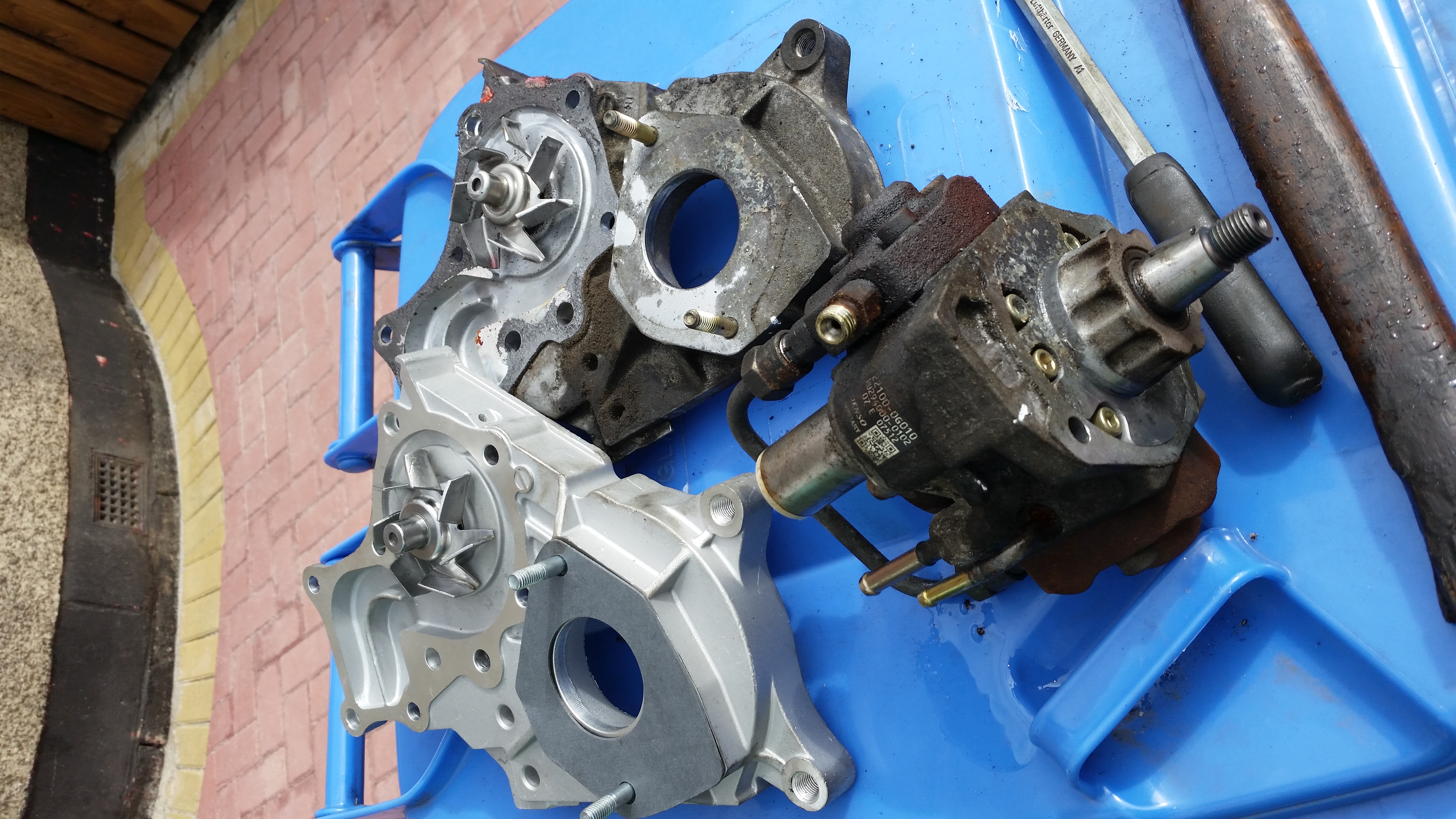

signs of pink crystallization on removal of covers so got it in good time but would have trundled on for a long time I think maybey a couple of years providing coolant was checked regularly

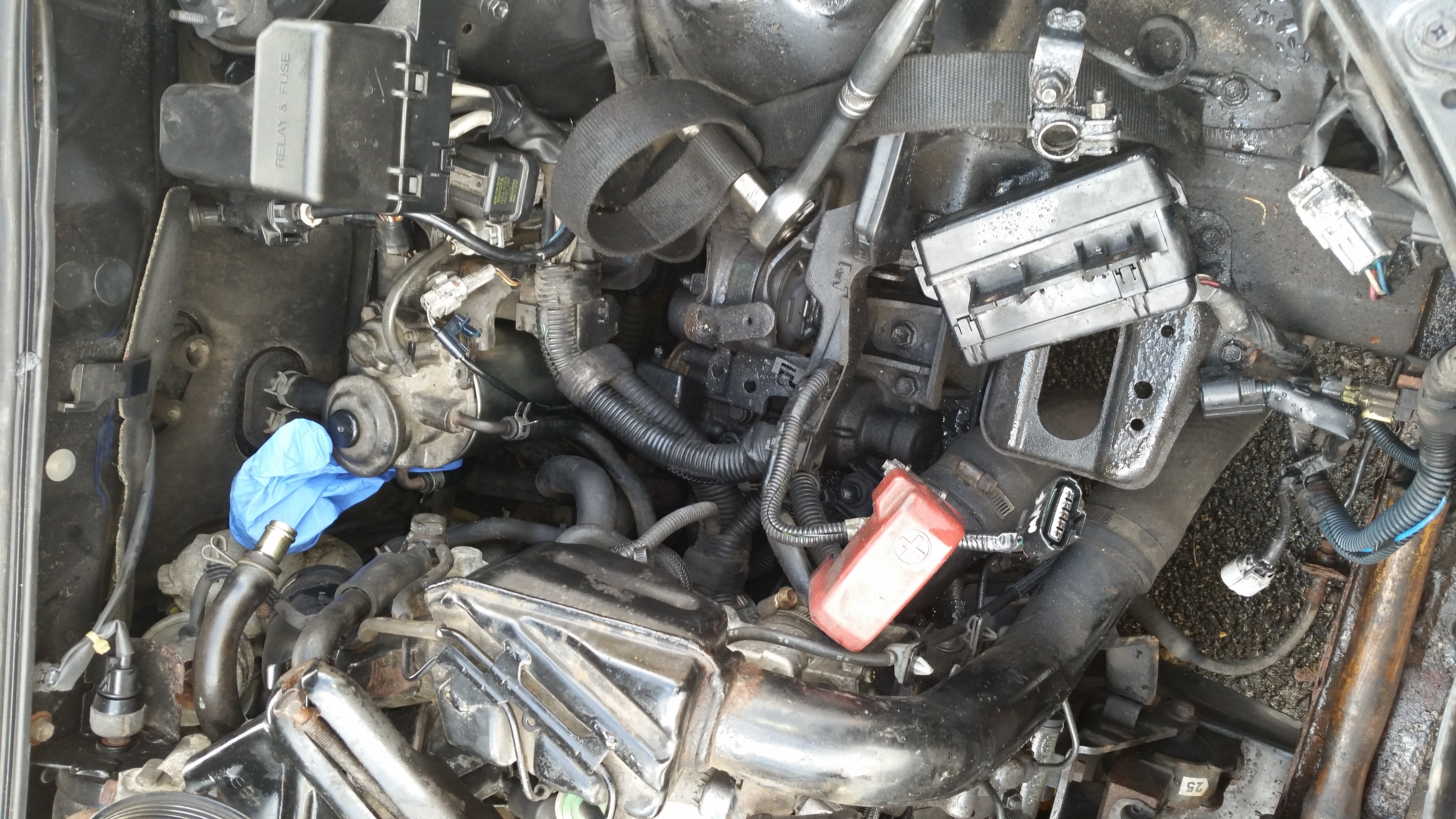

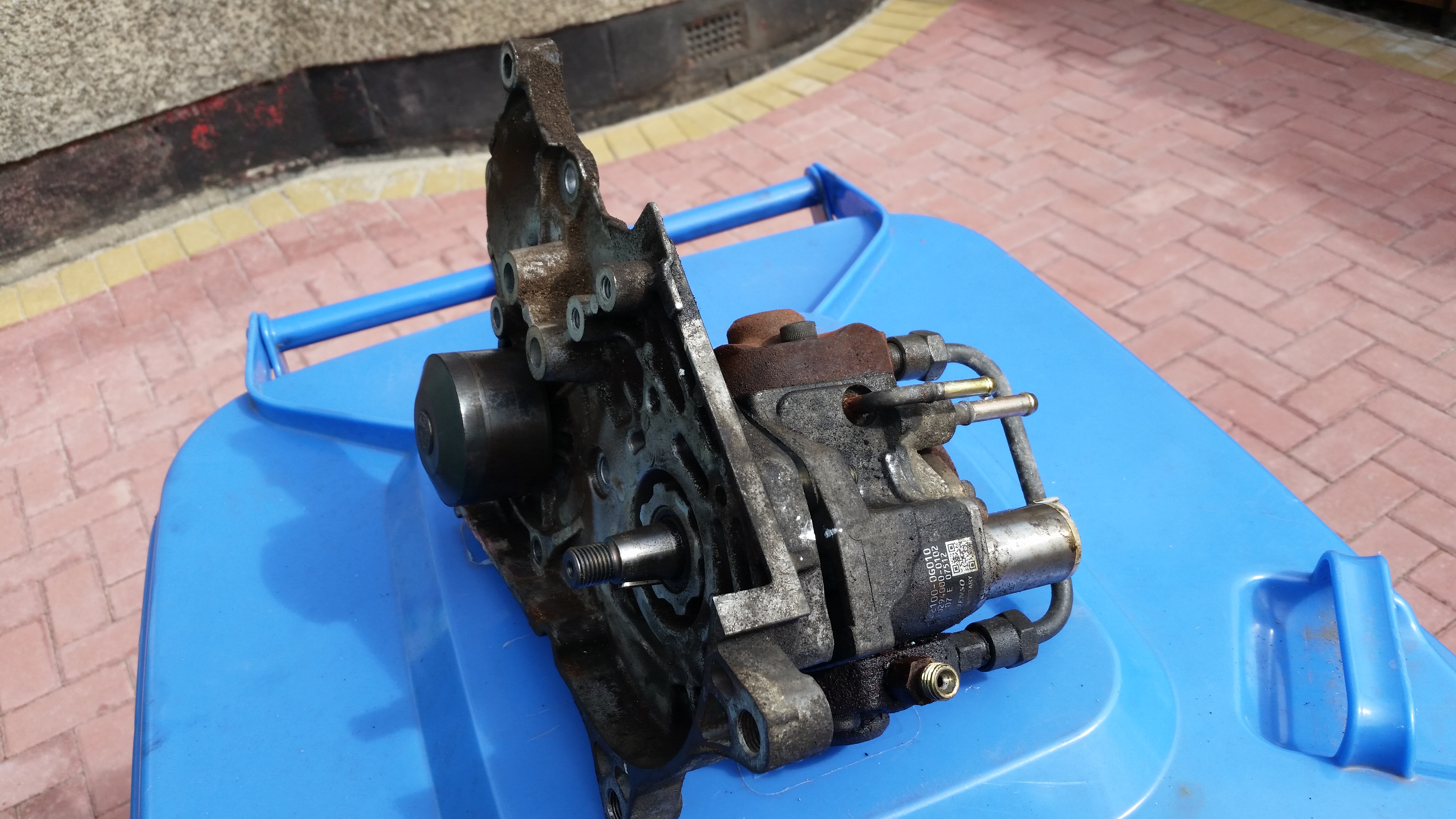

this is one of if not the mentalist waterpumps ive done ( I  work on plant equipment )  saying that ive had some tight ones working upside down and also through a mirror to do pumps and belts but you know what I mean, - never had to take a high pressure pump off to do one before

oh yeah on old pump removed found a slight loose rumble at bearing when testing, this was original pump on a near 13 year old car at 102k miles so let that be a gauge for anyone else for future reference on this model engine
last picture bin full of old aircon and waterpump

I bought a circoli pump this came with a thick gasket for between high pressure pump and pump casing. This caused my fuel pump pulley to rub on pump casing when i bolted it down. I had to ditch the gasket which isnt totaly needed anyway.this solved my problem.
