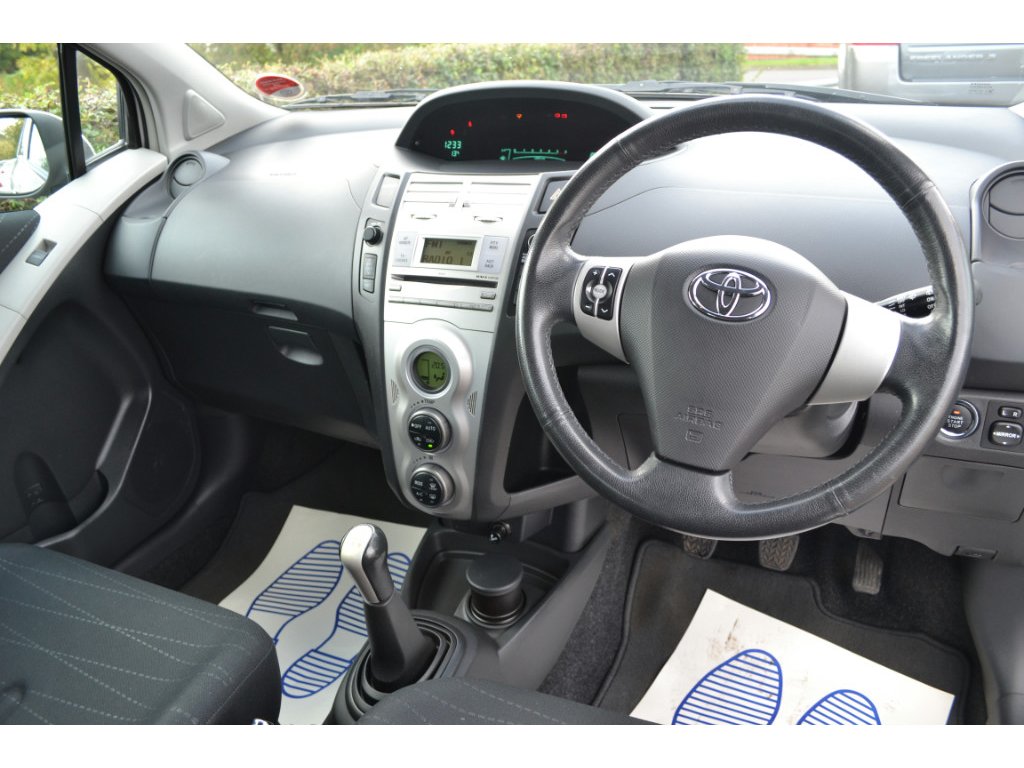

Hello all,
I own a 2007 1.4 D4-D Yaris.
There is a musty smell in the car which I think is coming from the a/c drain. Usually after a run with the a/c on a small puddle appears under the car that shows that the a/c is draining as it should. These puddles do not now appear which suggests that the drain is blocked.
Can somebody please tell me where the drain is so that I can clean it? Are there any how-to's?

The drain is situated in the passenger footwell, you can access this with the car mat removed and then by peeling back the carpet from the uppermost right hand corner in the footwell. This is best achieved with the passenger door fully open and by lying face down, once peeled back you will notice a black rubber pipe disappearing into the floor/bulkhead, unplug it from this point. You can then spray a dedicated disinfectant up into the system from there.

Yes, give it a gentle squeeze before unplugging it from the floor/bulkhead. On the Mk2 Yaris the pipe runs from the bottom of the evaporator unit (from behind the center console) to the floor/bulkhead, you can't miss it if you peel back the carpet  R/H side of the passenger footwell.
Hi Stan,
I found the pipe and it was as you say in the top right corner of the passenger foot-well (this would be for right-hand drive cars).
I squeezed the pipe and didn't feel anything so I pulled it out of the bulkhead hole. I would say it's about a half an inch in diameter and about a foot long.
