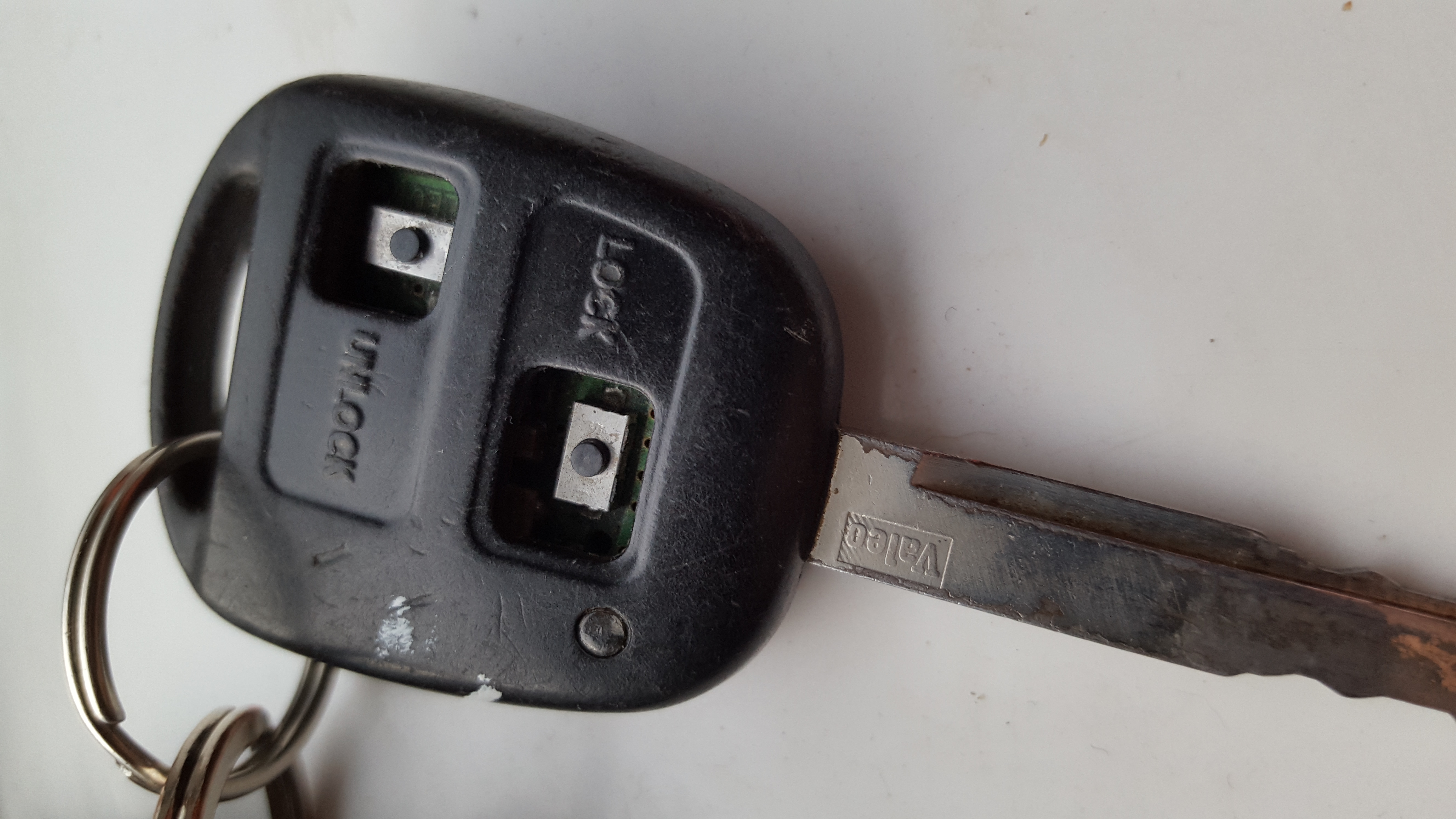

Hi group. The Avensis I just bought came with one key only (pictured) and has locking buttons missing. I'm worried that I'll have trouble getting these and reprogramming them?
The manual says the keys should come with a number plate to be retained for this purpose, but I don't have that also.
It may be a connected issue, but the central looking fails sometimes. Any help appreciated.
The simplest thing go on eBay and get replacement key fob buttons for 2000 Avensis. Next resync the key to the car to get the remote central locking working again. It is detailed in the manual if you have it, but just in case:-
If that works, then get another key from an auto locksmith. You could go to Toyota but it will cost a lot more.
