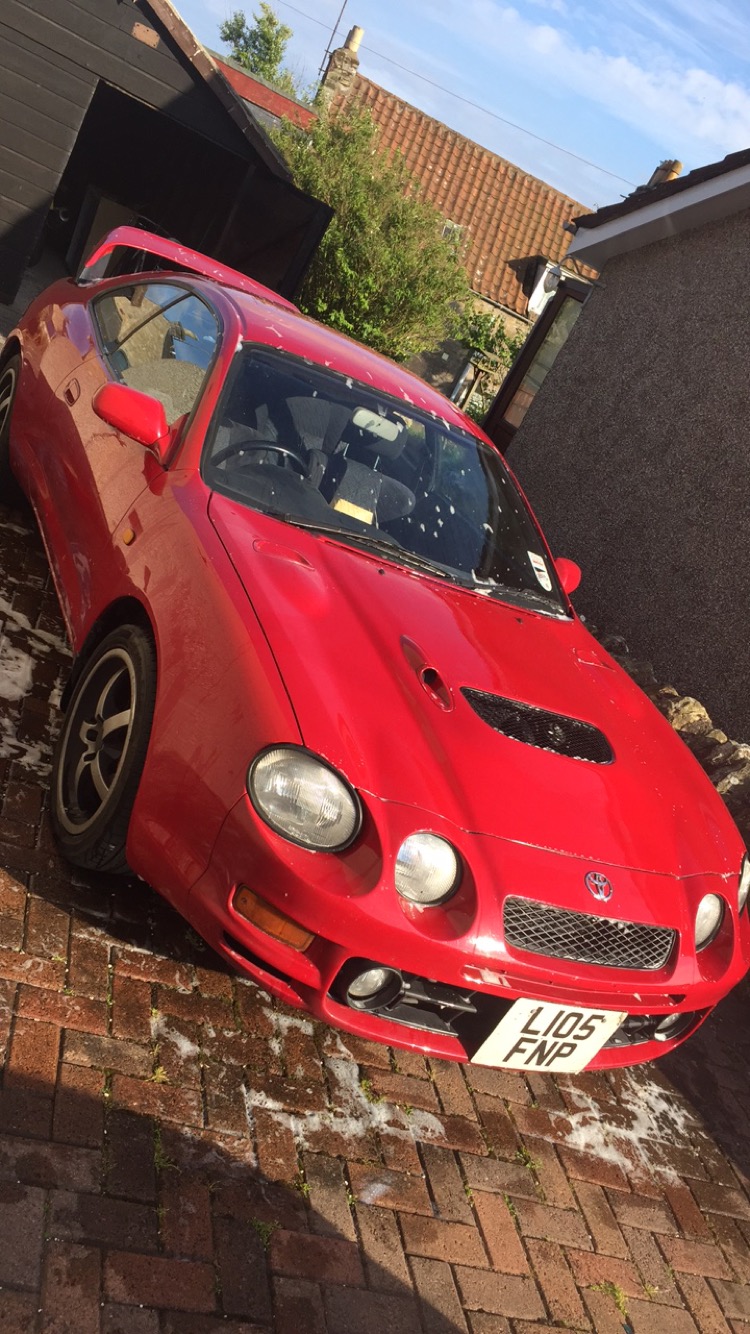

Hi all,
apologies in advance but as you may tell I'm new to this. Recently bought a Celica GT4 ST205 (shes a beaut!). Anyway, I had a long drive, 400mile round trip to see the parents and on the way back the engine management light came on. I ran the diagnostic test and got error code 54. Found out im leaking coolant all of a sudden and at a rapid rate 2L overnight. Ive found a wet patch under the hose to the left of the coolant tank (right at the bottom almost touching the undertray) but to the right of the radiator itself. I cant find an engine bay diagram anywhere. Ive ordered new hoses for both coolant and radiator, once fitted do you think this would rectify the problem or should i look for something else
