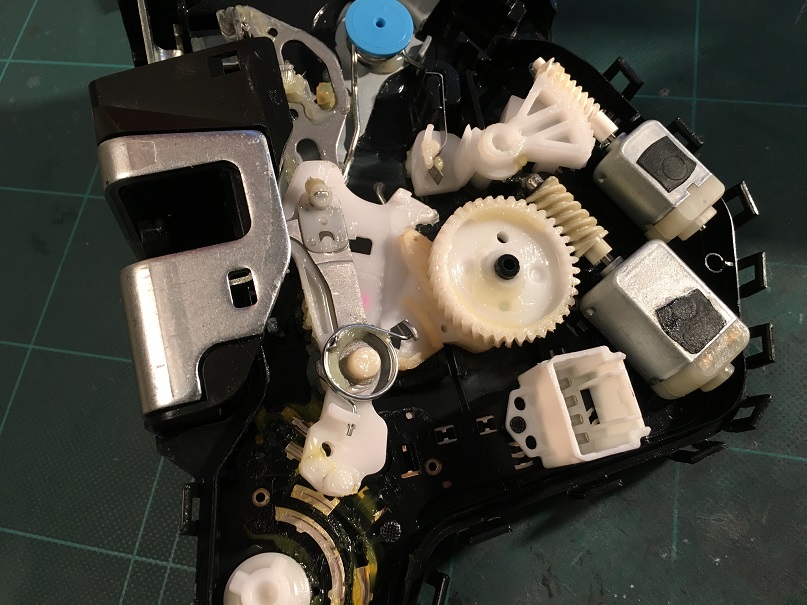

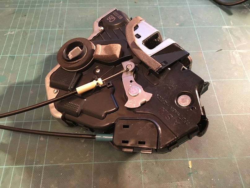

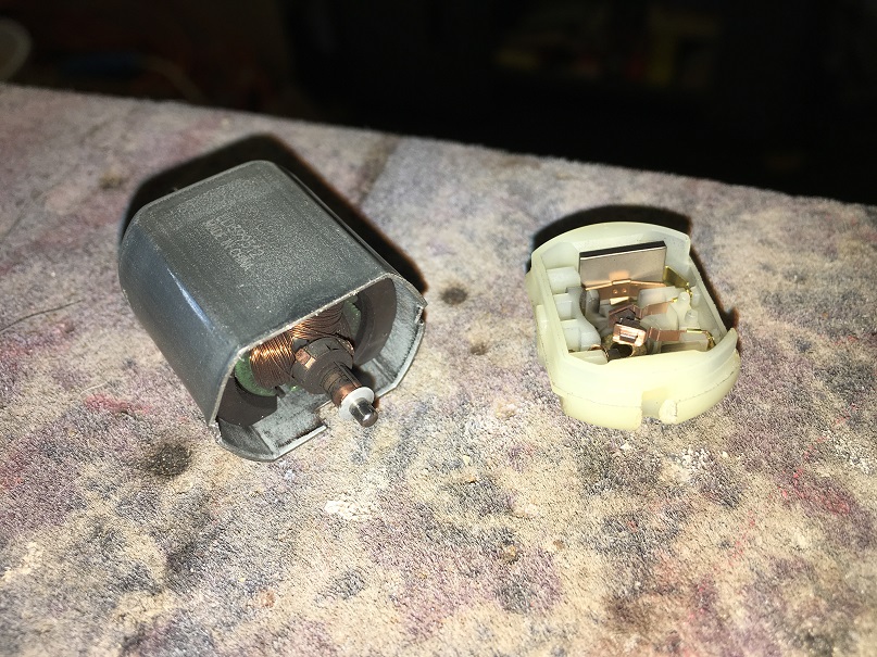

I stripped out the lock mechanism from the door and pulled it apart to find it all looked fine inside but the motor that actuates the lock was very dirty and basically, worn out. A couple of new motors from eBay and it's as good as new again. Strange thing is I sorted the drivers door then only 3 weeks later the passenger door started doing exactly the same thing! Good thing I bought two motors.
If you try this you may have to swap over the wires in the plug that feed the motor, My new motors span in reverse to the original ones so when you locked the car it unlocked and vise versa. Simple thing to swap over the cables in the plug though.

Thanks for the help. Did you have a parts code or a link to the motor that I may need? I see in you pic there is two Motor on mechanism, Is it best to replace both?
There are two motors in there but I only replaced the one, bigger motor. The smaller motor operates the double lock mechanism. On my car you press the key fob button or the door handle twice to operate this one so it seems to get used less and last longer.
It might be worth taking the lock out first to make sure you have a similar version to this but I ordered these.
http://www.ebay.co.uk/itm/401045934052
They are supplied with a longer, completely round shaft and the Toyota ones have a shorter shaft with a flat so you will need to file the flat then cut the shaft down a bit to suit the worm drive. Getting the housing open is also a bit tricky as you have to undo about 20 clips to get it apart.
It sounds and looks complicated but is possible with fairly basic tools.

Thanks a million! Did yours make a sound like it was trying to unlock? I think it does it 3 times (sound and flashers) and the  sound when I do get it unlocked is more "clunky" prosumably because it actually has unlocked.
Yep, Exactly the same, tries three times then stops unless you try it again. It knows somehow that it hasn't unlocked / locked so tries three times then gives up. The sound is softer when it fails too as you describe.

In the last pic the moter is apart and seems to lack a shaft?

The last photo is the back of the motor showing the brushes and all the black carbon in there, the shaft is there but sticking out the other end.

Similar but the lock may differ depending on what car you have. In that video his motor seems to be housed in a separate part of the lock whereas it's inside the main lock on my iQ.
Once you have the lock out the door you should be able to see what it's like and hopefully figure it out from there.
I have to loosen the widow runner with a single screw and move it out the way but once again, that will depend on the car in question. Hopefully it won't be too complicated to remove.
