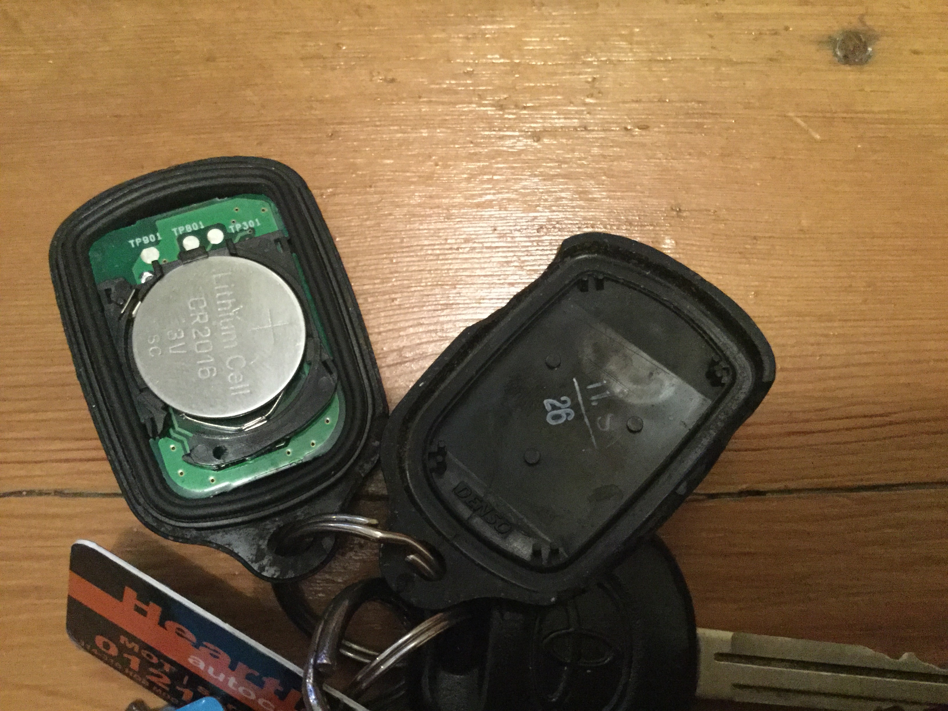

I bought a CR2016 Battery for it, and I popped the case open and the old Battery just fell out. I put the new one in but it seems loose. I also don't see anything holding the Battery in from the top. To me it seems broken, but I could be wrong. Im not adverse to soldering - I'm actually soldering one of these batteries to an old 1992 laptop tomorrow - so I can fix it physically.
So, I'm just wondering am I right to think there is something missing at the top? Also, do I need to reprogram the fob? It's for a 1998 E11 Corolla.
Heres a photo of what it is I have.

The Battery holder is broken and that would explain why the Battery falls out. If you are handy with a soldering iron it shouldn't be a difficult  fix.
Maybe you can find a similar remote on eBay and use the Battery holder from that.
Thought as much! Am I right to think that the missing clip/wire touches those 3 pads on top of the Battery?
i might look for a key fob for it. I've got an old motherboard from a computer with a holder on it I could canablise, but if a replacement fob is easier then I'll do that.
Hmmm.....I don't think its broken as such, the +ve is at the bottom and -ve is the sides as per your pic. There is a prong at the bottom (gently lift it up a bit)and there is another on the side for the -ve (marked red), gently bend them a bit so that they are pushing the Battery to make contact, there's nothing on the top I don't think.
