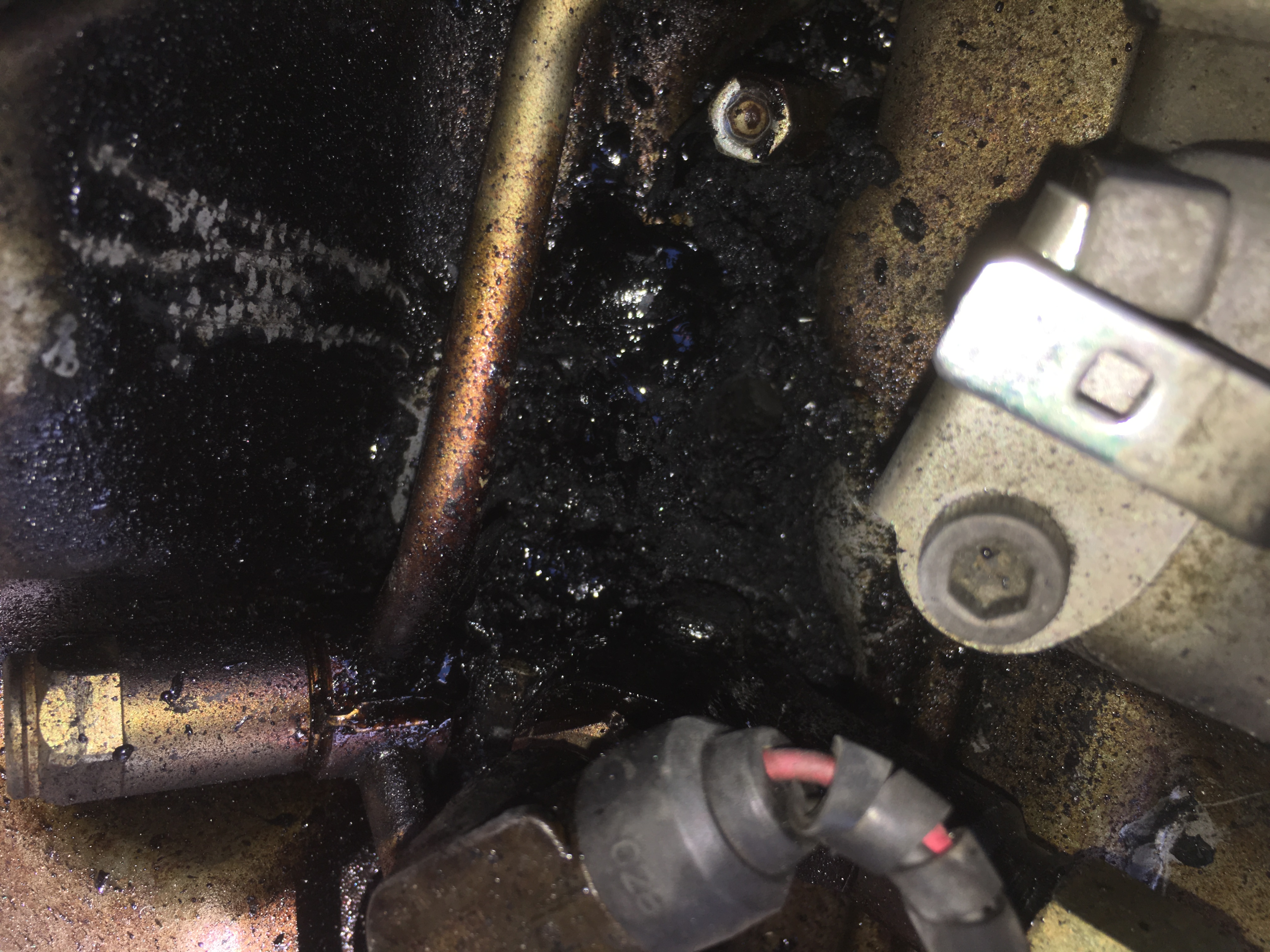

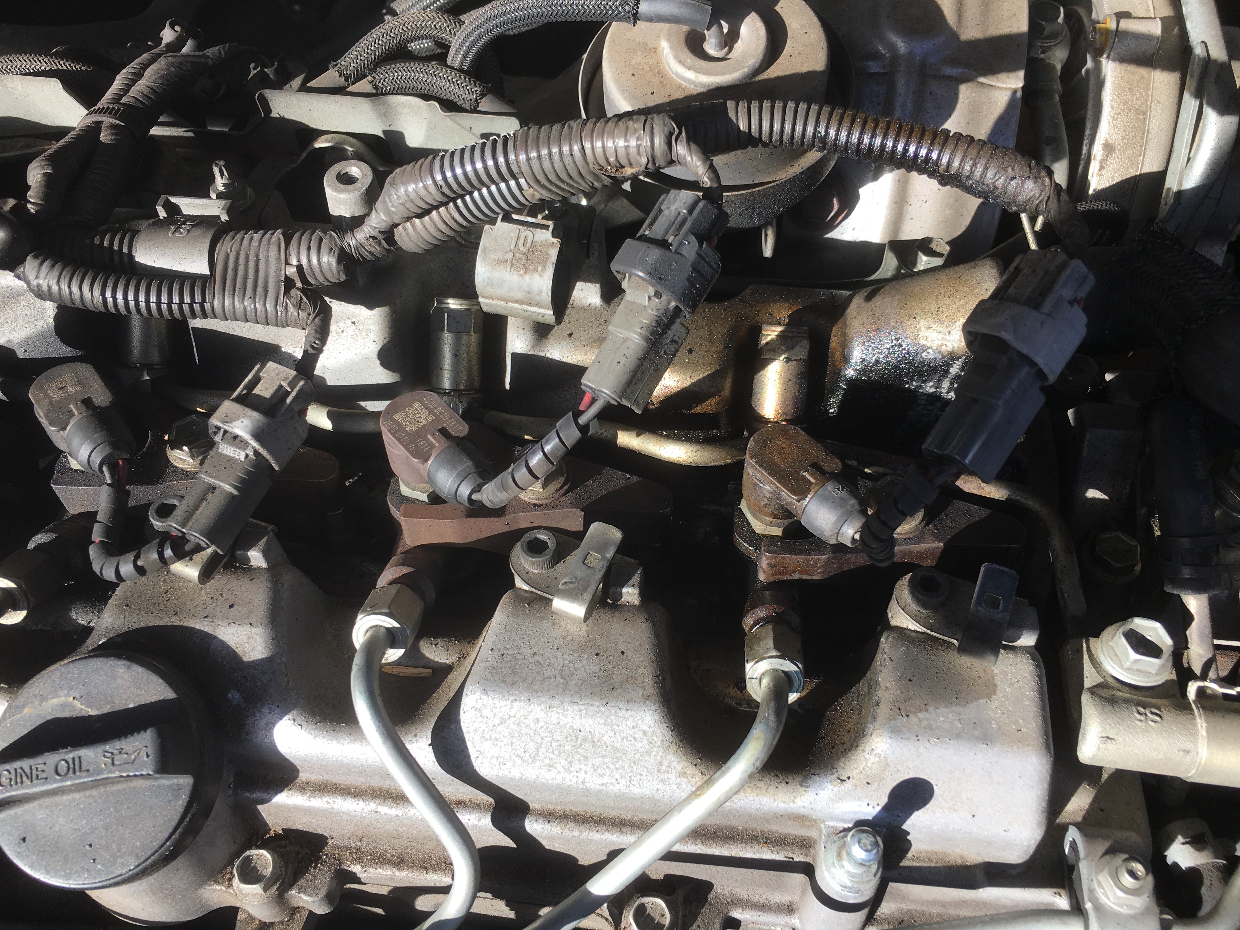

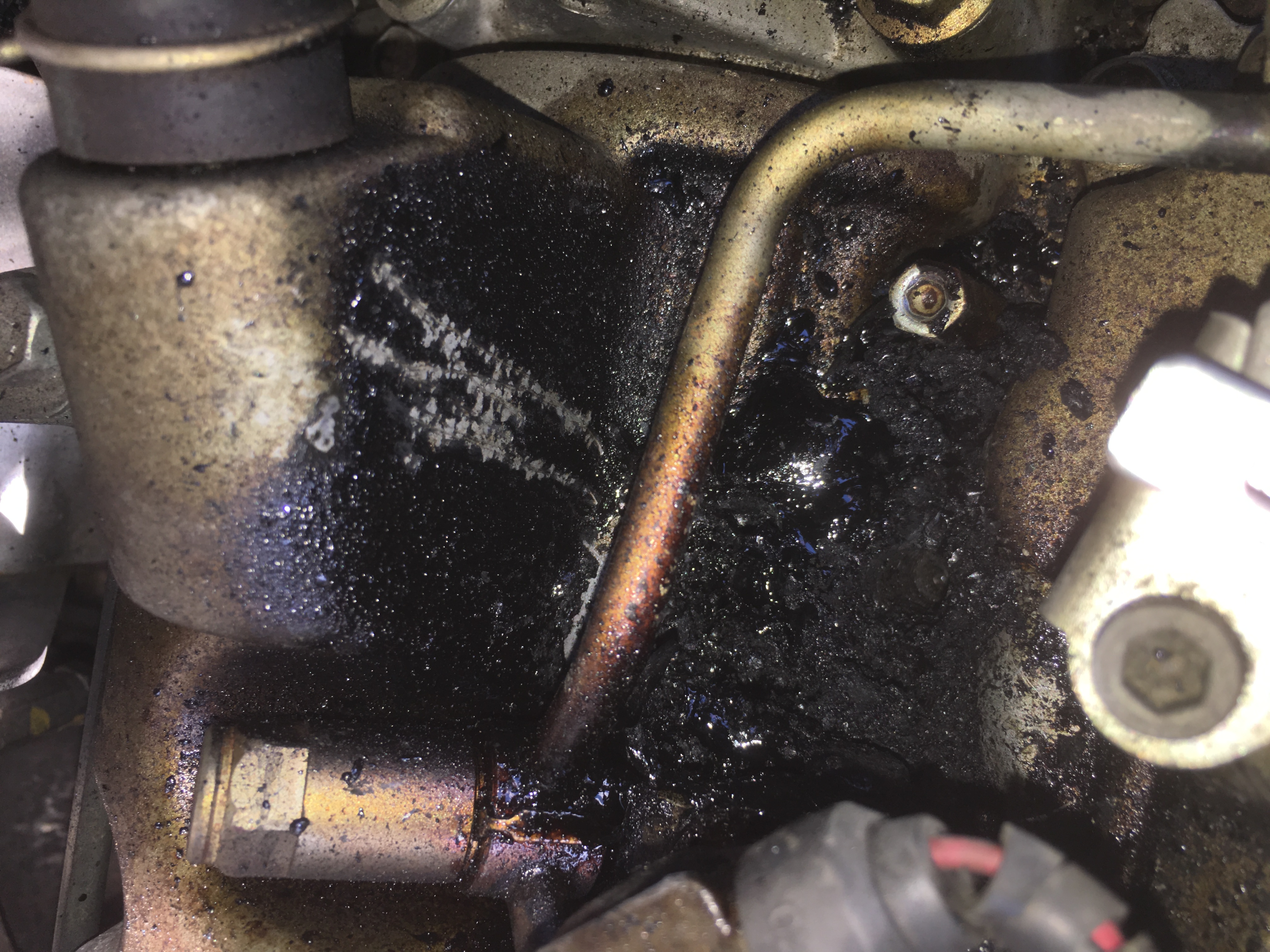

I have issues with an injector leaking gases, I want to remove the injector any tutorials on here. there is lots of carbon deposited around the injector and i,m guessing it must have been leaking for a while, no loss of power so bit strange, I see two other injectors are also starting to leak as I can see carbon deposits.
do these injectors sit on some kind of seat and thats why it's leaking from the underside of the injector!!
any helps would be appreciated. I will try and add a picture

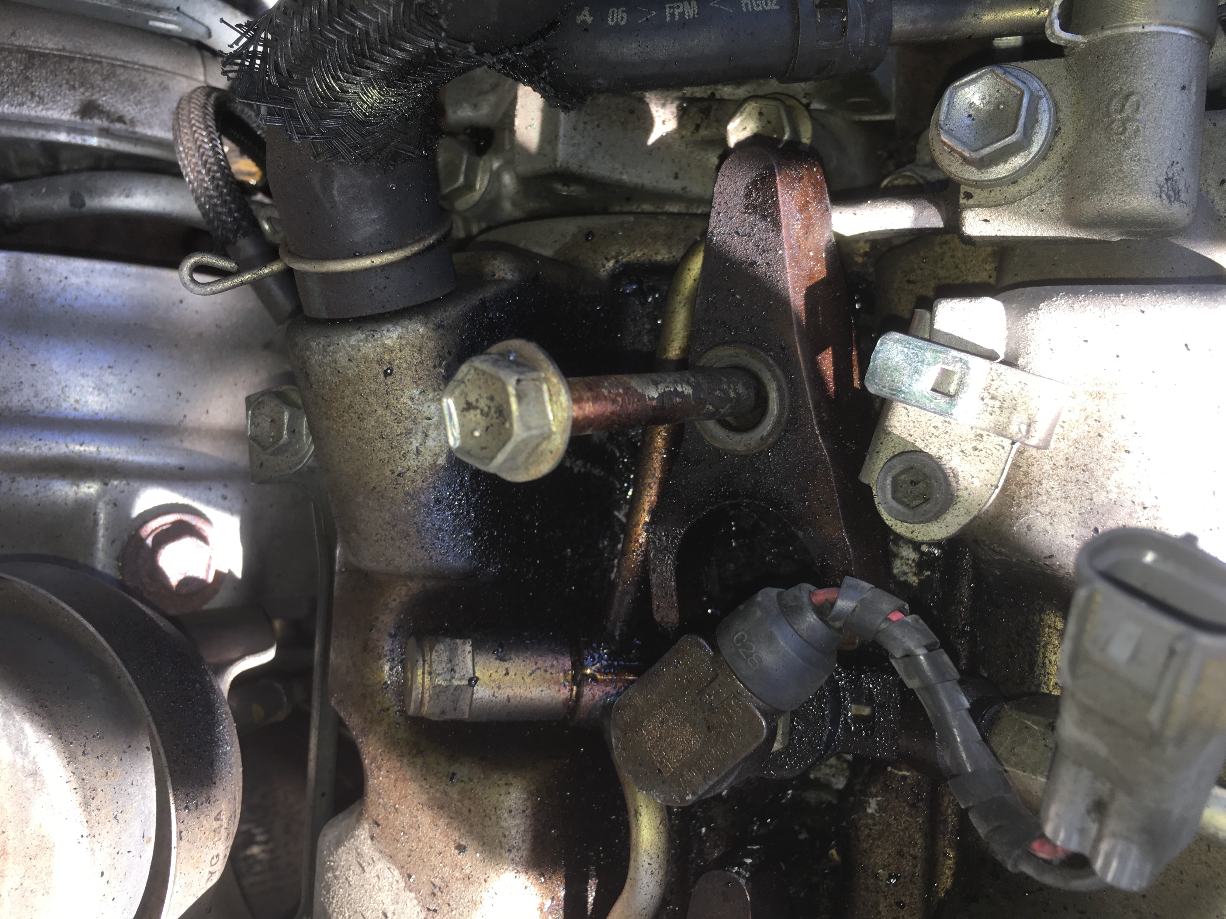

So I got the leaky injector out. But there is always a but the brass seal is stucknin🙁
I have managed to get the second leaking injector out. Caught it in time and the seal popped out easily.
The other two injectors are in solid😭😭😭😭
