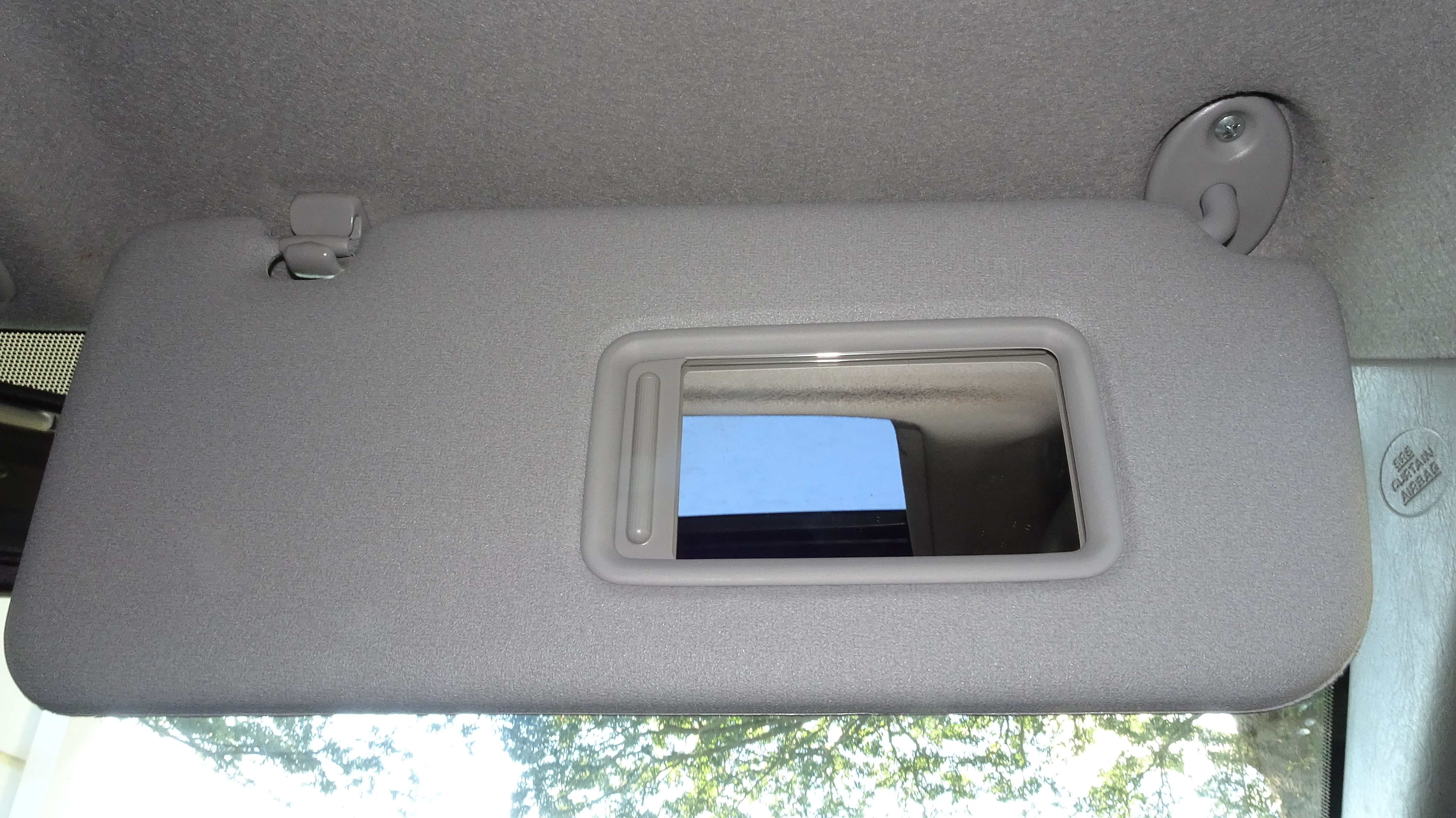

New RAV4 2005 owner here.  I have the same driver's side visor problem, and have just got a reasonable price solution (well, comparatively reasonable).
I have fitted Part No 74310 - 42330 - B0.  The only differences to the original (74310 - 42360 - B0) are:
The mirror does not have a light (not something I care about) and the warning messages are written in Japanese.  This is a JDM part, so I looked up a couple of Japanese suppliers - prices low, but freight charges high and you'd probably get hit by customs.  Just for a laugh, I asked my local Toyota dealer, and he said he could order it.  He got it in three days, so it must have been held in some central store in UK - impressive.
It's brand new, of course, so looks just right (same grey colour) and works perfectly.  There are at least two other colours -  74310-42260-A0 in ivory, and  74310-42260-B0 in light bluish grey, but I don't know if those are stocked in UK.  Link here
EDIT:  Forgot to say price - £40.52 plus local (Jersey) 5% sales tax.  I guess that would be 20% for mainland residents.

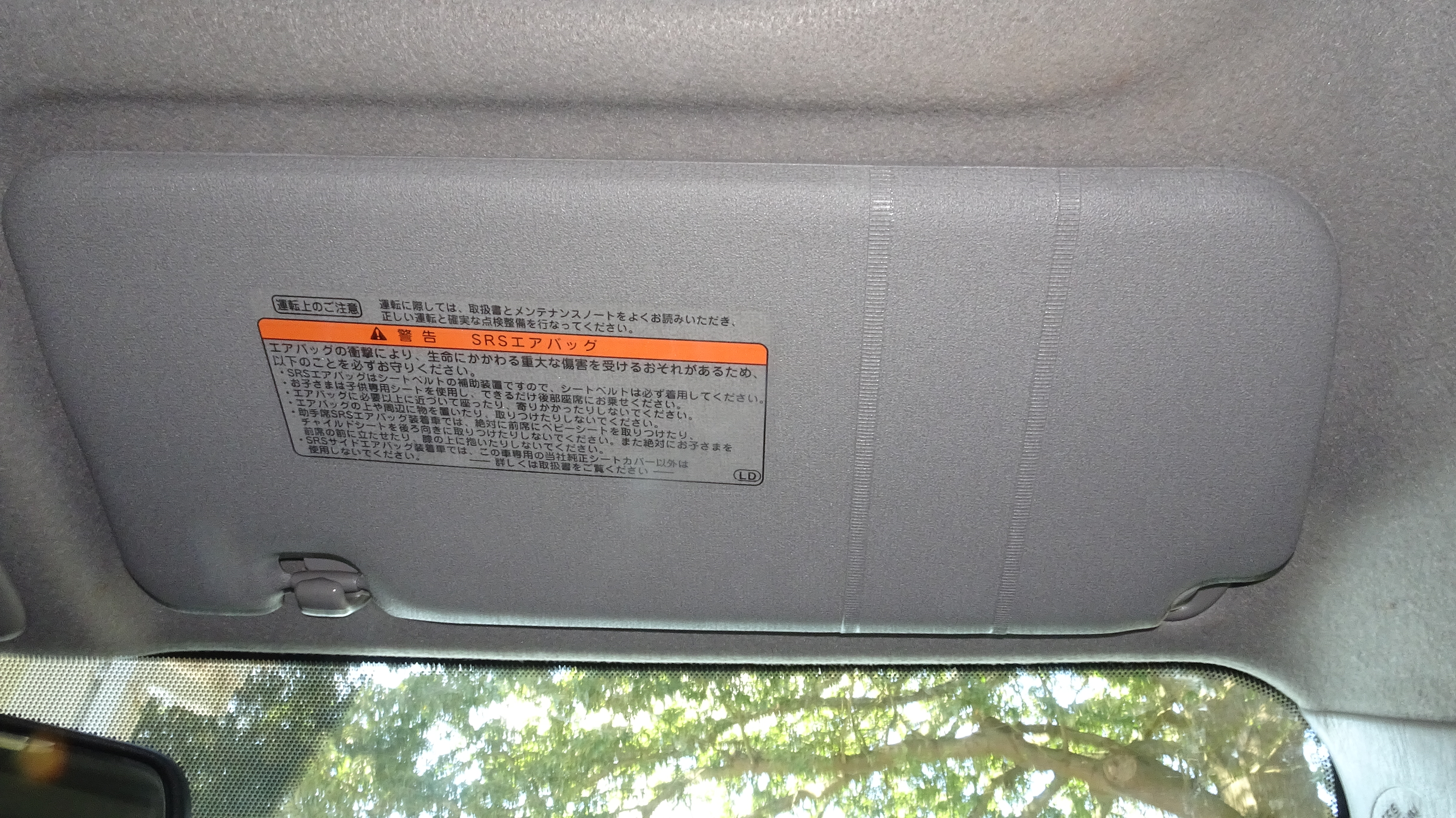

If this is true then it sounds like the holy grail of RAV parts solved if it comes in at anything under £100! Don't know if you can post a picture for everyone to compare it but does the replacement look like this (same fitting etc.) - I've got a 3dr RAV4, think it's the MK2 facelift 2005 (with the round driving lamps in the bumper). If this is the same visor but without a light then I'm definitely phoning my local Toyota dealer to find out if they can order the part!
It looks exactly the same (size, shape and colour), only the light and the white plastic plug on the securing fitting are absent.  It is  secured exactly the same as the original - the two screws - just use the original ones.
My car is also a 2005 with round foglamps in the bumper.  Its a 5 door (ACA21), but, as you can see from the link, the part fits ACA2#, so that includes the 3 door (ACA20).

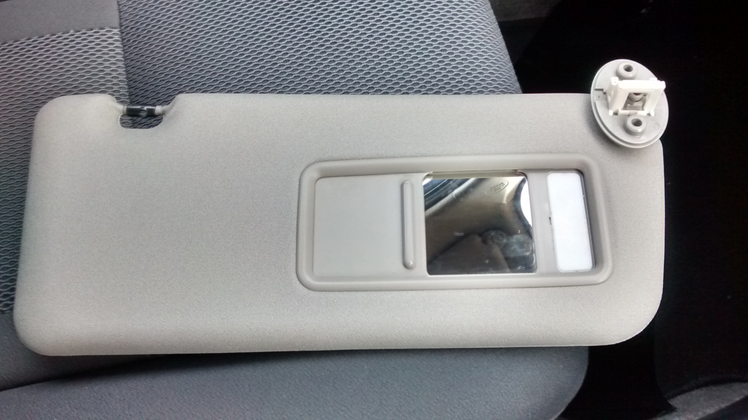

Ended up buying one from a US seller via eBay - although slight mix up.   It was actually part 74310-42370-B0 that was listed although did say it was without the mirror light for Rav 4.
Turns out it fits fine, although a little thicker and has a plastic slide out panel on left side of visor.   Not sure what that's for - perhaps to block rear view mirror if sun is low from behind?
Oh well, does the job.
The sliding panel is probably to extend the visor rearwards when it is swung across to block the light from the RHS.
