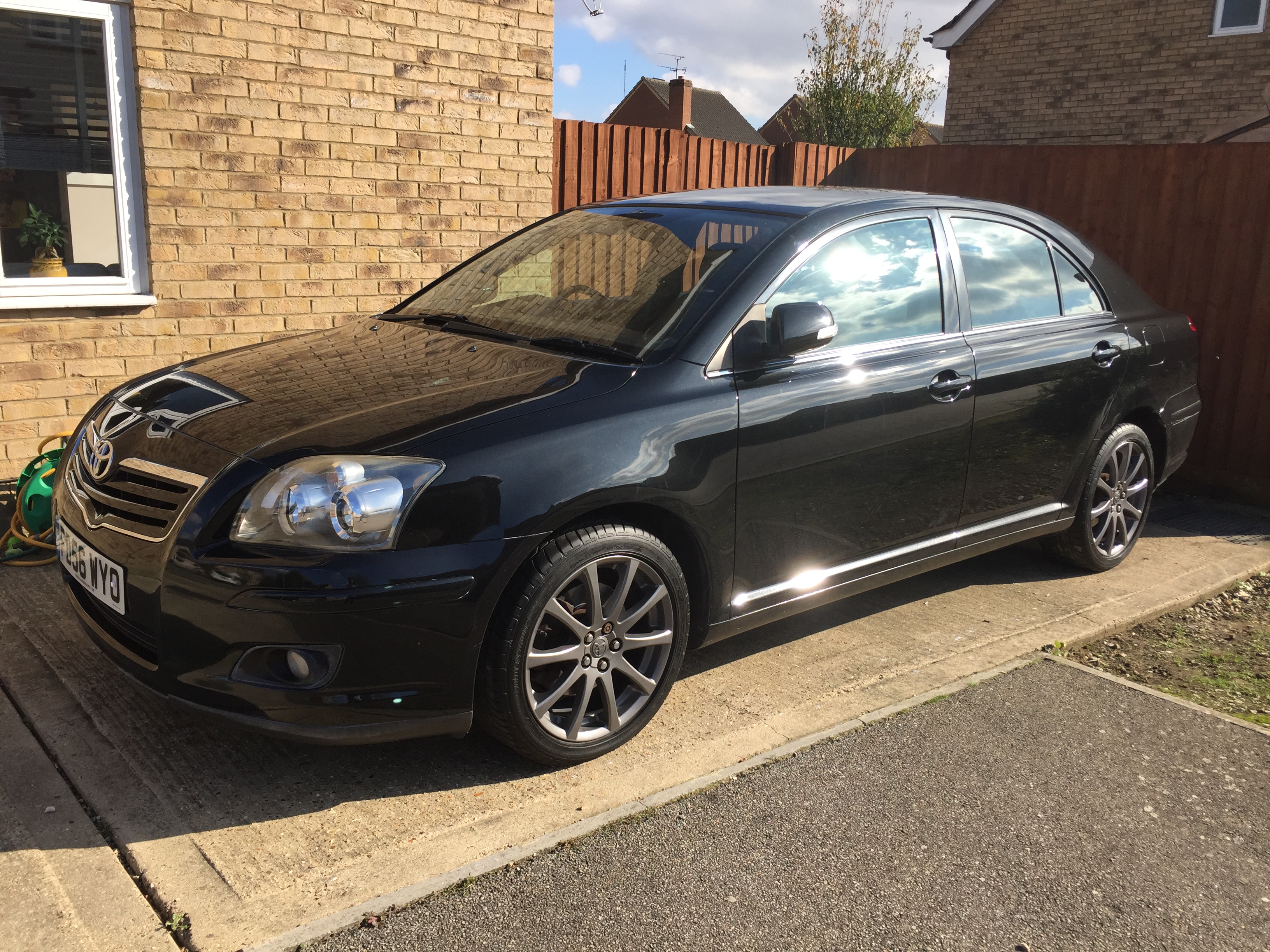

Hi all, a while back I had a starting problem  and tried several different cures, so far I have replaced the fuel filter, run some diesel injector cleaner through and replaced the scv valve,
i have noticed the following.. now the weather has got colder i.e.. 10-13 degrees in the morning she starts fine and goes into fast tick over. If I don't start first thing and the temperature outside rises to say 16 degrees she won't start for several attempts. I'm now thinking maybe a violent or fuel temperature sensor or maf sensor? As usual no elm codes.
any further ideas??

nice example btw with the best wheels and colour

Thanks I only painted the wheels a week ago but really glad I chose the gunmetal colour!

Do you have the earlier 1CD or later 1AD engine the picture and you mentioning the SCV as a singular suggest you have the later 1AD?
1CD engined cars are known to have a starter motor issue that usually exhibits on warm/hot engines, this usually shows as sluggish cranking that eventually starts the engine but it is initially lumpy & rough. Toyota redesigned the starter to fix
1AD engines are known to have an SCV valve issue when cool/cold that exhibits as prolonged cranking but at normal speed with the engine eventually starting normally, Toyota redesigned the SCV and updated the engine software to increase cold cranking fuel pressure.
