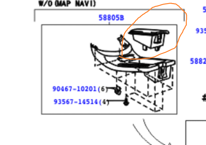

The part you want comes as part of the whole upper centre console cover. Toyota do not offer any spare/repair parts for it.
Thanks Devon! Yes, I have seen this, but I didn't know why there is no part numbers or something.
Is it possible to substitute with something else? e.g a cup holder without lid?
From Toyota there are only a few variations;
Black with & without nav
Ivory with & without nav
Without Nav you get the spring loaded lid covering the cup holder with nav has remote control to operate the pop up screen nav.
