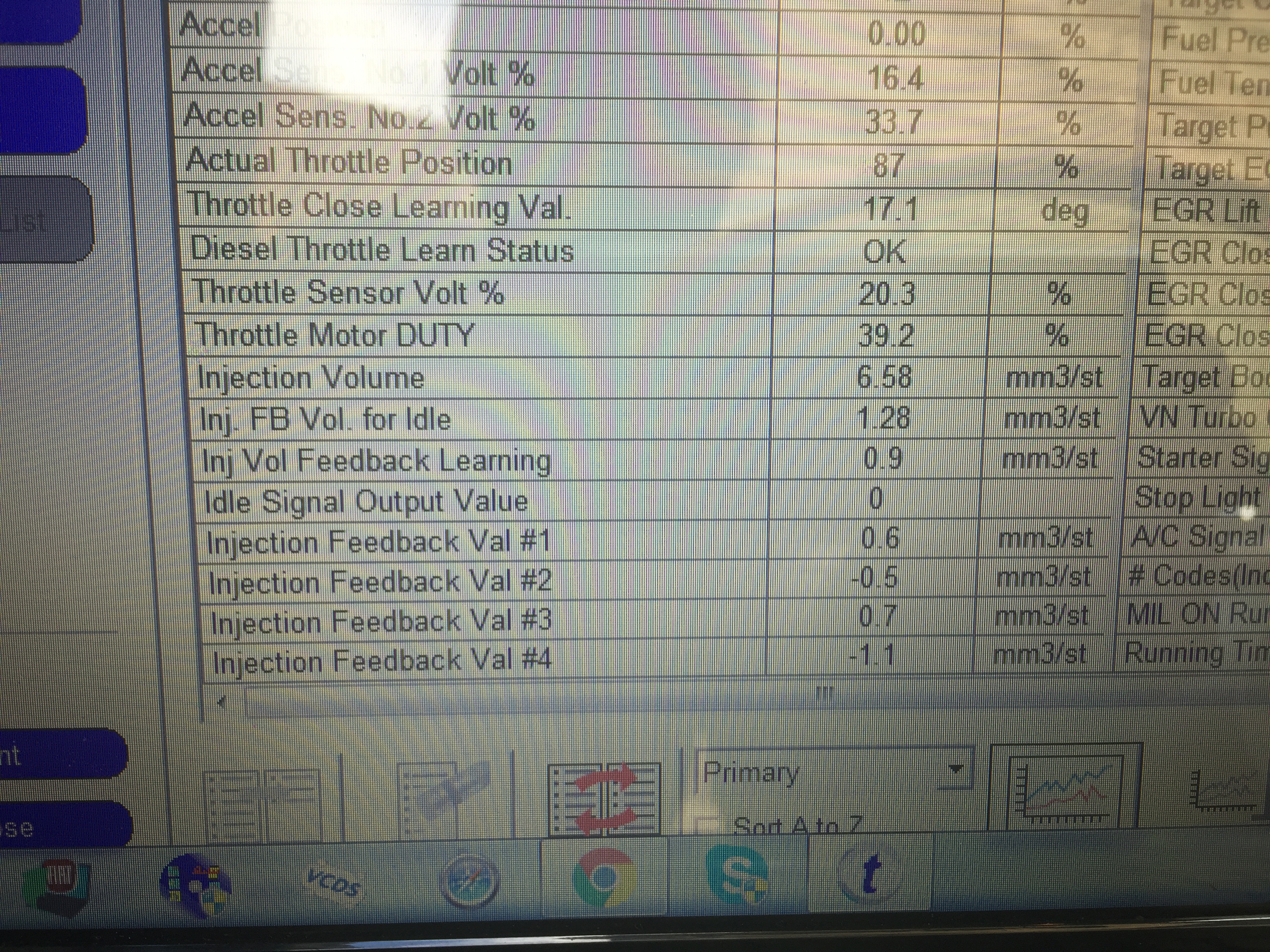

Ok I have had a test run with techstream the injection values stay relatively stable just not sure what they should be!
Before starting the diag' process Toyota's own process says to update to the latest software this is done so as to ensure a software fault is not causing the fault, this will be relatively cheap so do this before replacing more parts!
Individual injector feedback should be within +- 3.0mm3, so appear fine
Inj FB volume for idle should be 3.2 to 10.1 mm³ for the 1AD, so is out of tolerance and Toyotas diag process says fit new style step 2 injectors as a set! do not mix step 1 & step 2 injectors.
inj vol feed back learning should equal to or less than 1.8, so appears fine
Note all the figure above are to be read with the engine warmer than 65 degrees and with no load @ idle e.g AC off, electrics off
So the injectors individualy are injecting ok, the volume is ok but the fb volume is too low? What would cause this? And what does fb mean? Is it flow back? Or feed back? I will run the test again tomorrow with the temperature up to  65 degrees and see what happens.

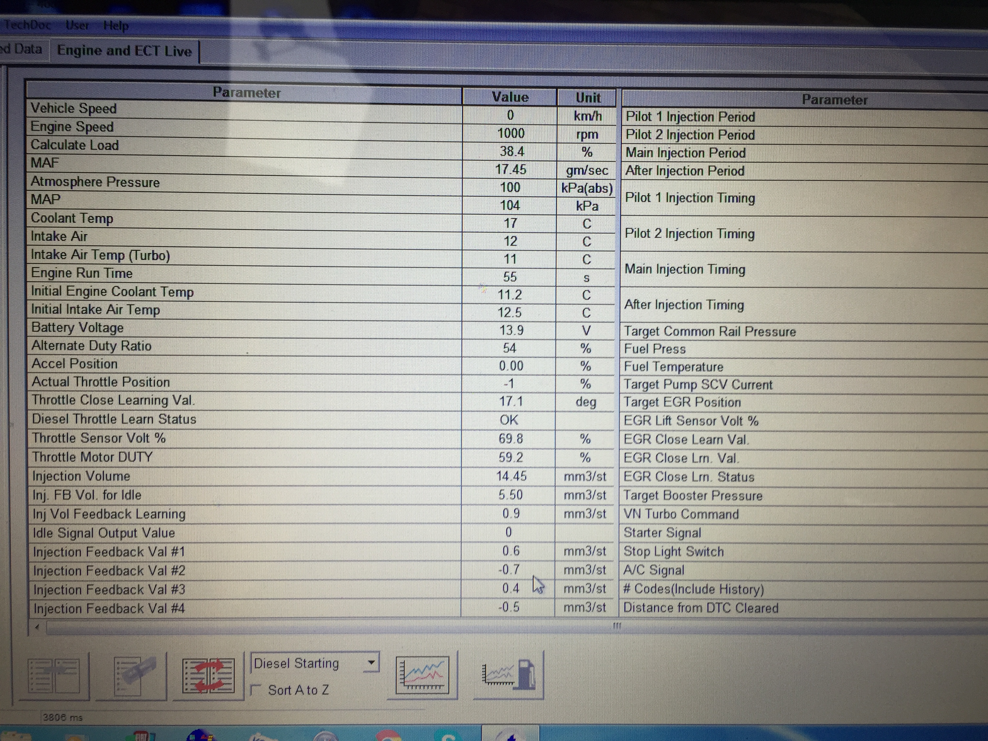

New cold start test attached taken after 10 seconds. I did record the actual start up but it crashed 😬 Note the fb volume for idle...
