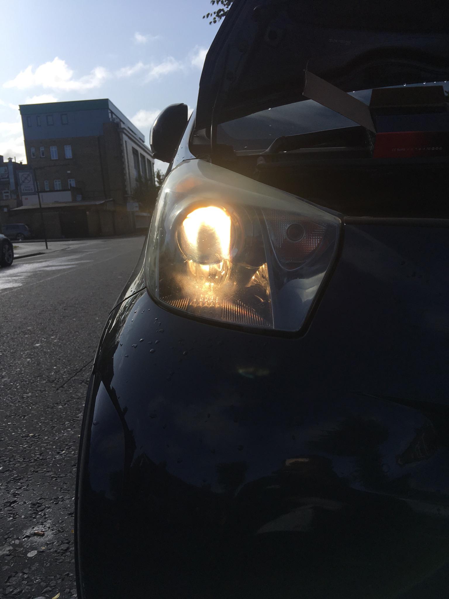

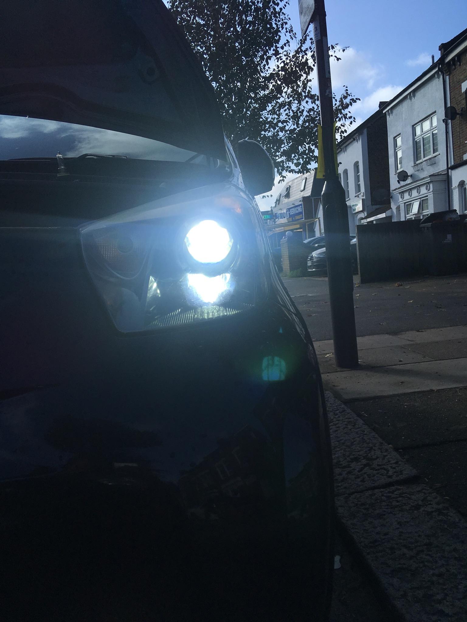

On 1/27/2020 at 7:14 AM, smartiebandit said:
I've just fitted a set of LED halogen replacement bulbs to my wifes' 2010 Toyota IQ and although this has improved the overall brightness, it has just highlighted the fact that the light spread from the projector units is rubbish. The curb side is very well lit, but the road directly in front not so much. the new LED bulbs are a 1:1 size with the HIR2 halogens and are supposedly 10,000 lumens. I looked at many of the reviews on the different makes and opted for the NOVSIGHT 9012 units £40 for the pair.
Can you adjust how the projector units spread the light?
Yes, you properly adjust the projectors by removing the NOVSIGHT LED bulbs and installing them in the nearest rubbish bin, and then installing a pair of proper HIR2/9012 bulbs, from Osram or Philips or GE or another major brand that you like.
The projector is actually excellent. The issue is that the LED bulbs are not a 1:1 size with HIR2 halogens:
Deviations from the actual diameter of the HIR2 filament creates a bad beam pattern and causes the same stuff that you've noticed: light hitting the curb instead of projecting far down the road.
Also, 10,000 lumens is not possible. Current white LED chip technology is at about 100 lumens/watt. "10,000" lumens would imply that these bulbs draw 100 watts, or nearly twice that of the stock HIR2 halogens. Your wiring would be up in smoke by now if they actually drew anything close to 100 watts.
