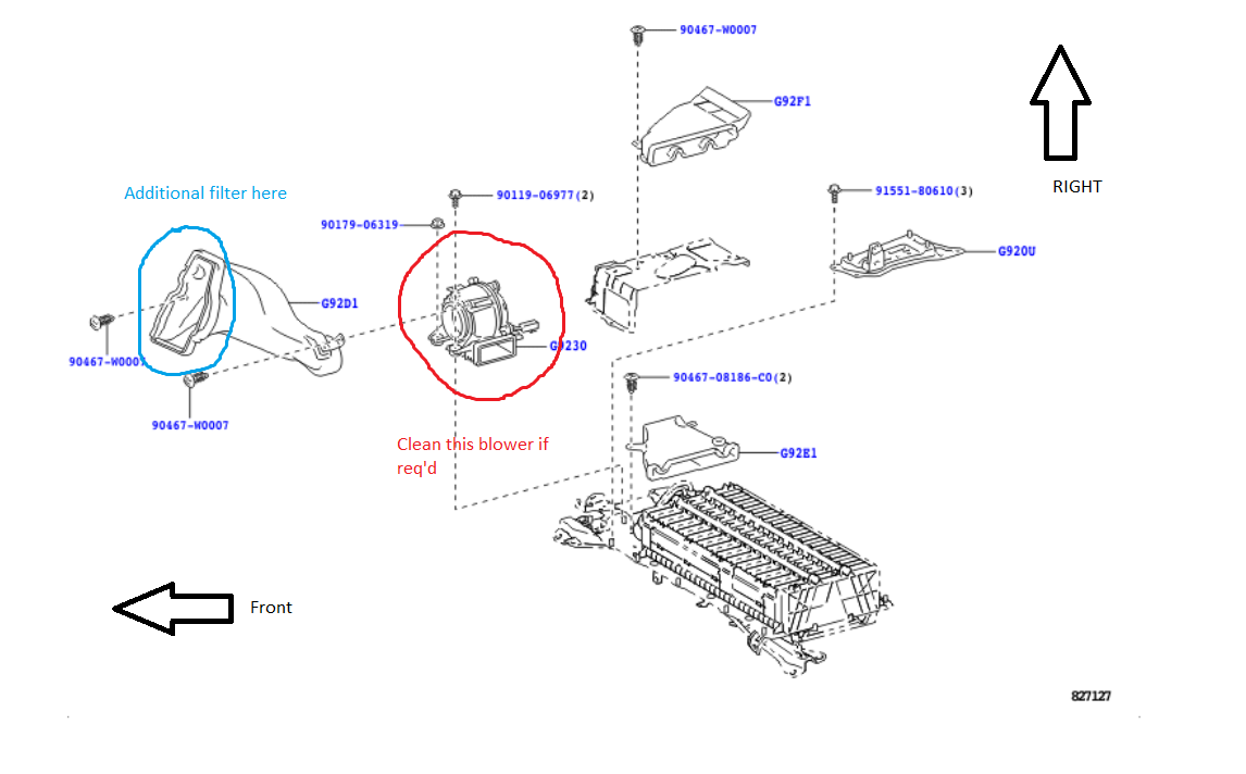

Just in case re; the overheat warning you may wish to check the condition of the Hybrid battery cooler fan as this can clog over time with fluff and lint causing a overheating issue with the Hybrid battery, if the blower is clogged clear it and it may be worth purchasing a filter ( part # G92DH-12020 ) to fit over the air intake to reduce the amount of debris getting into the cooler blower, See picture:
i would suspect the warning is coming on because of a fan failure for the hybrid batteries or blocked vents
