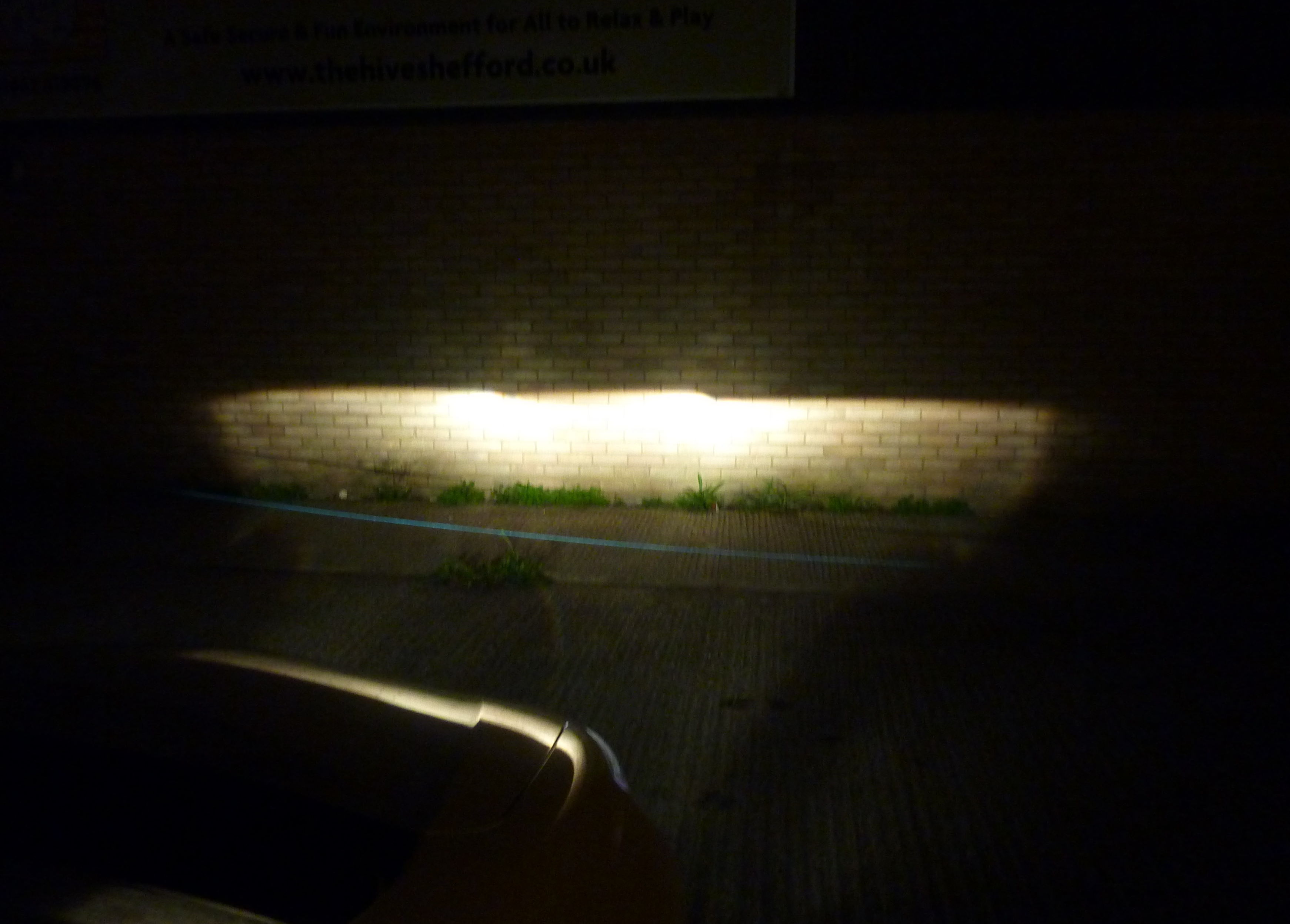

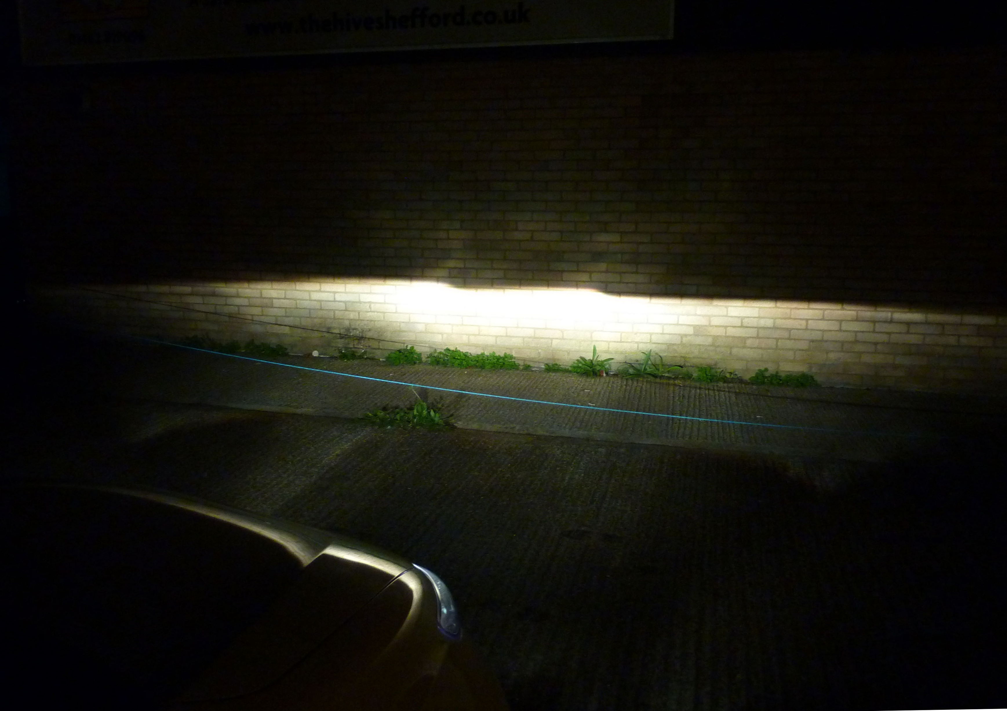

Here are some (not particularly good) shots of an old and (upgraded) new headlamp if any one is interested.
The extra intensity on the new headlamp is probably down to the camera.
I think the bulbs get reused in the new lights.

Exactly! I only mentioned it to underline that the headlamp performance improvement is entirely down to the Shell.
