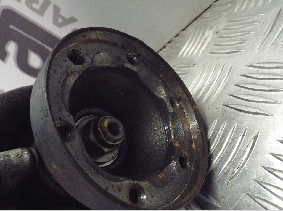

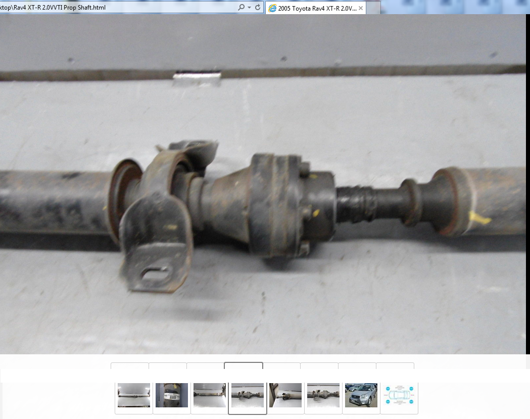

I take it you have removed the whole propshaft?
Remove the six bolts around the drive flange at the rear of the centre bearing (they may well be Torx bolts) and separate the rear half of the drive shaft from the front. It leaves the flange still attached by a large nut.
