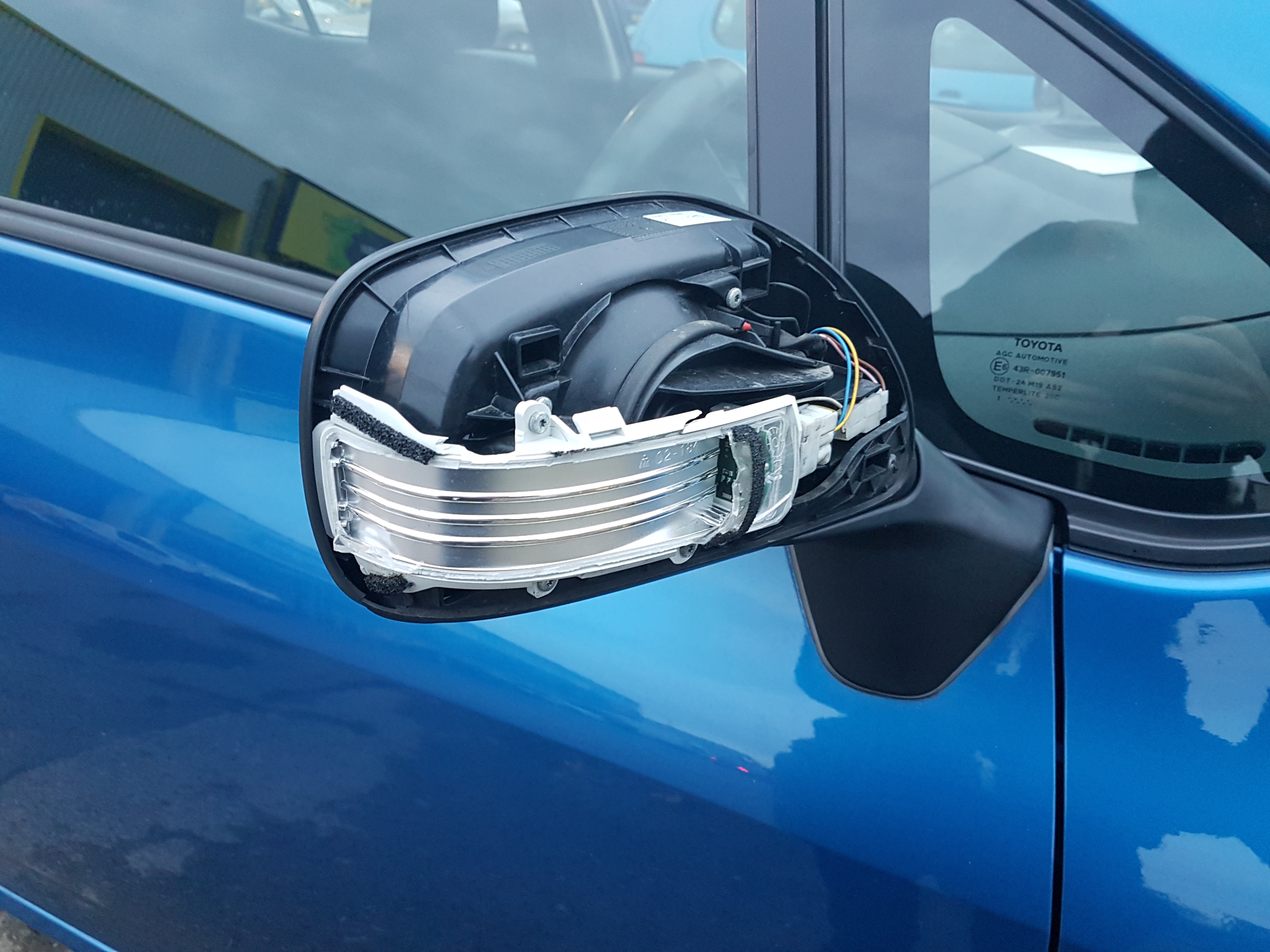

Hello guys , can someone tell me where I can find side mirror cover for my Toyota Auris 2012? please...

Thanks for the information. Have a look on top of the topic. Is on the driver side( right)

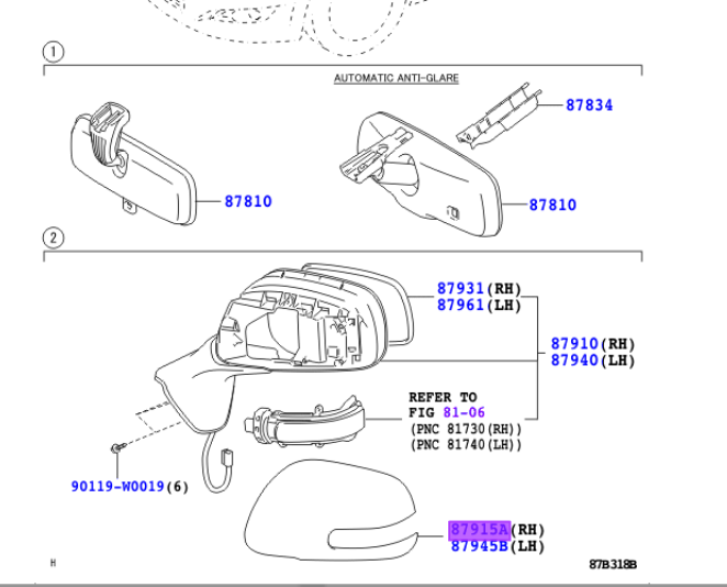

The mirror is available as separate parts and looking at the pic you appear to need:
1x 81730-02110 Indicator lamp
1x 87915-02918 Mirror cover ( primed will need painting )
