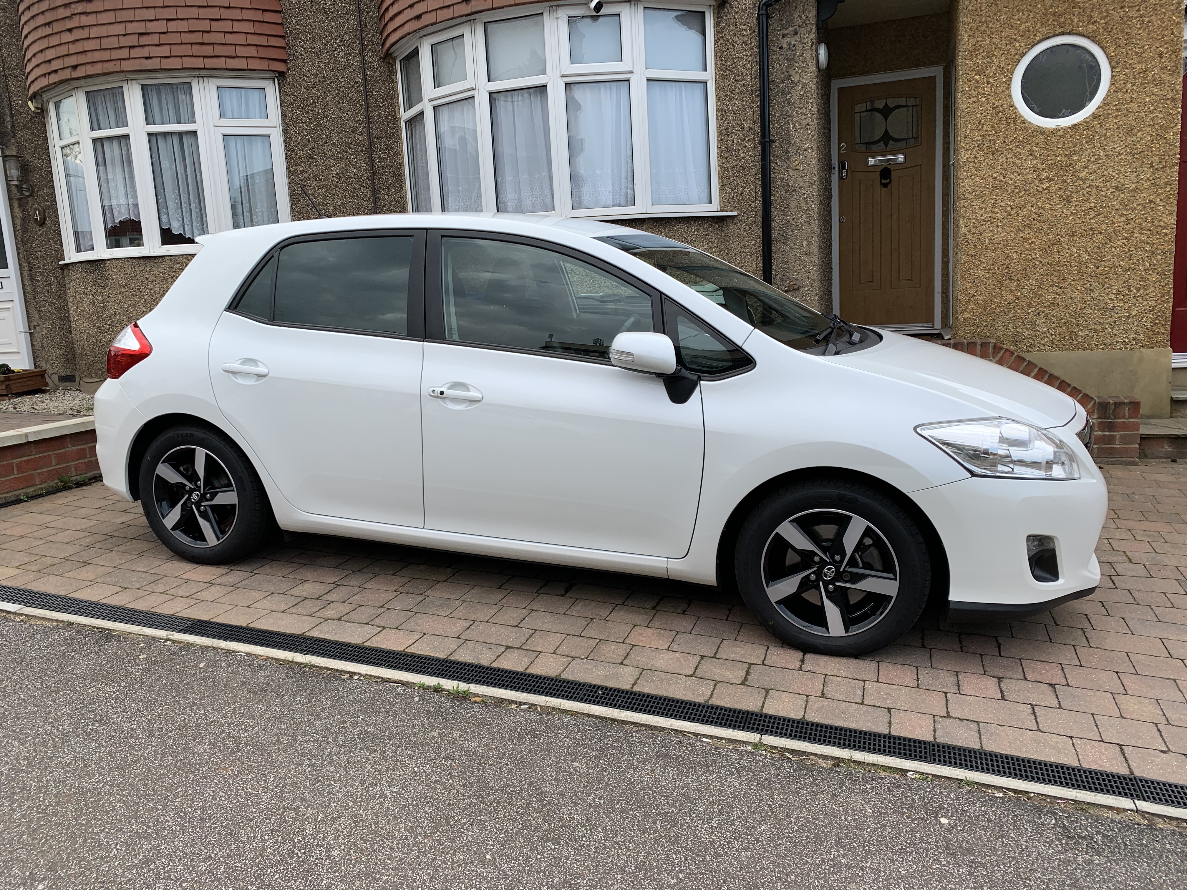

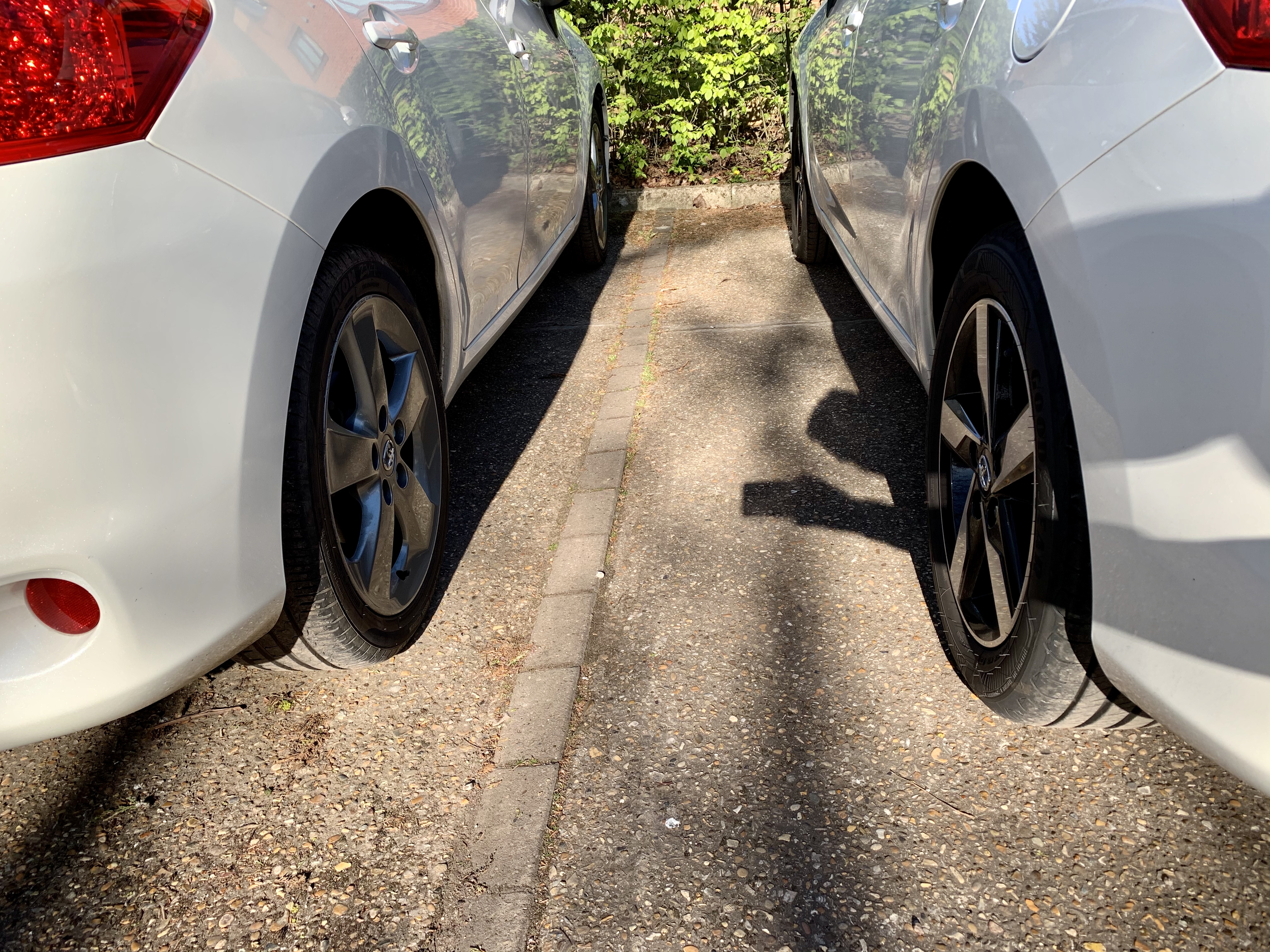

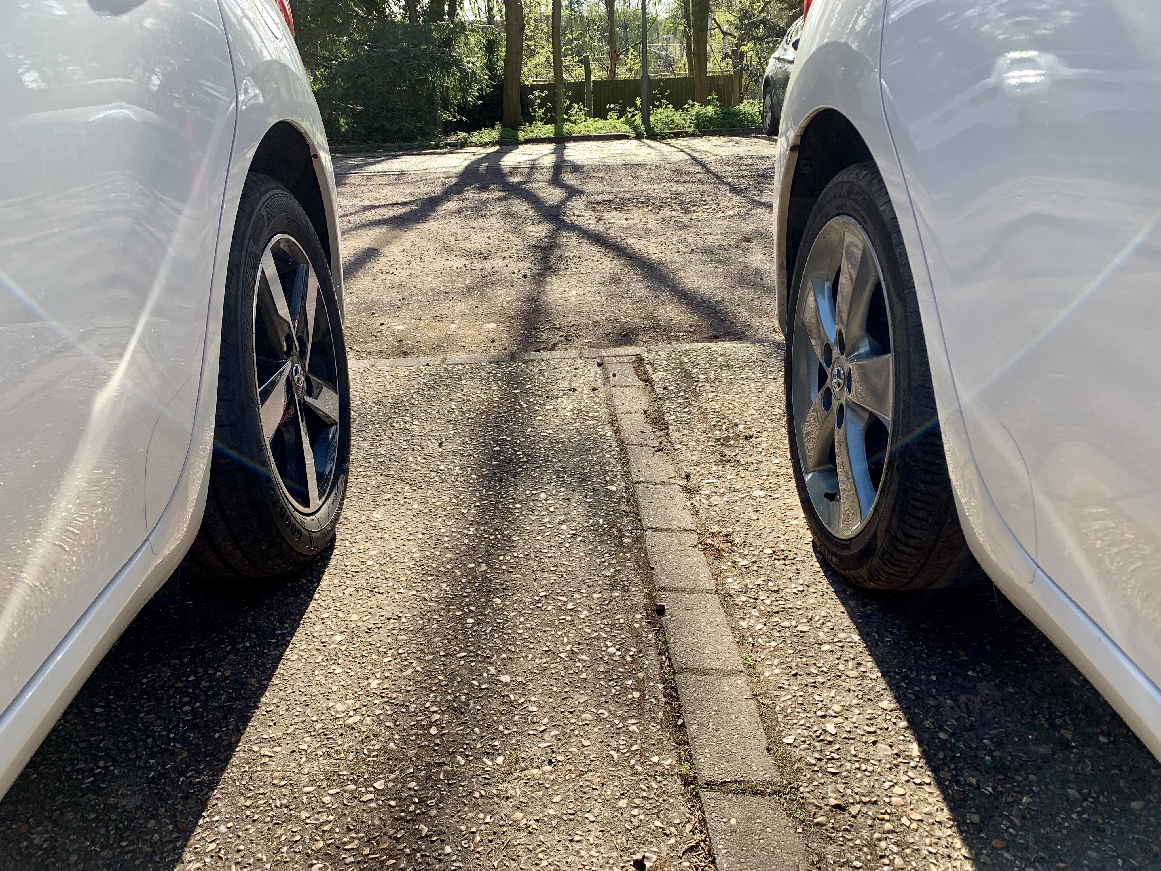

For anyone interested in replacing their 17" wheels with 16" I have now done just that. 2017 Auris Excel Hybrid.
Wheels and tyres secondhand but binned the tyres and fitted New Michelin Primacy 4.  Resprayed the wheels with about four coats and then lacquer.
The valve pressure sensors (already fitted) didn't seem to need any change as the pressures are the same at 2.3bar.
Driving - What I have found is that there seems not to be a lot of difference between the 16" and the 17" other than the "Bangs" with the 17" are now "Thumps" with the 16" and therefore not so jarring. Noise seems to be about the same although I do think the Michelin roar more on rough surfaces but the difference is very slight.  There is, perhaps, slightly more bounce, maybe even roll, with the 16" but overall because of somewhat less "Bang" and a slightly smoother ride I prefer the 16" and for now will stick with them - although I am keeping the 17" in case I change my mind. Certainly on main roads the 16" make for a nicer drive but the side roads round here are often very poor and not level and smooth so the difference is minor on those roads, but again less bang more thump!
My insurance company have no problem with the wheel size change or, for that matter, the Cat cover plate I have fitted and the cat etching as well - NFU Insurance.
Note: You cannot fit 15" on the Excel Hybrid, 16" is the smallest due the the brake size.
Well, now that I have had a chance to drive the car more with the 16" wheels I find there is rather more difference than first thought.  Certainly a more comfortable ride, bit more bouncy perhaps but certainly better for my rather poor back and not so tiring over longer distances.  Potholes are thumps rather than bangs as mentioned before and the car does roll slightly more on corners but overall well worth while.
