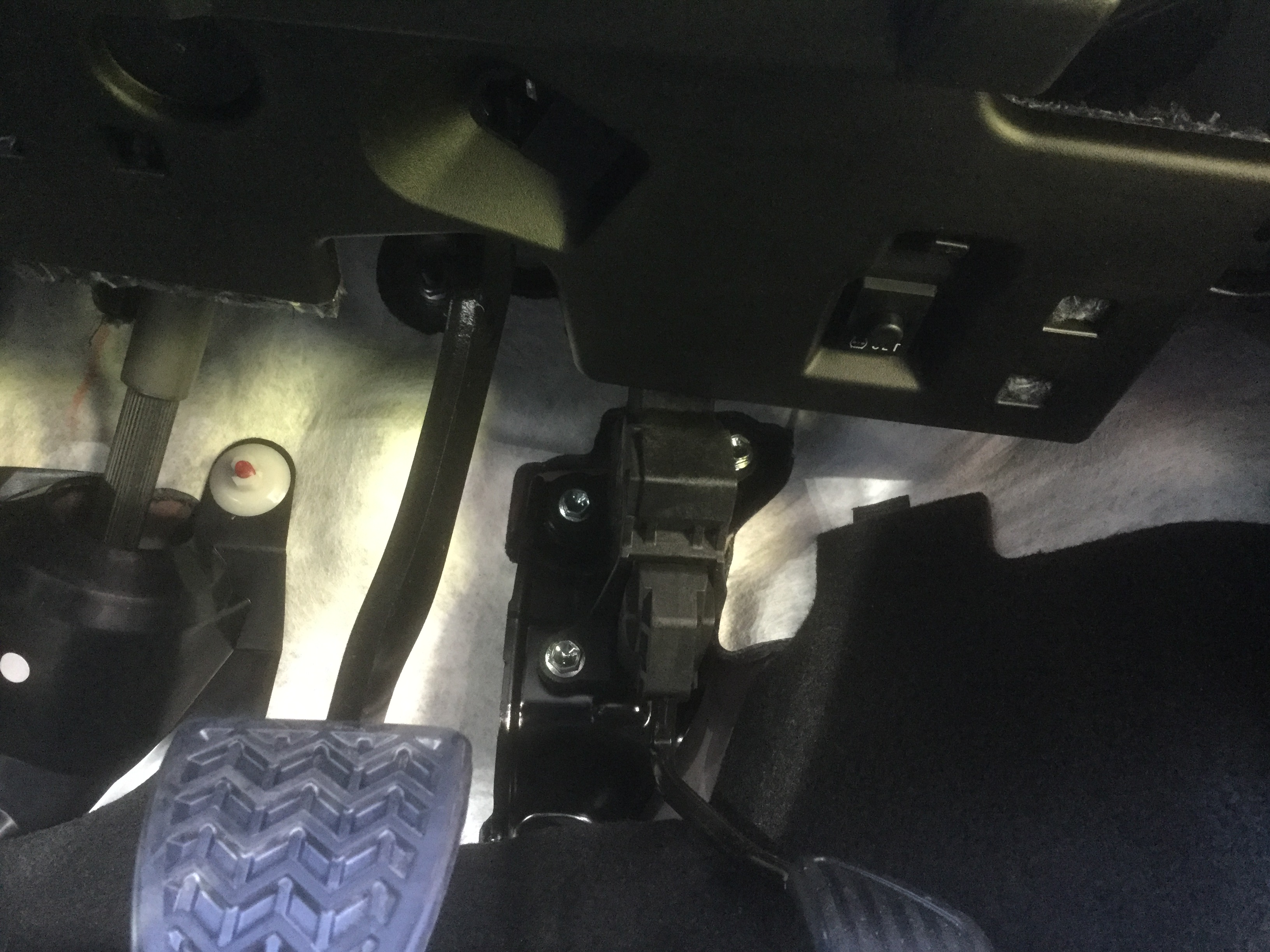

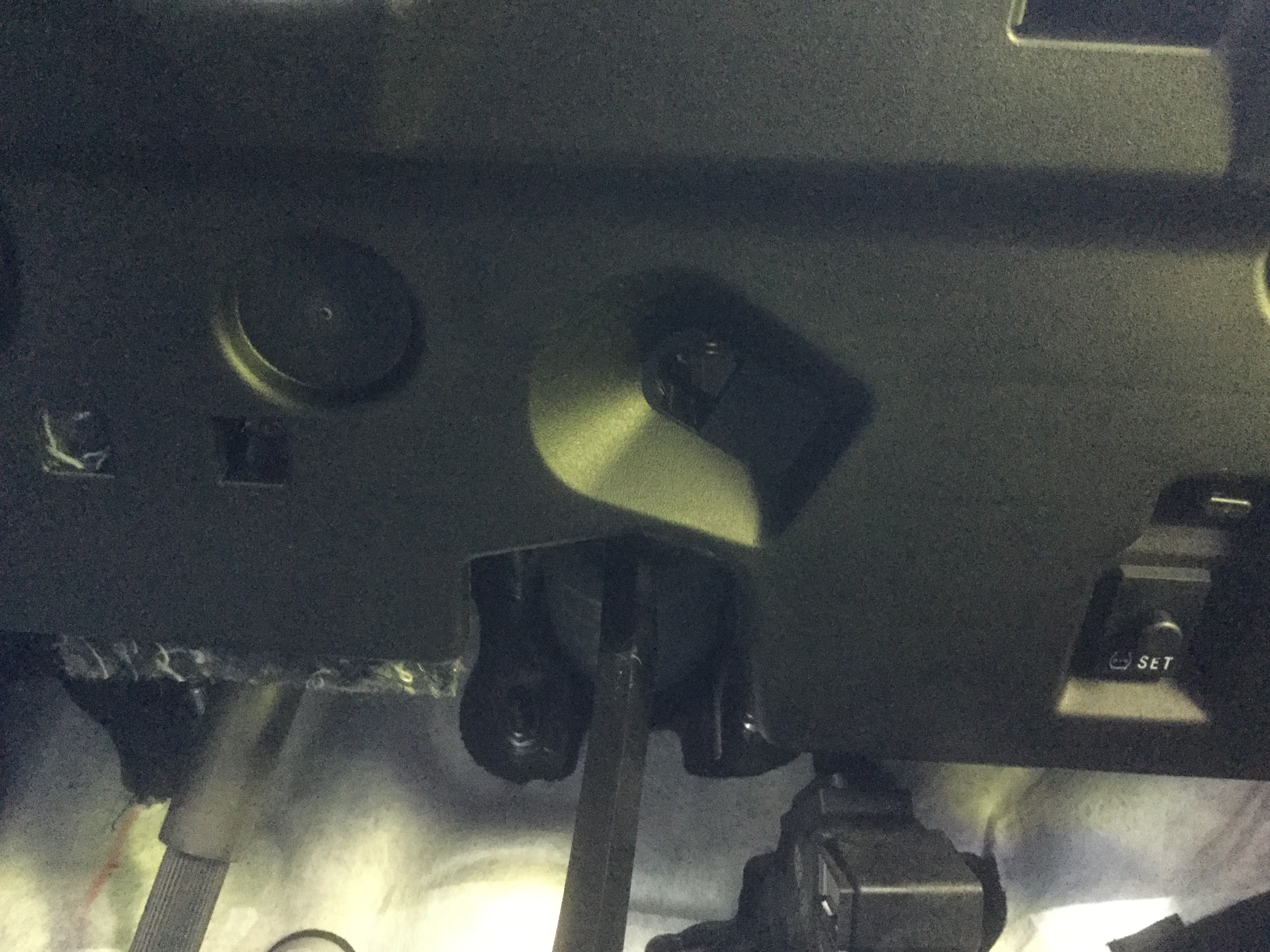

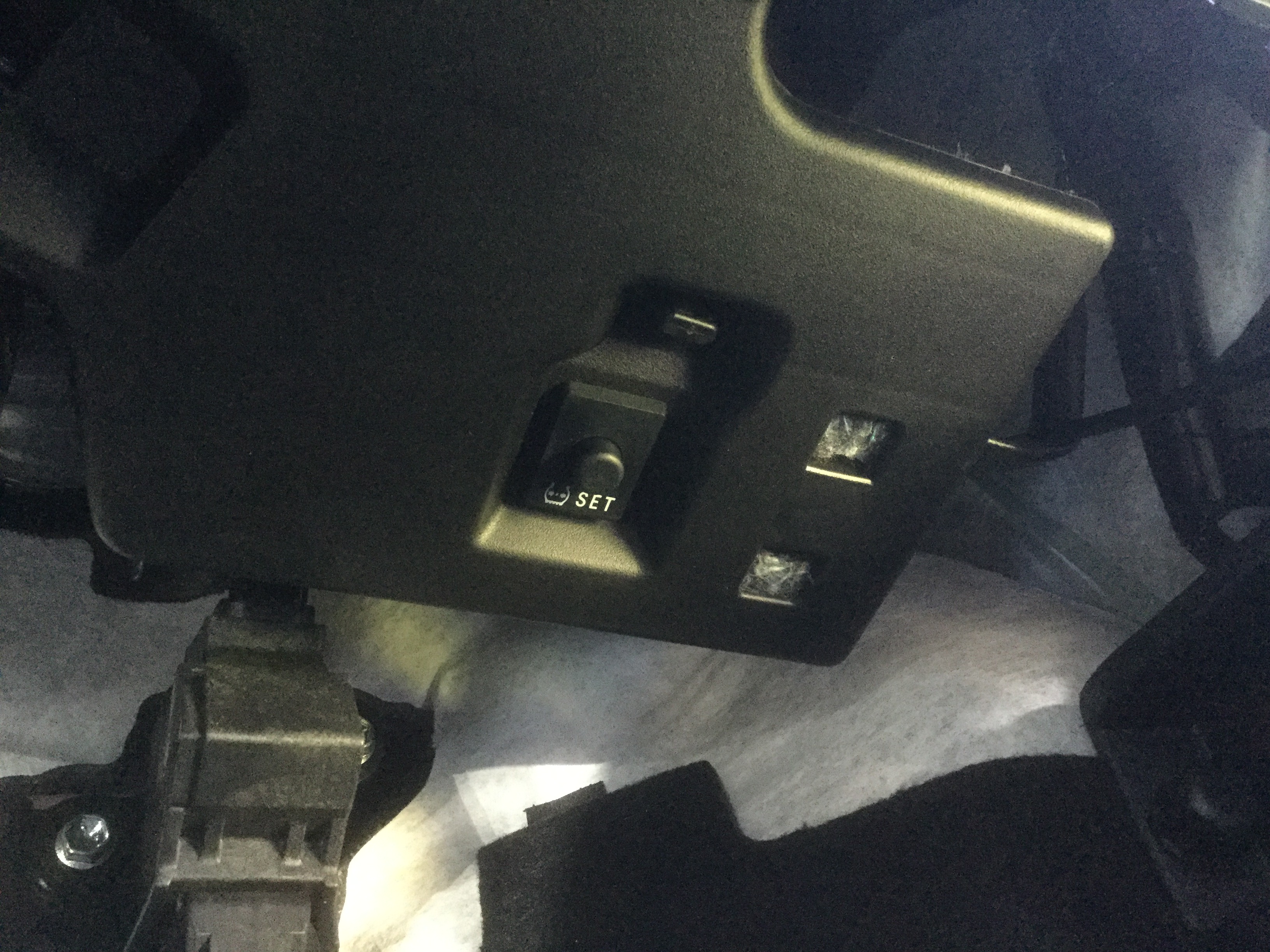

Hope this helps. The button is very difficult to find.
It is on the black plastic cover just above the accelerator pedal.
Jonmartin, thanks for you reply and photos, the reset switch was further under the dash than where I was looking,seems you only need to reset if changing wheels, just increasing to the correct pressure  and the warning light should go out as mine has. Thanks again for reply.

No problem. Glad to be of help. Pretty daft place to put the button, if you ask me.
