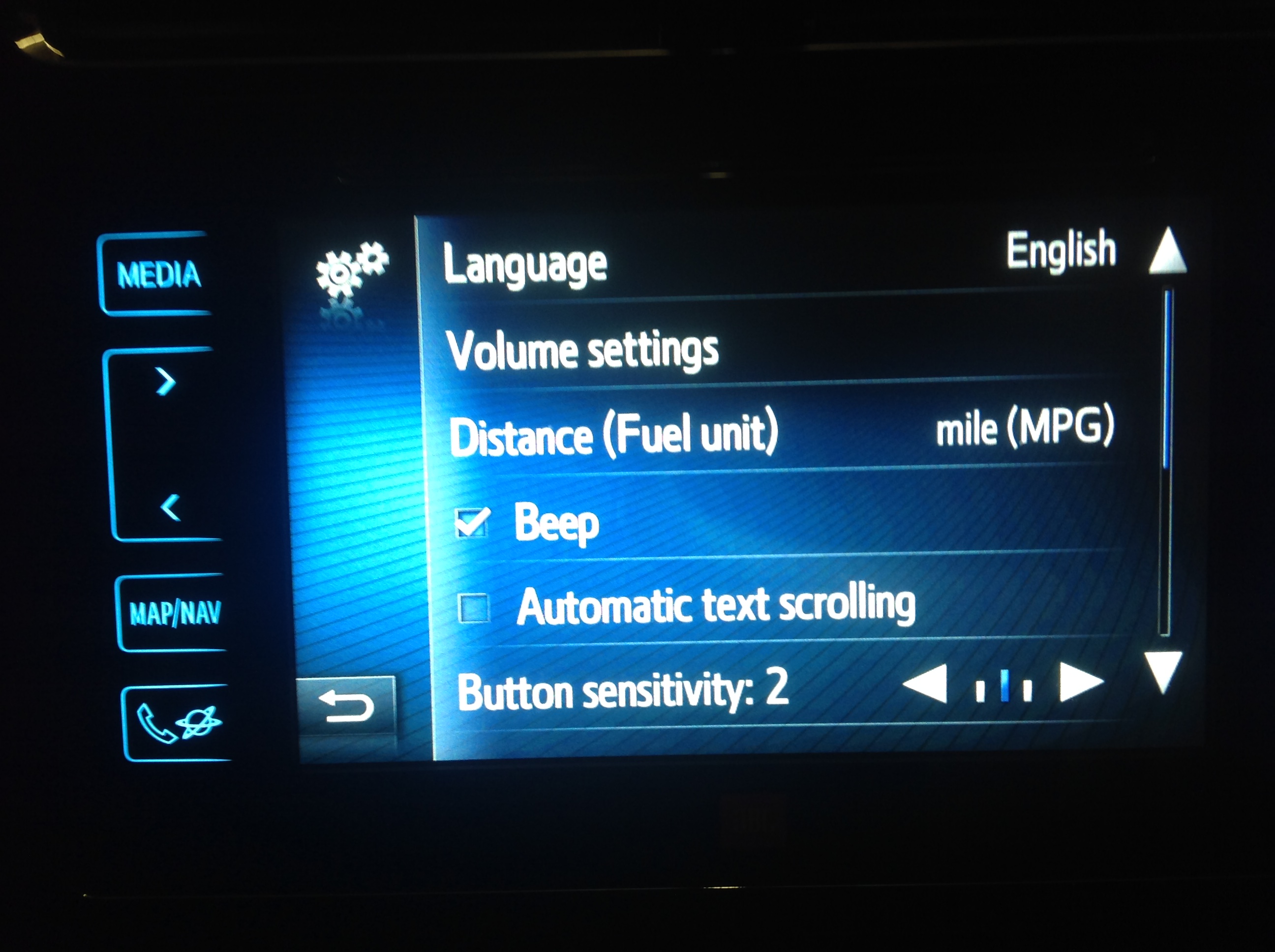

Do what Devon Aygo asked & look at what software your unit is running - if it is T2 with Go it will end in an L (for low) & if Plus it will have H (for high).
Have done what Devon Aygo suggested,
i.e. Press "settings" > "General" > "Software information"
There are two pages available & neither offers any information on software version - please see attached photos below.
So far folks I'm a bit unimpressed since any advice given simply doesn't help with getting this matter sorted other than tell me all the rights Toyota have & that I can't really do anything about it other than moan to Toyota Vantage. Beginning to wonder what kind of car company I'm dealing with since this appears now to be a software problem so why aren't they instructing my local Toyota garage to install the correct version?
Insulting everyone that has taken the time to reply isn't really the way to get help is it?

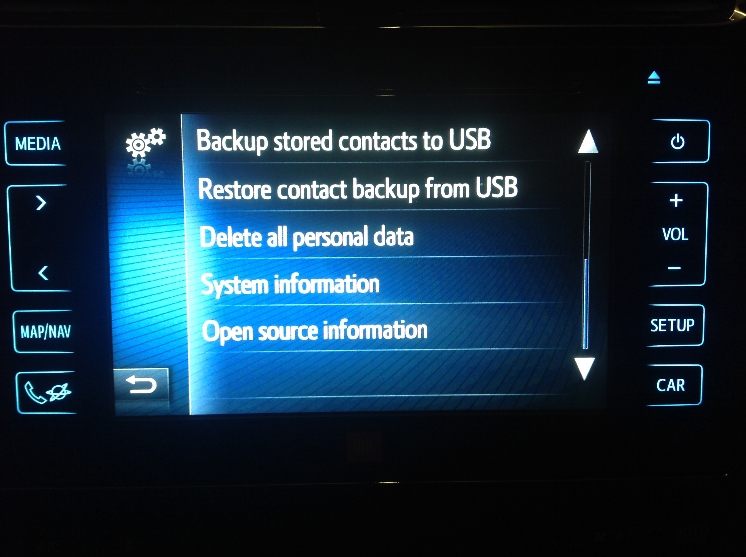

The obvious thing to press in that screen is System information isn't it?
You should now press System Information (not Software Information).

I did press system & would have done so if I was instructed. It told me the Software version: 4.5.0WH, Map ID:2015v2

My apologies i have miss picked the last option, you are on the correct page in your second photo but you need "System information"
