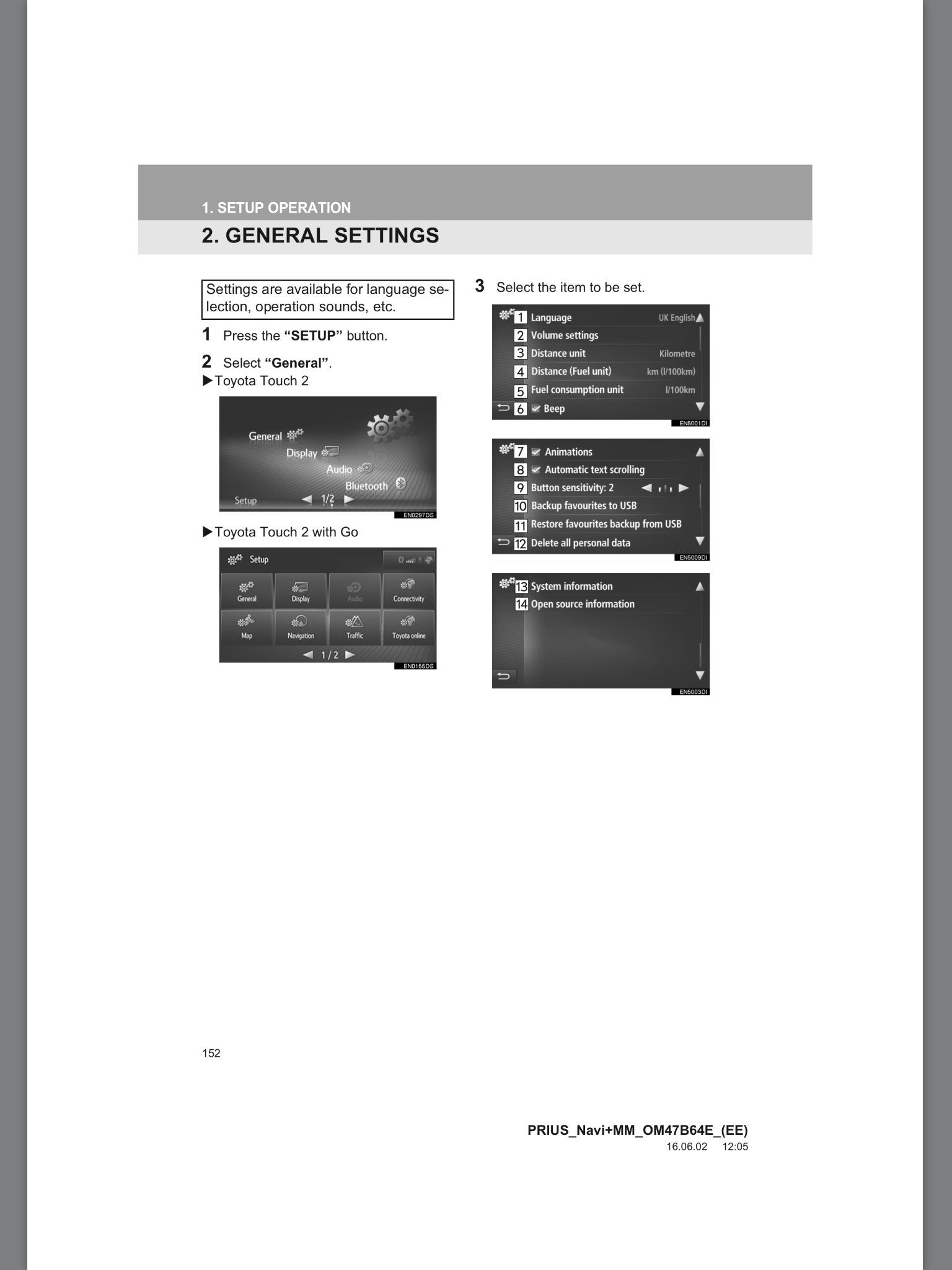

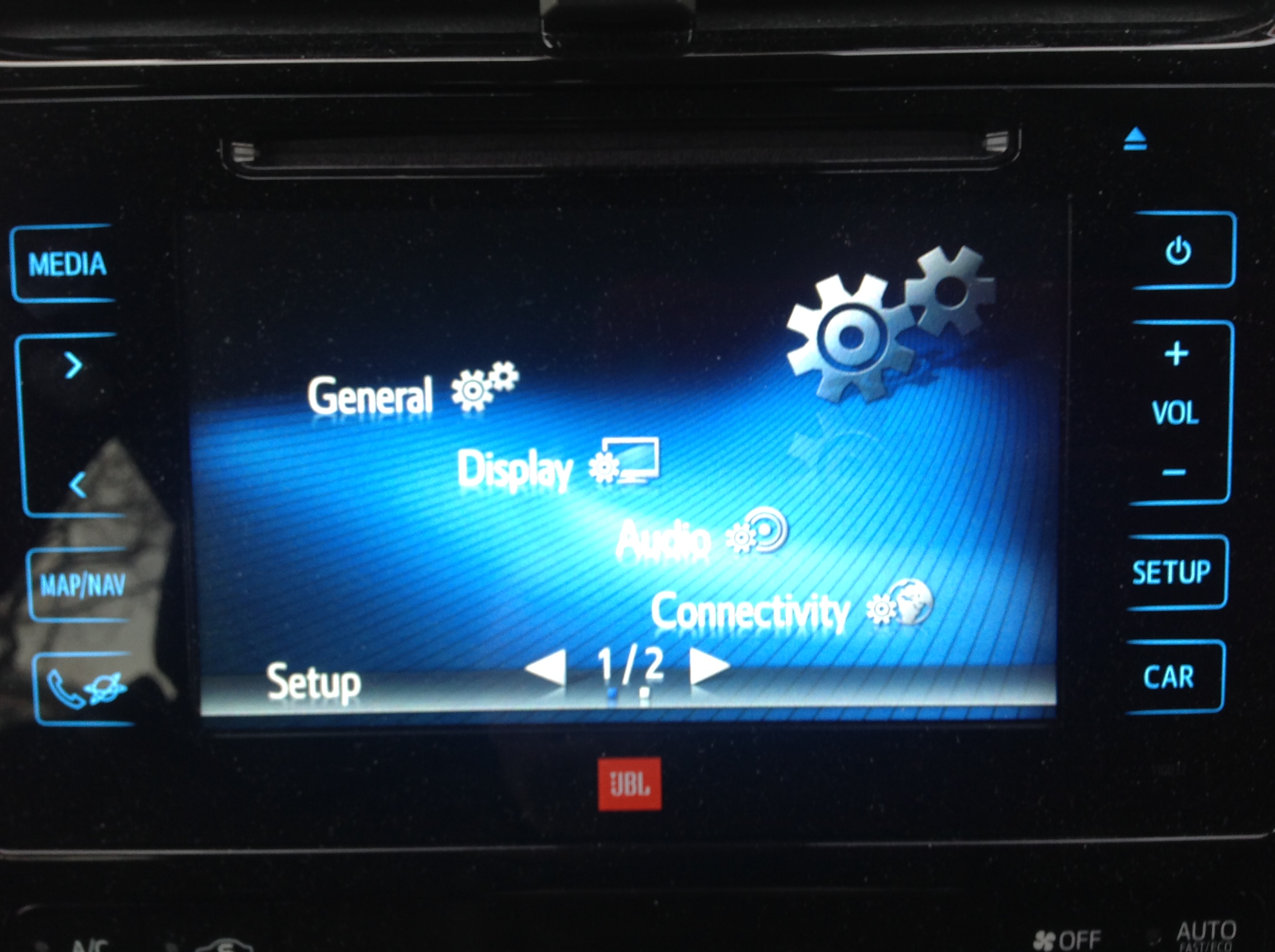

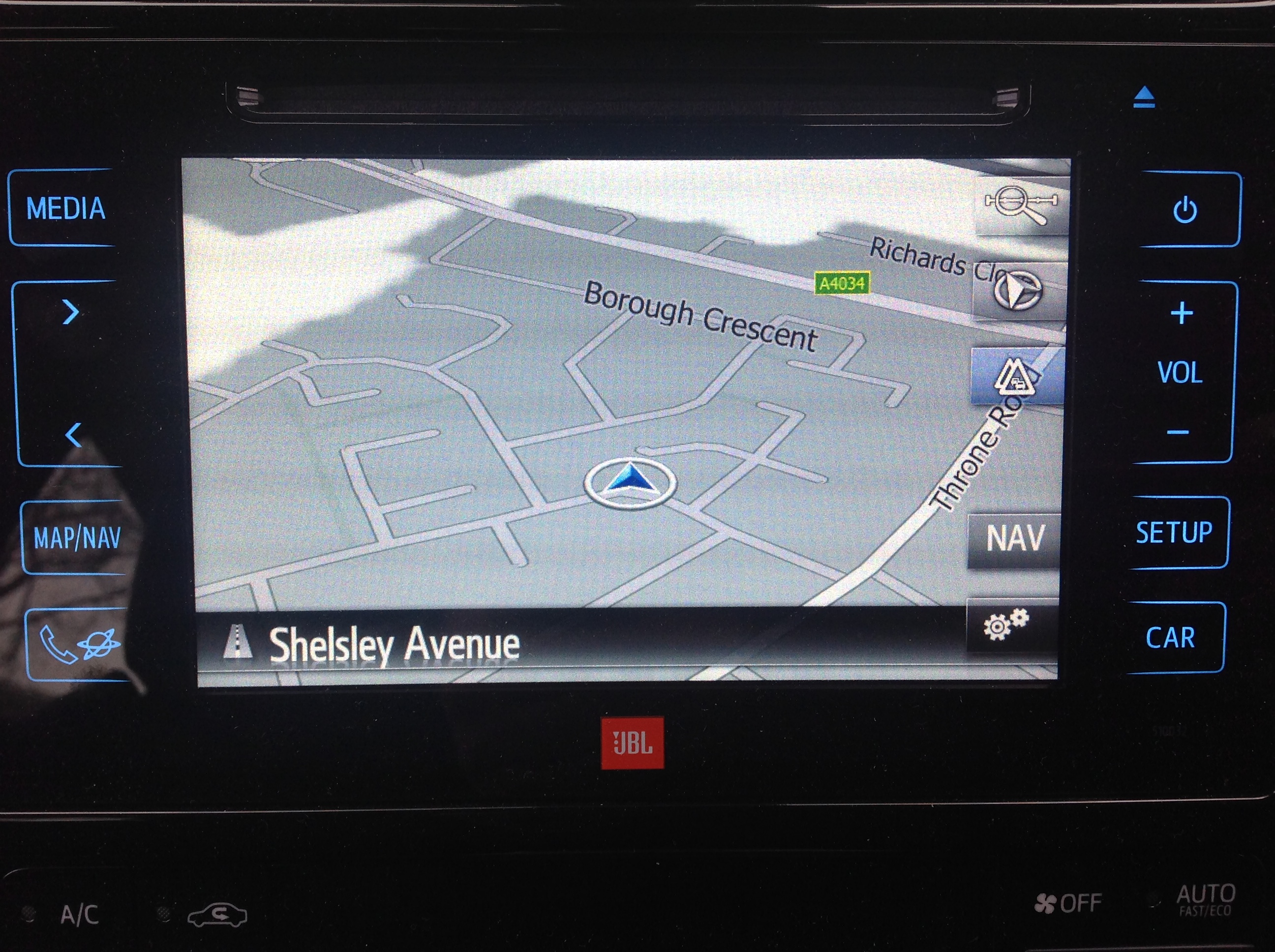

To answer you the buttons on the right hand side of the map view are nothing like those described in the manual. Please see the attached photo. Besides that you will note, there's no arrow allowing me to split the screen as indicated in the manual & something I'd personally find useful. When I select SETUP, yet again I get the screen reffering to the Toyota Touch2, (please see attached photo)  rather than that in the manual that refers to the Toyota Touch2 with Go Plus navigation system as described on page 152 of the online multimedia manual, (please see attached photo).
Dont know if this helps but I have to say that as much as I've loved my last Prius & I like driving this one, if this cannot be resolved  I'm afraid I'll not be buying another Toyota of any sort. If it's a matter of paying to put this right if you know how I can get this resolved I'm happy to do that.

As I said in my last post, my car was registered March, i.e. early 2016, had the old software (same screens as Trev's pictures above), before I updated to 6.7.0WH for free, so I couldn't understand why you said he would have had to pay ?

Well I've finally found time to update my multimedia to 6.8.1WH using the download I made to a USB stick. It took about 30mins after only downloading maps that might be useful, so not too bad. The great news is that the screen looks like that in the manual & I now have the split screen as described. Also the 'buttons' on the right hand side of the screen with the one at the bottom having three dots also all look exactly as the manual. When I think about it, the car should have been updated by the garage before I picked it up on 2nd September, because this update was available then & since I've got the Excel version, it wouldn't have cost them anything anyway. Toyota have been in touch with the garage & they did contact me while I was abroad to take the car in. However thanks to all the brilliant help & advice from a number of you on this forum, who by the way must have great patience with the likes of a numbskull like me, I have been able to solve this irritating problem so I can let them know it's been sorted. Once again thanks for all your help & I sincerely wish all of you a Merry Christmas & a Happy New Year,
