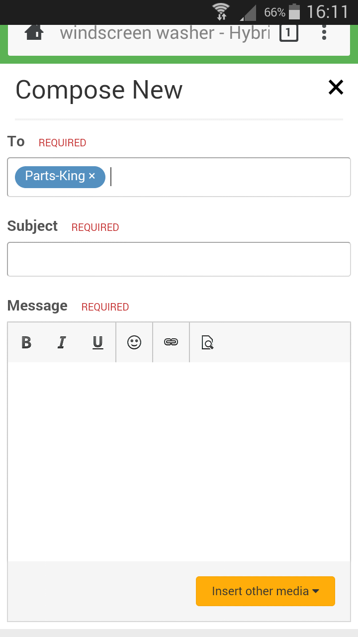

Parts-King is one of our sponsors (Lindop Toyota).  Click on the envelope symbol to the left of your use name at the top right of a page, then 'compose new' and type 'Parts-King' in the 'To' box. Compose your message (include your Toyota model and reg.no.) and send. He'll come back to you with a price.
I searched for Parts-king . All I got was a laundry parts company.
Have you opened your message envelope and clicked to compose a new message?
When you start to type Parts-King, in the "To" field, Parts-King will appear below, just click on it. Screenshot below to help you.
Hope this helps.
