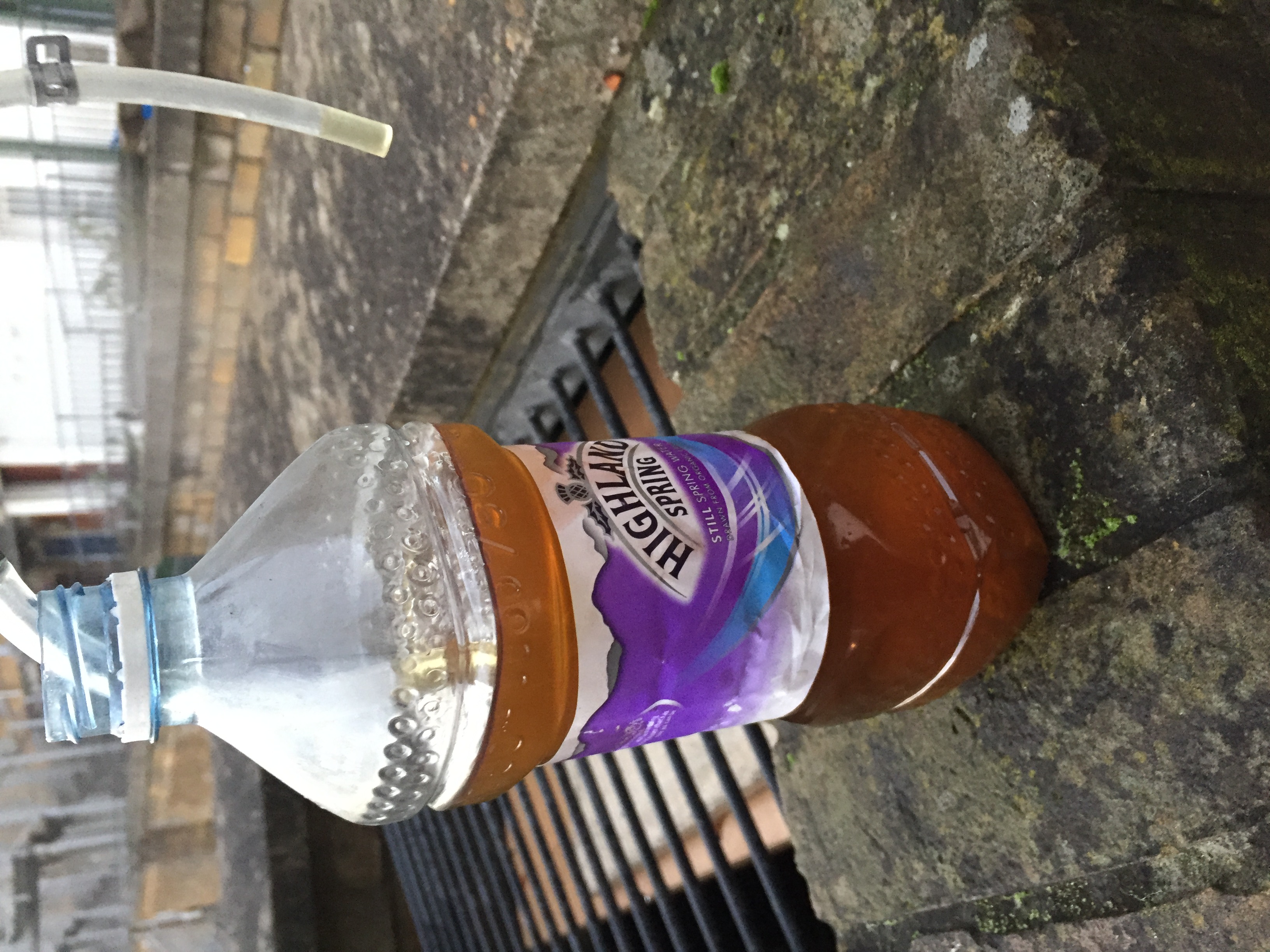

Also attached a picture of the old brake fluid.
Sure looks mucky - any idea when it was last changed , the book says 20k or not longer than 2 years.

I have no idea when it was last changed. It's actually my sisters car and she was complaining about her brakes, so I had a look and saw that they were wearing thin.
I used a none returning valve bleeding kit for bikes and my brother to press on the peddles each time I open and closed it.
