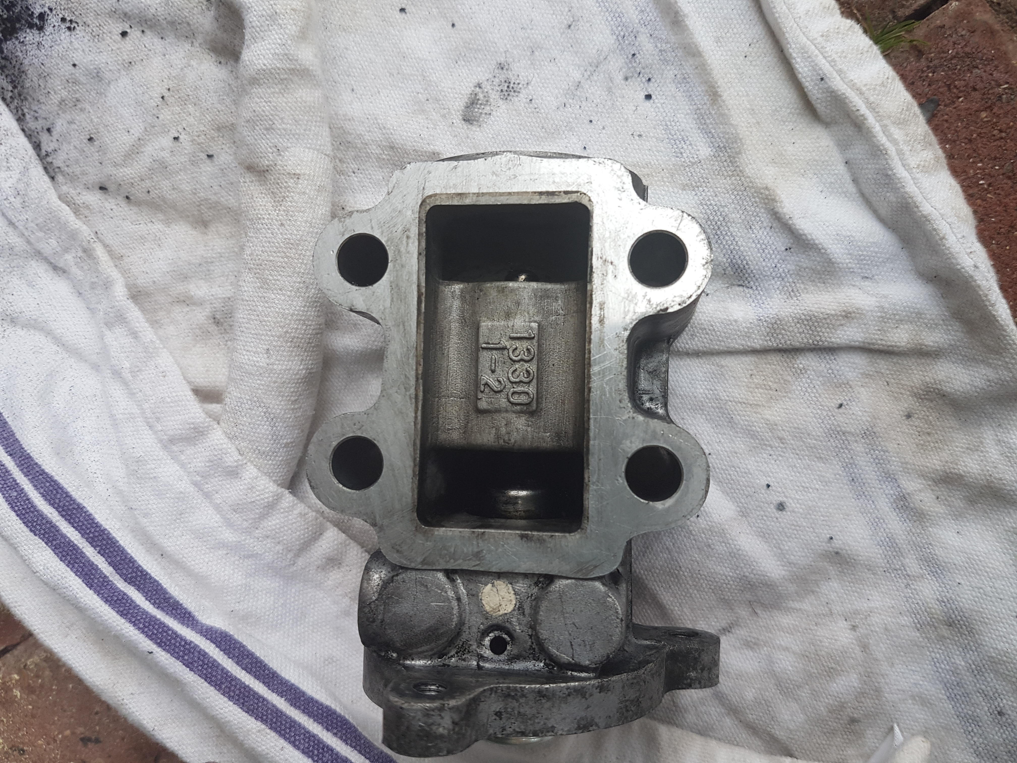

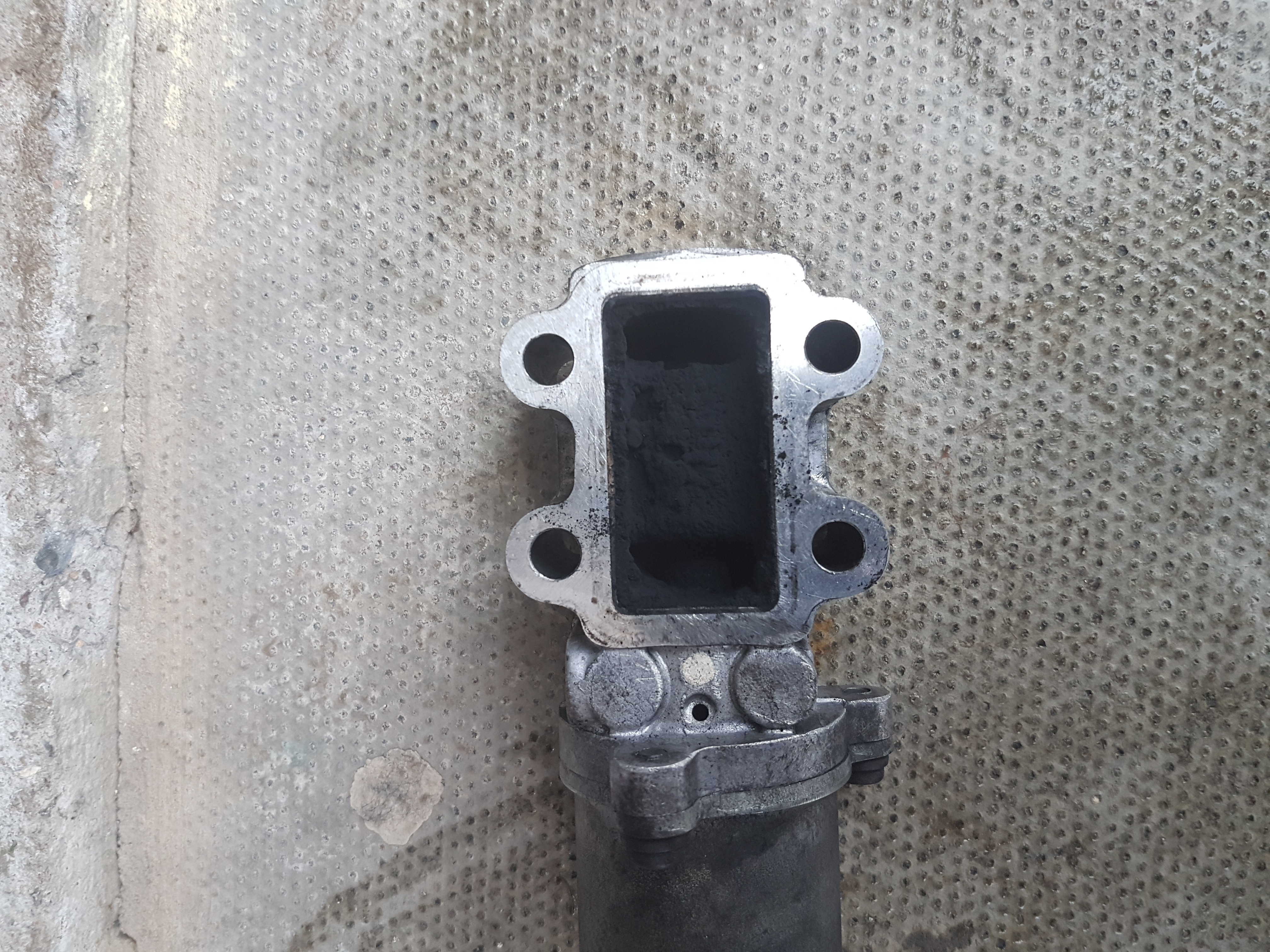

Cheers lads took egr valve off today and cleaned it and put it back together and cleared fault codes and working.
